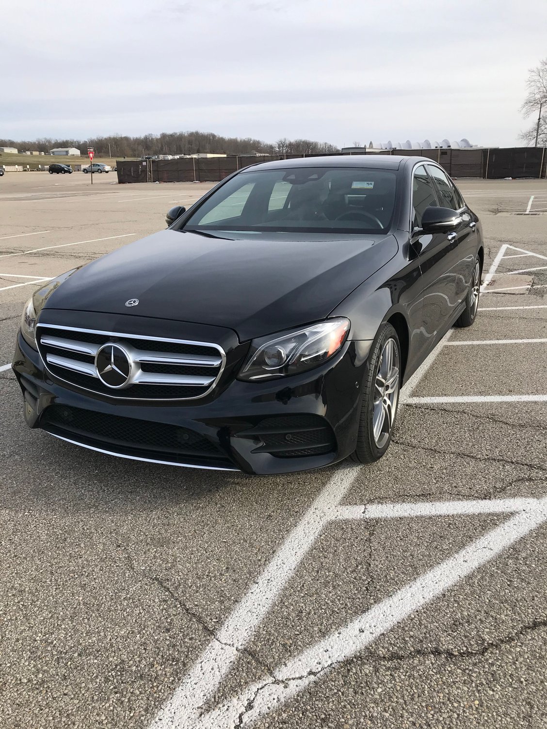

I recently purchased a certified pre-owned 2019 E450 for $70k and it has been in Mercedes service 5 times due to a loud popping sound when I go in reverse. Sometimes it even hesitates to back up. Service dept finally said it’s a known “character flaw” for 2016-2019 E class w/ no fix. So, then it’s defective? I haven’t seen a class-action suit or recall. So I reached out to VP of customer Serv of Mercedes & they said they stand by what service dept says. Is this a joke?? I worked hard to get my dream car & to be treated like this is not acceptable. Stand by your motto “the best or nothing’! Has anyone else had this issue??
