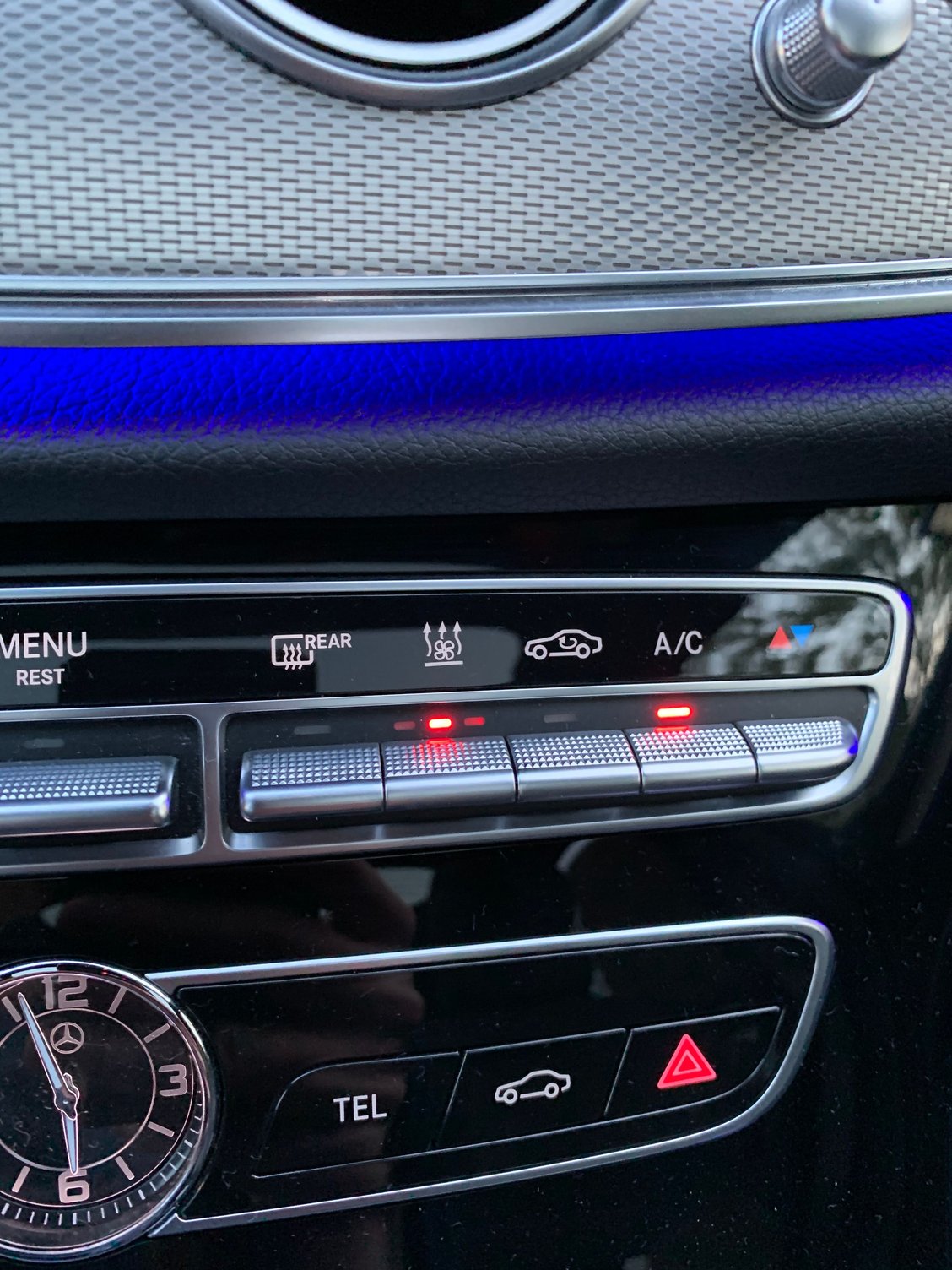

Hello dear friends.
Why does this button light up every time I turn on the car? Then after about 10 minutes of driving, it goes out.
It's never been on before.
I read that it is heat for the cabin.
But I have not turned it on.
And when I come, it's still cold in the cabin.
What is its function actually?
Because it's not something I turn on myself.

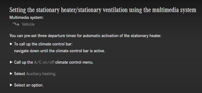

i don't have this but i googled it and it seems to be this:
https://moba.i.daimler.com/markets/e...a31-en-GB.html
however if i understand correctly, if it's on when you enter the car, it means that the heating has been programmed (?)
see also
https://moba.i.daimler.com/markets/e...a97-en-GB.html

That is the Auxilary/Parking heater, you can start it by pushing the button or programing a time in the menu the remote (accessorie) or by the Me-app on your phone.
It starts automaticly in low temperatures to heat the car/cabin quicker.

Yes I have understood that it is parking heaters.
But what I find strange is that it always lights up when I start the car. Eventhough I myself have not put it on.
Should it do that?
I do not want it to drain the battery.

Yes I have.
I have no timer on in the cars command nor in my mercedes me app.
It is disable.
I really do not understand why the button is lighting up every time I turn on the car.
Here in Sweden it is currently 7 degrees.
/Steven.
So you mean it starts automatically even if I have not turned it on.
Because I have it disabled and have no timer set.
Just think it's weird that it should be on every time I turn on the car, because then the fans are already on when I drive away. So whats the point? It will just drain the battery?

Yes! Jag tror den starar för att värma upp både motorn och kupen snabbare. Min började också starta typ förra veckan nu när det blivit kyligare!
Har du en diesel så behövs den också då sådana avger mindre spillvärme.
Den ska inte starta om batteriet är dåligt och bilen varnar då också.
Annars för du åka på reserven så startar den inte

Ja precis!
Den har nu börjat att lysa varje gång jag startar bilen för att sedan efter ca 10 minuters körning försvinna.
Det jag tycker är konstigt och jag undrar över vad är vad den har för funktion då? Bilen är ju redan igång och blir varm av fläktarna. Och ja jag har en diesel 😊
Så du menar att den börjar lysa hos dig också? Varje gång du tänder bilen när det är kallt? För att sedan släckas?

So your question may be answered and makes sense coinciding with colder temperatures, easily confirmed when you’re in for service soon.
