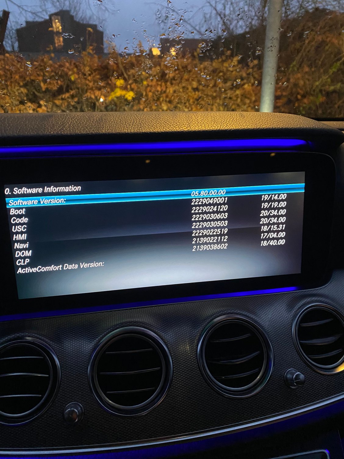

I have software version 05.80.00.00 its the newest I could get per 11th of december 2020
my car is from May 2016

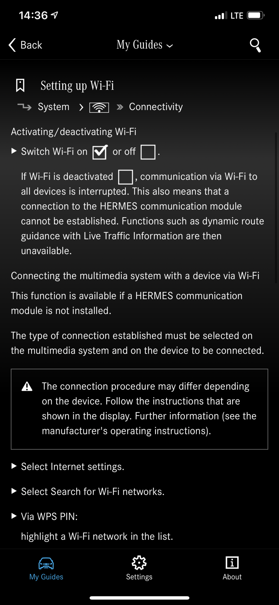

That is not true (see picture)
The function is available when a hermes modul is not installed
and I can see my wifi network via comand

OK, Canadian cars wi-fi must be quite different than US models. See attached for Hermes module functionality.

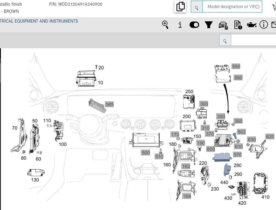

Not familiar with Canadian vehicles but comparable Canadian VIN WDDZF4KB7HA240900 lists codes 14U Smartphone integration, 16U Apple Carplay smartphone integration, 17U Android Auto smartphone integration, 274 Telephone aerial yet EPC shows no Telematics unit (500 grayed out). If need be owner’s & COMAND manuals are available here: https://www.mercedes-benz.ca maybe a call or visit to local dealer for free assistance may help.
