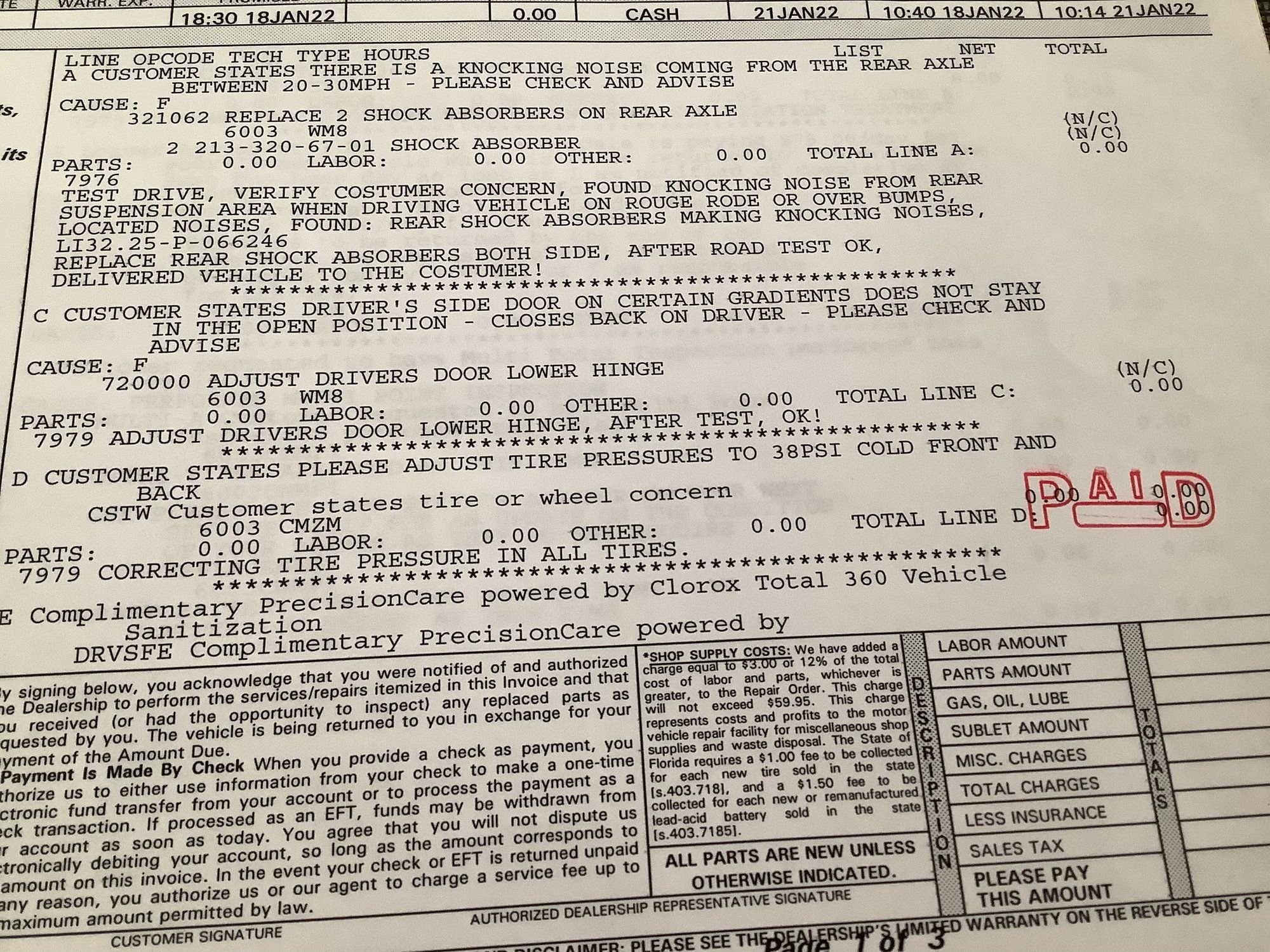

Had same annoying noise from the right rear axle on my -450 Wagon.
The dealer replaced both rear shocks today under warranty. 90% of the noise is gone, but I can hear a faint clunk on rough roads still.
Decided to live with it however.

Do you have the tech bulletin addressing this problem?
If not it is on the invoice after "knocking noises"
