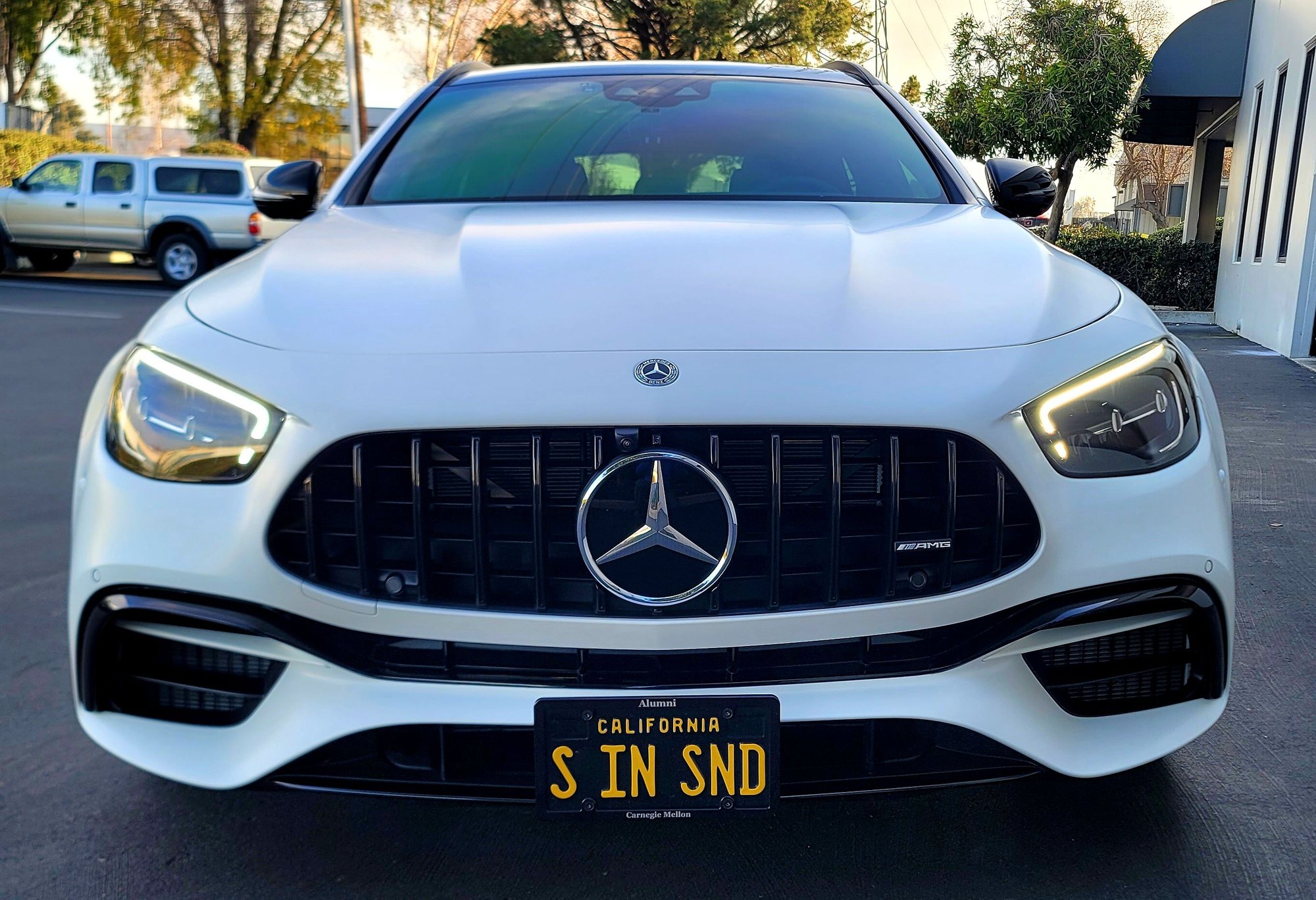

multibeam headlight retrofit possible?
Hi all, I recently purchased a 2021 E63 wagon, it wasn't my own order and came with static headlights.
my previous car was a 2014 e63 wagon and had the dynamic headlights.
i really miss the pattern and movement of the old car.
is it possible to purchase 2021 multibeam lights and retrofit them onto the car? is it a basic install and recode? or something much more complicated or even impossible?
if it's possible are there ant vendors out there that caters to this?
thanks in advance!
