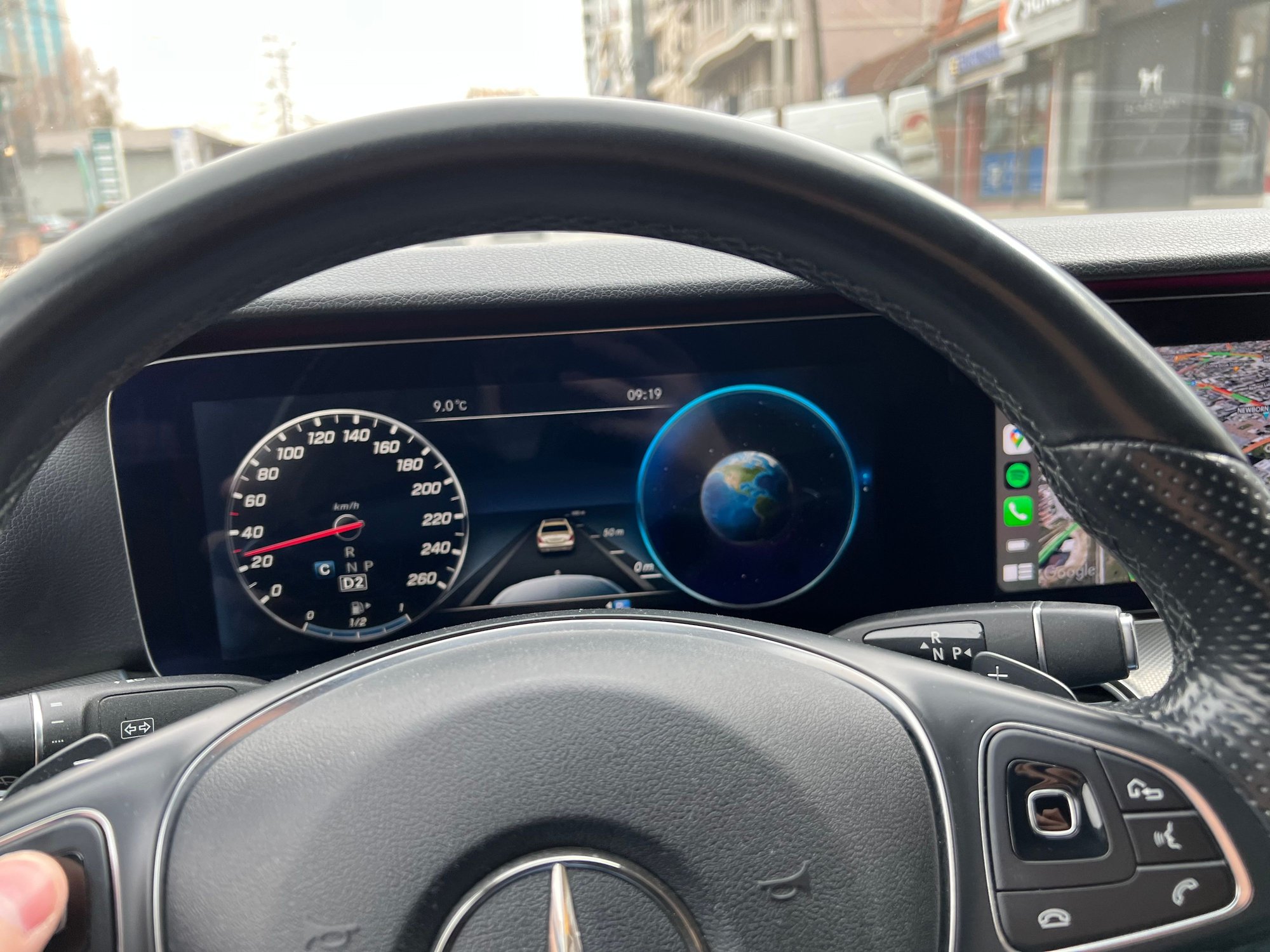

Old Mar 16, 2022 | 04:18 AM
Mbnex's Avatar
Joined: Mar 2022
Posts: 6
W213 2017
This might be because it's the concept they showed at CES and I'm not familiar with the older steering wheel, but you do have the touchpads on the steering wheel, right? The way it works now with the new steering wheel is you swipe right twice to focus on the right gauge and then swipe up/down to change the view. Try that. When I do it in my 2019 C63 there are 4 or 5 red dots that show up on the right to indicate the different views I can cycle through.
Yes I do have touch pads, see attached video

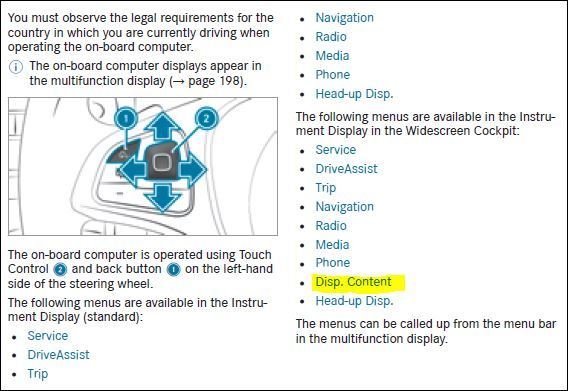

Old Mar 16, 2022 | 10:55 AM
konigstiger's Avatar
Posts: 15,901
Likes: 4,632
From: North Scottsdale, AZ
'71 Pinto
Old Mar 16, 2022 | 11:28 AM
Mbnex's Avatar
Joined: Mar 2022
Posts: 6
W213 2017
Somehow I do not have this Disp. content.. weird
I see no video, just a screenshot, but it looks like you can cycle through different displays for the right side, but looks like there are only two based on the blue dots on the right. Something doesn't seem right with your car.
Old Mar 16, 2022 | 12:39 PM
Mbnex's Avatar
Joined: Mar 2022
Posts: 6
W213 2017
Yeah when I cycle I just get other options, no RPMs Sorry meant image

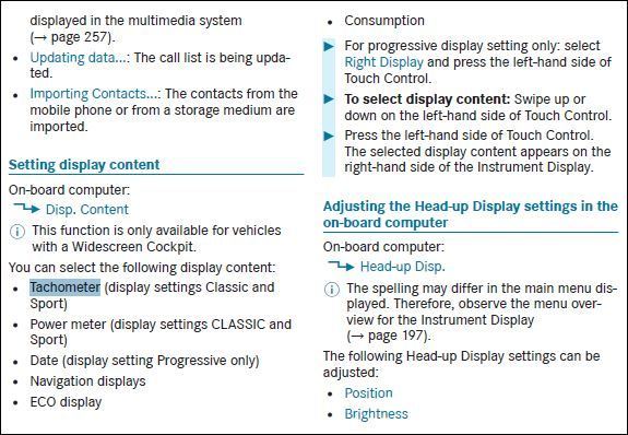

Old Mar 16, 2022 | 01:53 PM
Posts: 15,901
Likes: 4,632
'71 Pinto
VIN?
