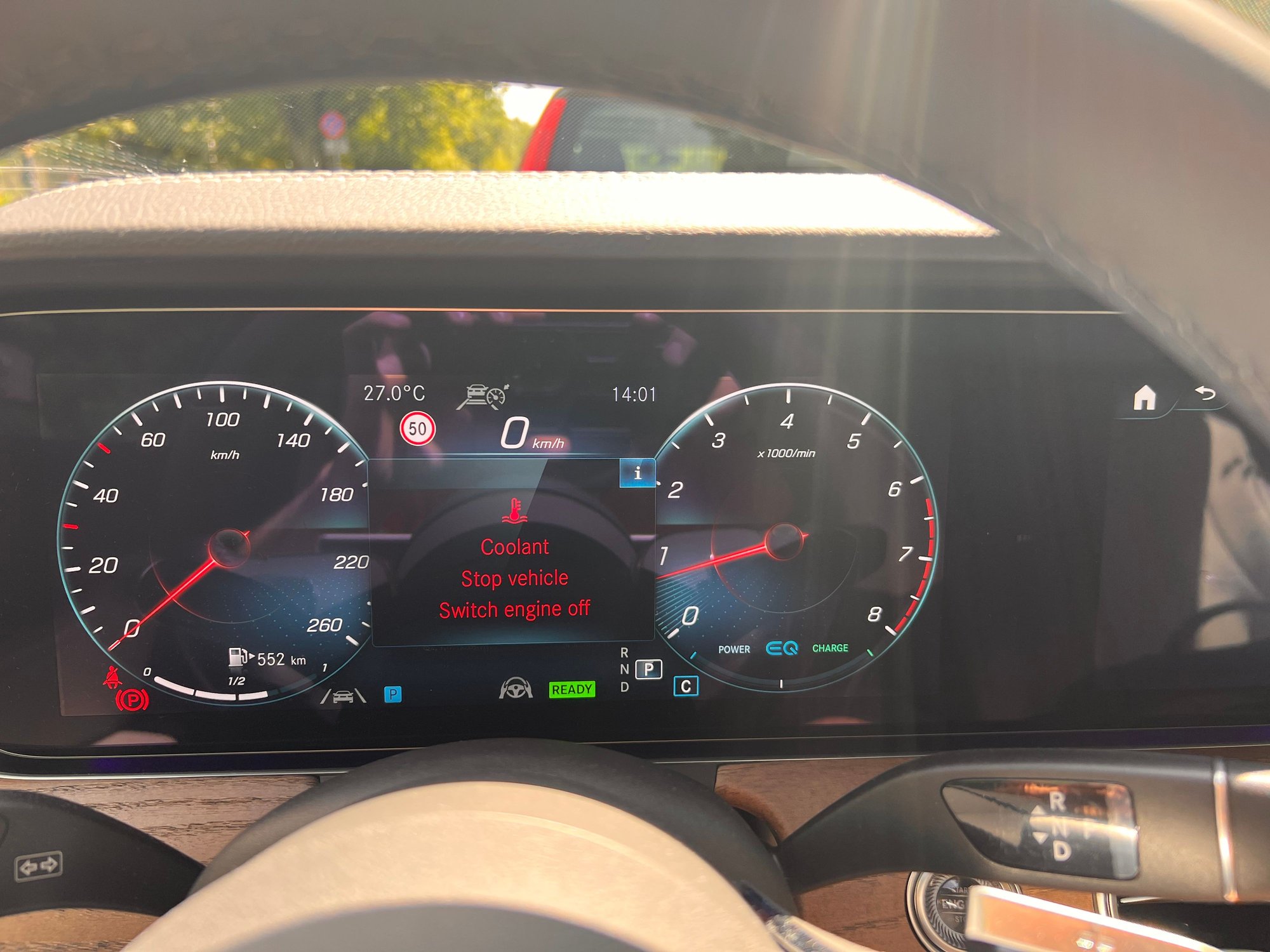

Ah well, after 3 weeks being a happy owner of S213…on a sunny day sitting in the car with engine and AirCon on after 5min got a warning!!!!
Here you go!!!

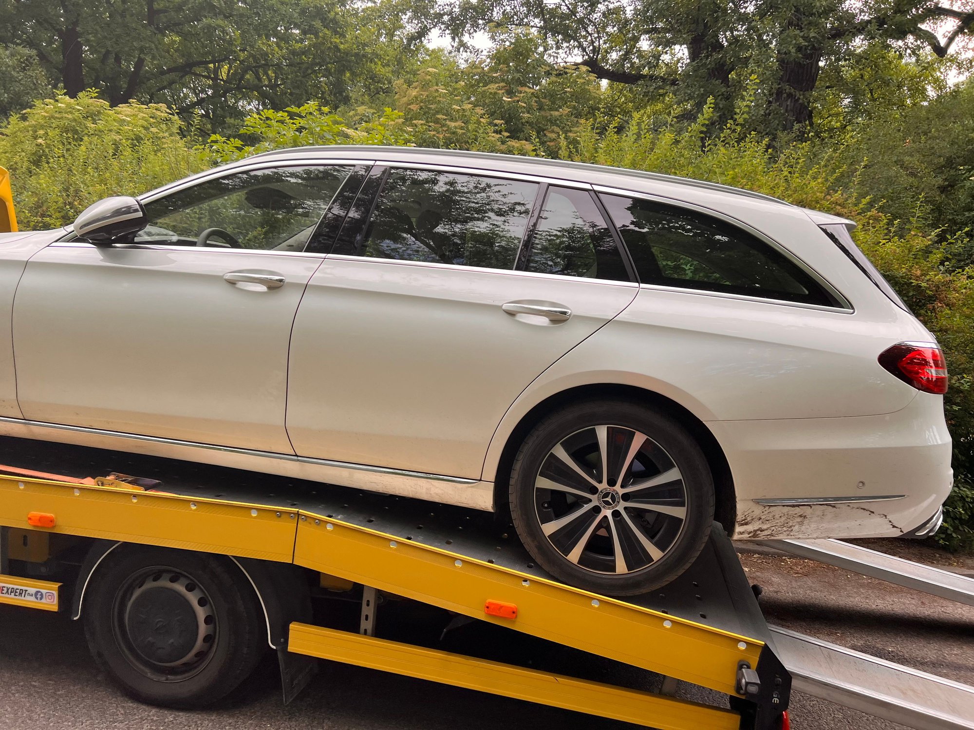

So I called MercedesMe support. Then service called asked to me to turn on engine again. Got same warning so they sent road assistance to two my car to the service.
I hope nothing serious considering services being short of parts!

At less than 1kMi: that is pretty quick service - Be sure to give "best score" on the phone factory survey...
I wonder, is this a true overheat or something else that would skew temp sensors.

hopefully the dealer will give you a free car wash, your car is pretty dirty.
Old Jun 20, 2022 | 01:37 PM
tyo's Avatar
tyo
Joined: Jan 2022
Posts: 65
Likes: 10
S213 200e 4Matic
Pretty, totally! Dirty….not that bad!
