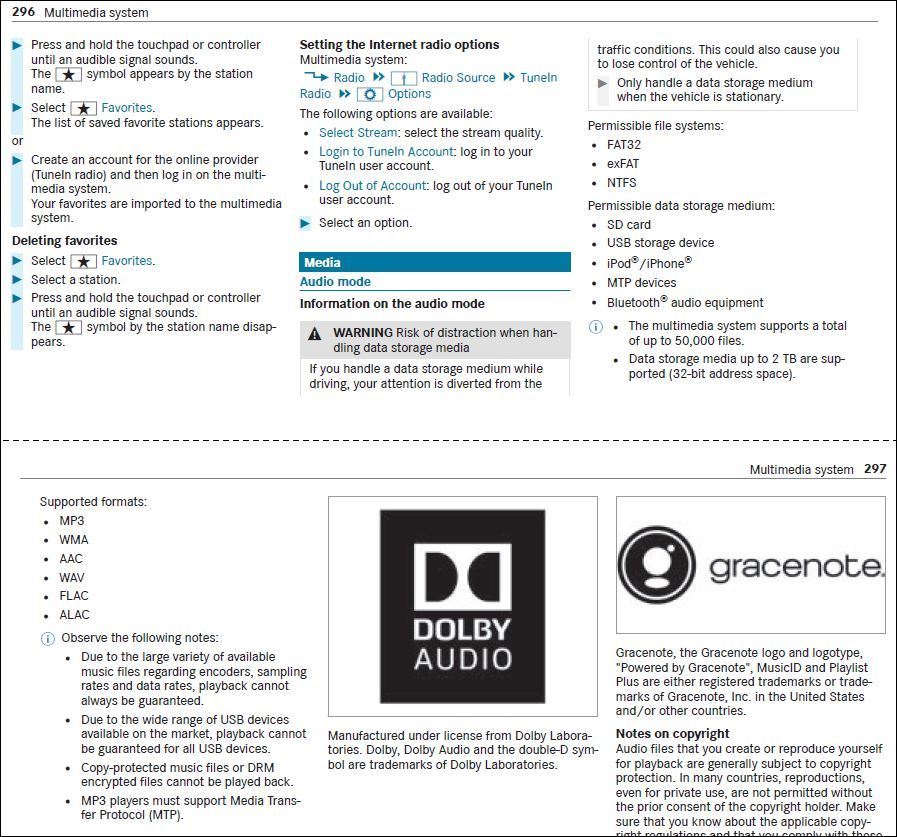

konigstiger's Avatar
Posts: 15,901
Likes: 4,632
From: North Scottsdale, AZ
'71 Pinto

All of that is ok...
Sometimes the USB loaded but it takes too much time.....
it is freezing on "USB is loading"

...Or, not formatted as required in the document provided above. FAT32 works fine.
