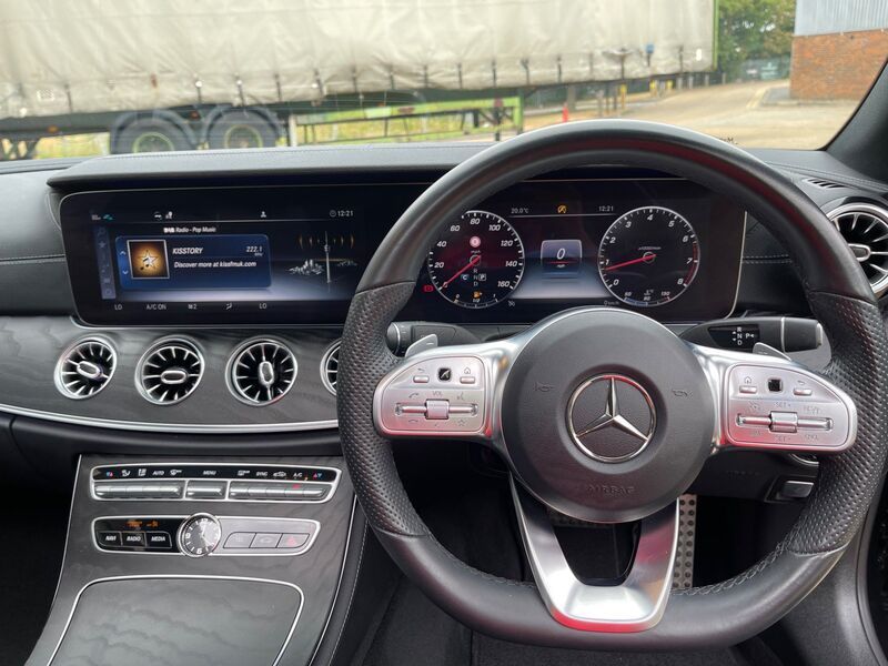

I want to swap the original steering wheel for the one with the cruice Control integrated.
As far as i know i'll also have to replace the module behind the wheel itself because of the cruise control, right?
I don't need the heated steering.
First - Should i do it on a Mercedes shop or can i just replace it at home?
Second - Do i need to reprogram anything or is it just "Plug And Play"? I'm asking this mainly because of the driving assist stuff. Will it interfere with it?
Third - Aproximatly how much will all of this cost me?
Forth - Where can i buy a new original steering wheel?
Thanks for the help.
This is what i have.
This is what i want.

youll need to replace a good portion of your steering column, youll also need to get a decoder for the new wheel and on top of all that someone with star will need to program it.
the dealer will not do that swap for you. find a mb shop

more than its worth to have the cruise control knob moved to the wheel.
min 3,000usd at least
