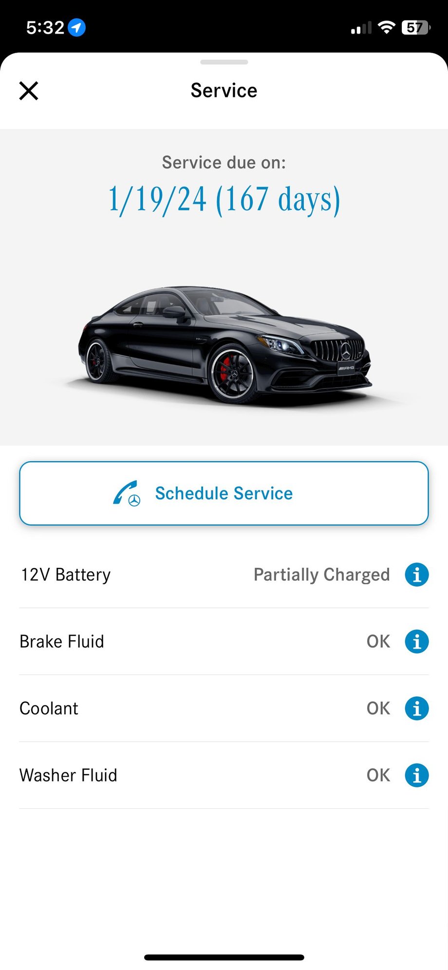

This is pointless w/o more information. What's the current mileage of the car? Service interval is every 10k miles or 12 months, whichever comes first. So if the car was serviced at 15k miles, then the next one is due at 25k miles or 12 months. For low mileage cars, the app will start showing a date and counting down the days once it realizes the car won't be driven 10k miles in 12 months. That's the case with my C63 for example as shown below.

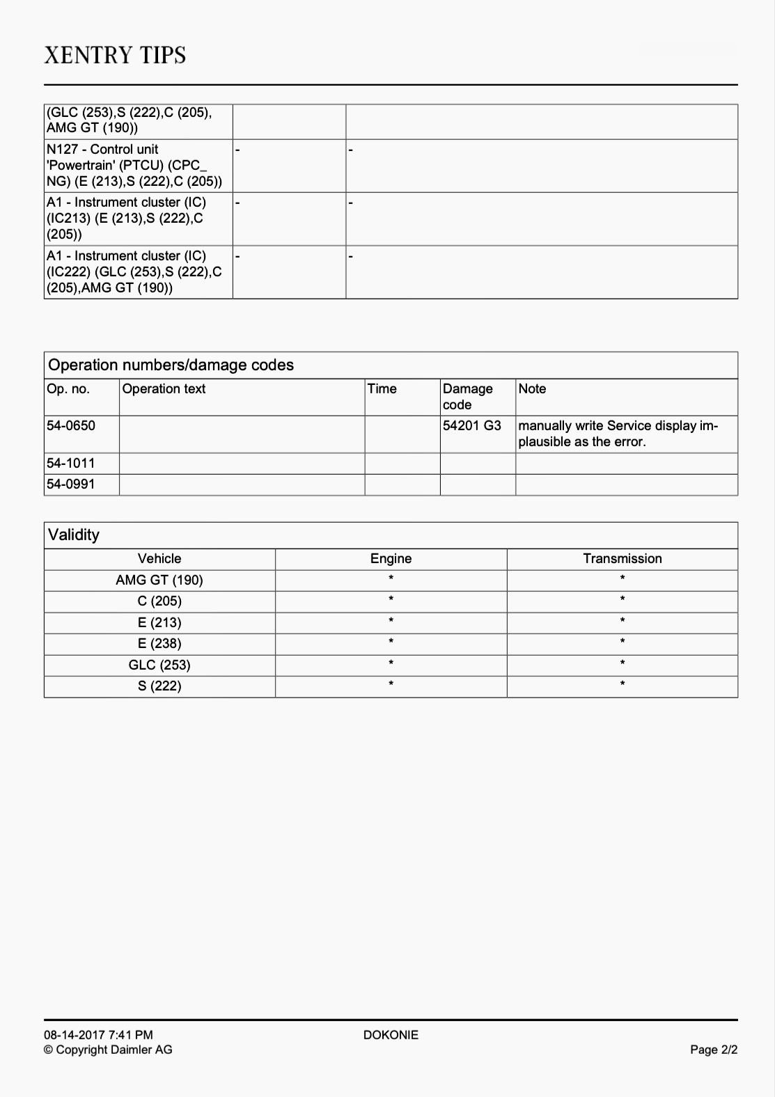

I found a TSB that I think deals with my problem. Says I need an “add on from xentry and an update

Could you list the TSB # for others facing this problem in the future?

This is the technical service bulletin I found. It seems like it’s an add on (firmware I think) and a software update. At least I hope so!
