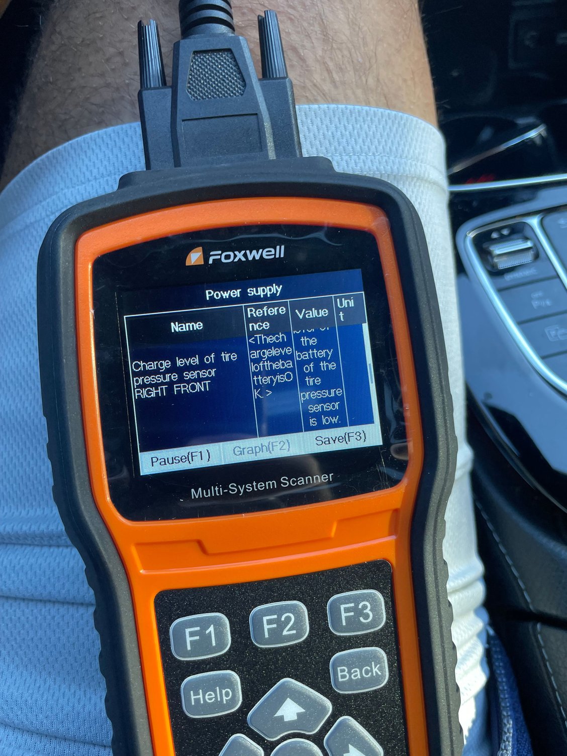

Old Dec 31, 2023 | 10:18 AM
Camaroguy72's Avatar
Joined: Aug 2019
Posts: 283
Likes: 77
2019 GLC300, 2017 E300

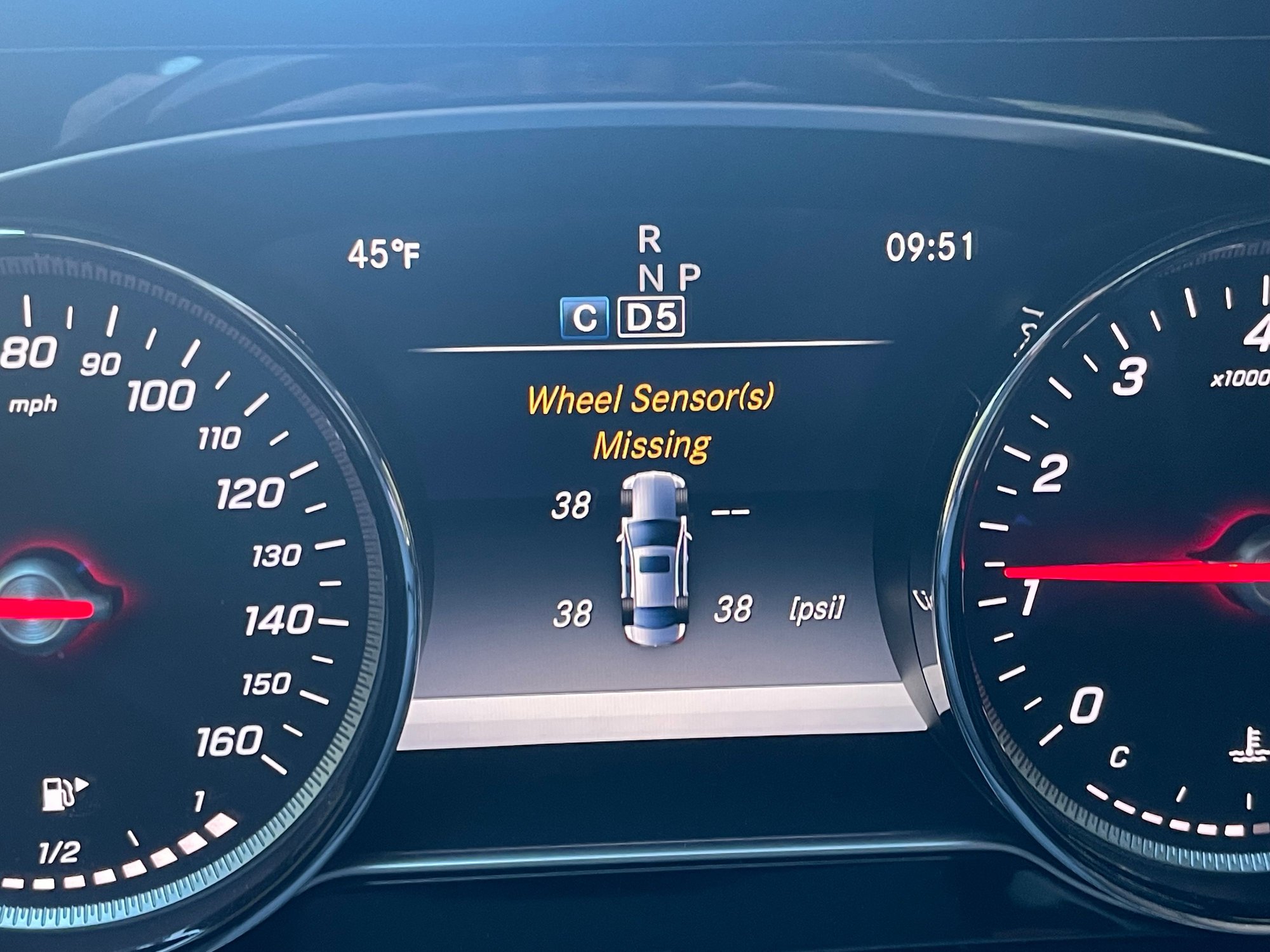

Old Nov 19, 2024 | 11:41 AM
tonytaxi's Avatar
Joined: Nov 2024
2018 E Class from new with 251000 miles driven 40 + hours a week and the nsr sensor has just given up time to replace them all £100 from Star Motors the independent MB service centre

The sensors on my truck and motorcycle both went bad after about ten years. They contain standard little batteries that go dead after a period of time. I have heard of people just replacing the batteries, but it involves some soldering work.
I replaced the sensors on my Mercedes when I bought new tires, and I think that was easier. I guess it depends on how often you replace the tires and how long you plan to keep the car.
