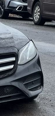

I have a 2018 E300, and I’m looking for a drivers side headlight assembly. Looking online but it seems there’s such a big gap between the dealer prices and assemblies i’m finding it on eBay and other sites, kinda wondering why there’s such a big gap, and knowing Mercedes there’s probably so many different parts to the headlight assembly I have to lookout for, as well as coding and all that extra stuff. Is there any way I can have any help? Thanks.

So I'm guessing that this means I do not have adaptive headlights. Also if not, am I alright purchasing the headlamp on eBay or carparts.com, using caution of course?
Also, do I have to lookout for if there's a module on the headlamp assembly ,or if it's included?
