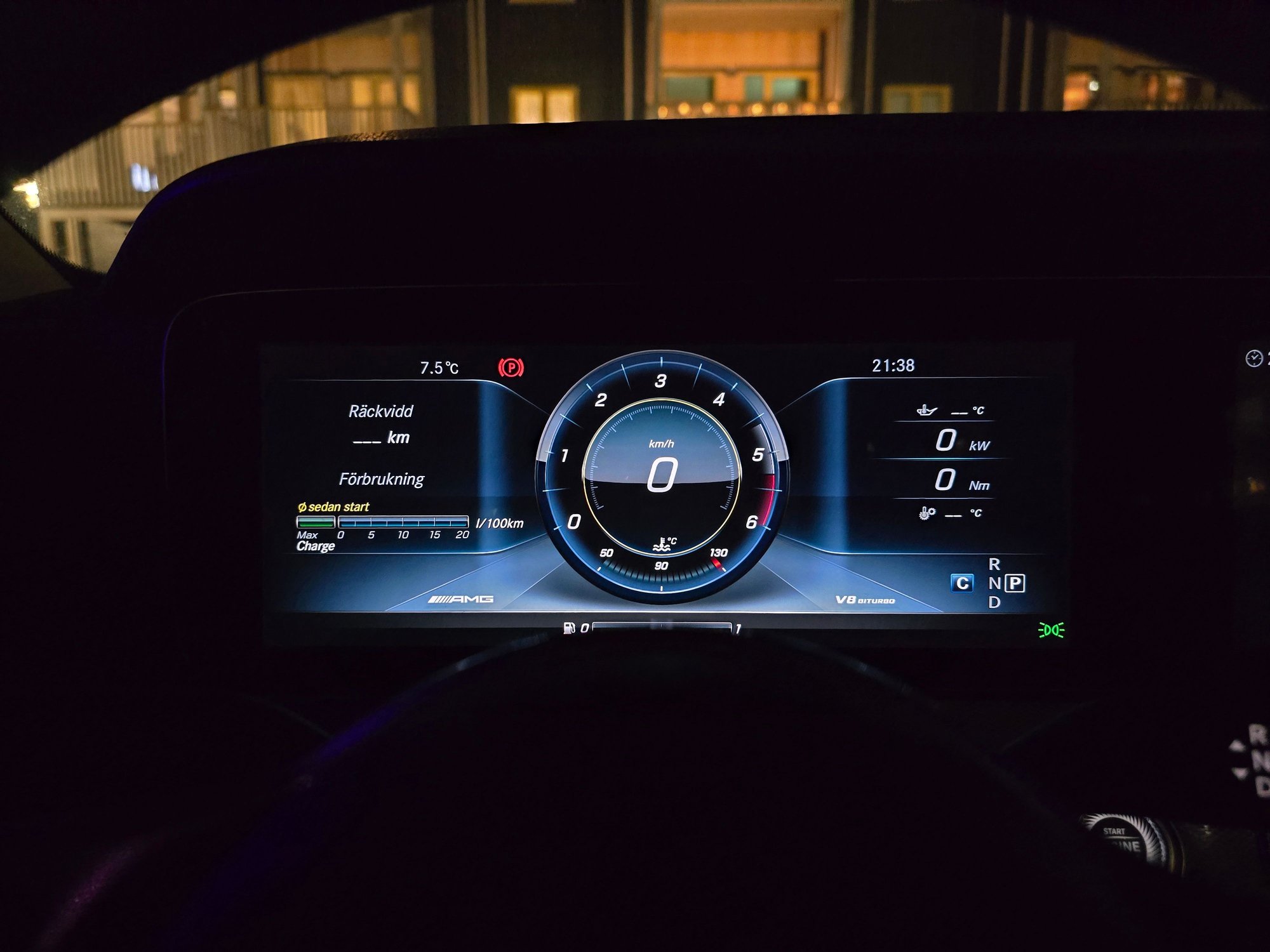

I Retrofitted a widescreen in my w213 today.
I've seen you could choose between three designs on the Widescreen, but on mine there is only one design.
The people who installed and coded it said it was the only one and there was no more.
Is that true? Or did they code it wrong?
Or do I need comand to get the other designs?
​I have audio 20 with internet (no comand).
My old screen.
The new
Only one design
No designs

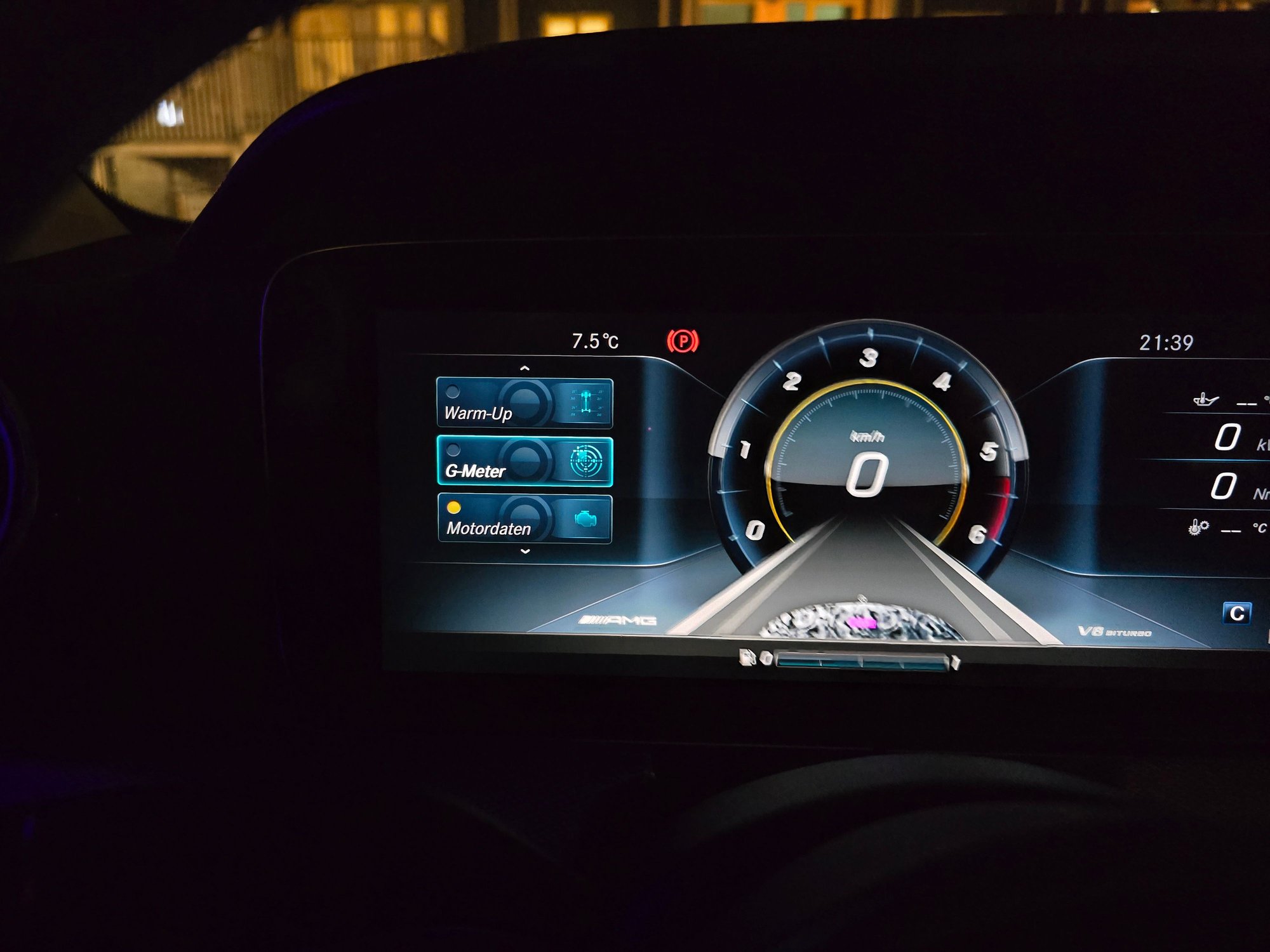

Car looks weird in the display
Apparently he made it AMG menu too.

I believe you need NTG 5.x version of Comand to be able to get everything. What version do you have?

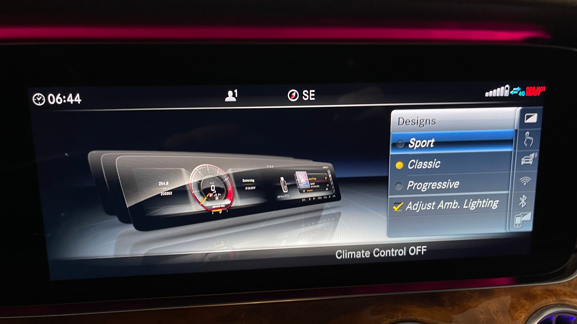

Go to home button, then system, then display and designs, then designs, you should see spot, which is AMG, then classic digital display on analog gauge then progressive. You are in progressive and appears don’t have the others to select from. Progressive and AMG are basically the same with AMG red while Progressive blue.
