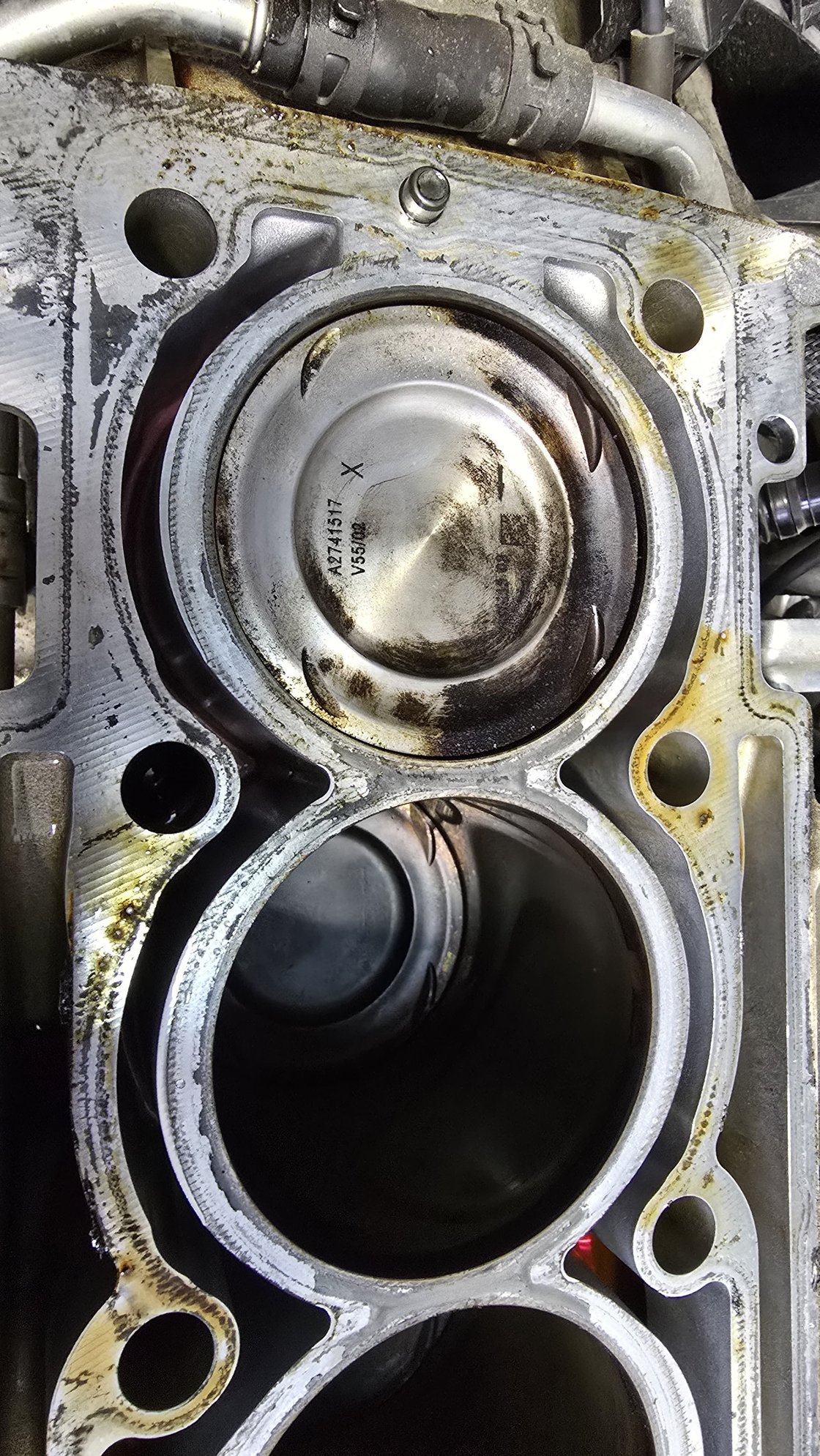

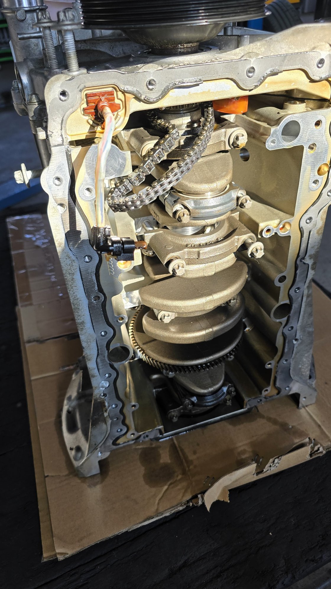

Hi everyone,
I wanted to give you an update on my issue. I took the car to the shop, and it turned out that the head gasket had cracked, causing coolant loss.
I bought a new cylinder head and installed it on my M274.920 4MATIC, but after just 20 km, the engine failed. The crankshaft bearings failed, and the crankshaft spun, leading to a complete breakdown. 😞
So, if you're experiencing issues with the M274 engine, my advice is not to rebuild it—just go for a new or low-mileage used engine instead.

Ouch, that engine is junk now. Spun crank shaft bearings usually fail due to lack of lubrication.
Reply 0

Mar 7, 2025 | 05:41 PM
hot engine usefulness expired
Sorry to read about you loss.
thin oil film with limited oil pump pressure does have its limits...
