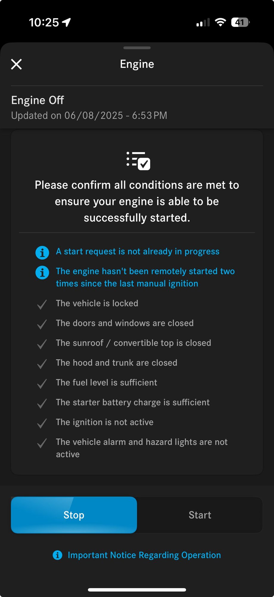

At the top of the screen it should say when the information you are seeing was updated as shown in the screenshot below. Is yours recent or old? If it wasn't updated recently, then your car is failing to communicate its status. That could be due to an issue with the communications module in the car.
Very recent...like exactly the time I last switched off the car and no updates after that

I think it's just not synchronising after the car is switched off... the mercedes me app always shows the last update occured just before I switched off the engine...
Yes, there should be updates after that. For example when I took the screenshot above on June 8, I last drove the car on June 7, so the vehicle status was last updated over 24 hours after I turned off the engine. I mostly drive my car on weekends, but the vehicle status gets updated periodically while the car is off. At a minimum it updates when I lock or unlock it. Does the lock status correctly reflect in the app? Assuming the car is locked now, unlock it and then lock it again. Does the engine status update when you do that? Does the last updated date change when you do that?
Status looks correct except for Ignition and I cannot unlock or perform any other remote function
That to me looks like an old status. Your parking brake status is not correct, either, as it automatically sets when the car is parked and engine turned off, so it shouldn't be released. If you go and unlock the car physically does it show in the app that the car is unlocked? So far it looks to me like your car is no longer communicating with the servers. Your communication module may have to be reset. This has happened to a few other people.
