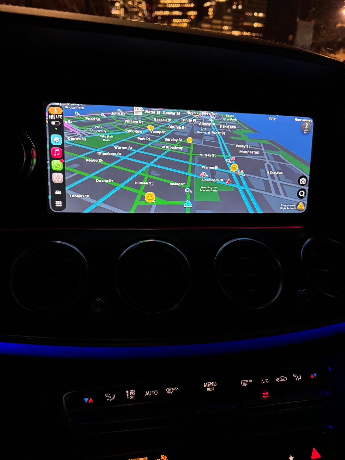

Hello everyone, I'm sorry. I've been down periscope with some personal business. I'm going to make two posts. This first one is from 5000 feet in the air. The AI version is that I am 95% satisfied and I would buy from Max again. I am glad I mad the purchase and I think Max is a good guy and trustworthy. In November I paid Max for the module and he sent it within two days. I was busy because my wife was in the hospital, but eventually I got around to installing the module. I paid a Mercedes mechanic to install the unit even though Max said I could do it.
Max helped me remotely. I'll bet I sent him 50 WhatsApp messages and every time he answered me promptly. His answers were succinct and helpful. I am writing report explaining how to take full advantage of Max's offering. It's all about the configuration. I am also working on a quick guide for Max to use. I'm reviewing and sharing with Max and I hope to upload it before the new year. I've spent hours experimenting with different configurations to see how the system reacts, depending upon how you configure your telephone and configure your CarPlay. Some of my contracts are 1000 pages, I am very careful about checking and double checking my work.
That is my posting for today, Here is a photo of my screen which I sent to my
Mercedes service advisor because he told me I would never make it work!
Reply 2
