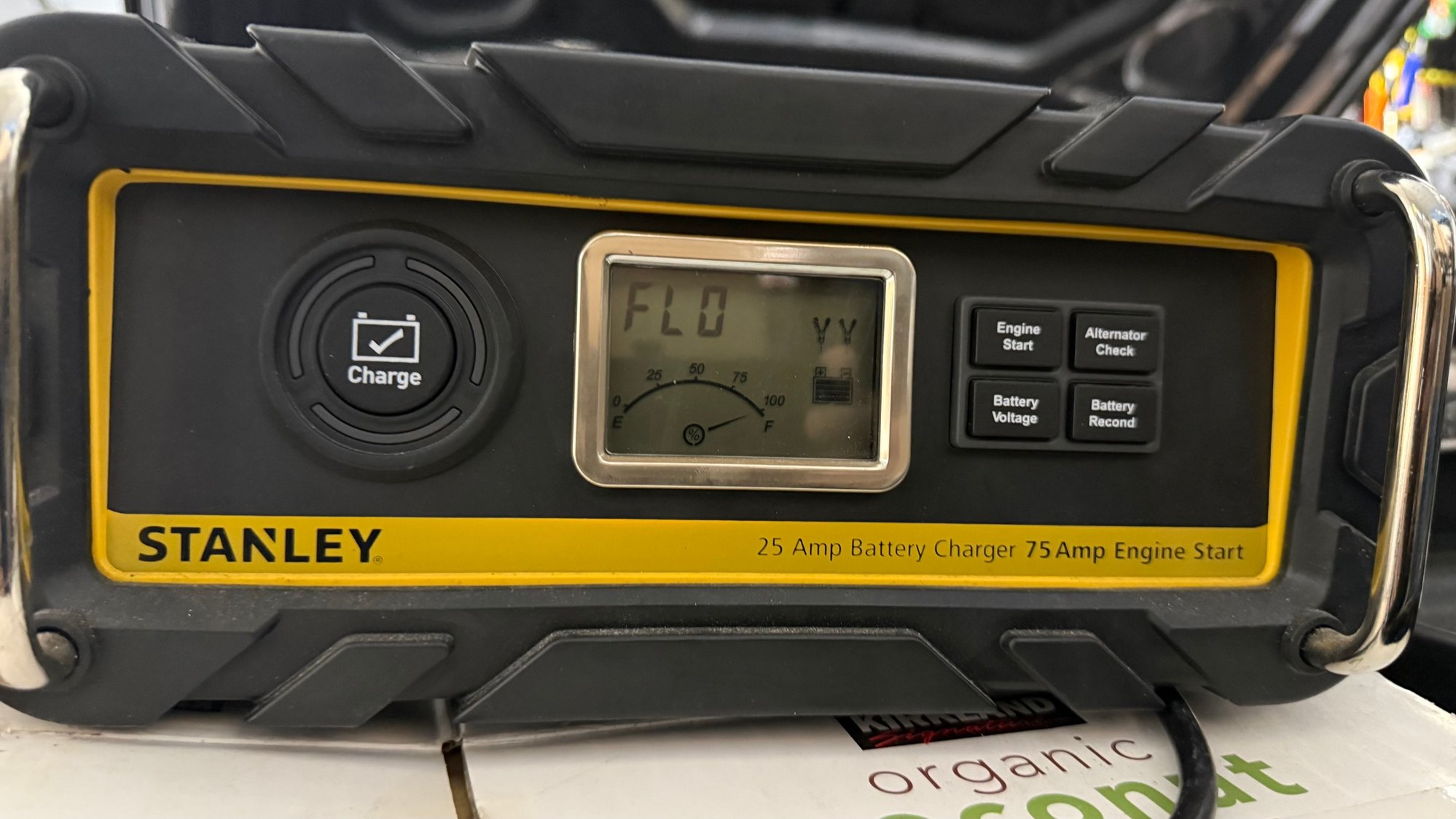

I have a 2017 with the same original battery. During COVID I received the same error due to the fact that the car wasn’t being driven frequently. I purchased a trickle charger and did a battery recondition and keep it on when I don’t plan on driving for a couple days especially in colder months. My car now has approximately 46K miles and have not had any issues. Do what you think is best for you, even with a new battery a trickle charger is still relevant depending on where you live and how frequently you drive the car
Trickle charger, jump starter, alternator checker
3a/25a/75a Battery Charger & Maintainer
Automatically Selects Charge Rate & Adjusts From Rapid Charge To Trickle Charge To Maximize Battery Life
75a Patented Engine Start To Jump-Start A Vehicle In 90 Sec
Alternator Check Indicates Potential Alternator Issues
Battery Reconditioning Technology Helps Reverse Sulfate Buildup On Battery Plates To Improve Charging Carrying Capability & Extend Battery Life
LCD Screen With Easy-To-Read Icons
Reverse-Polarity Protection
Includes Heavy-Duty Cables, Metal Clamps

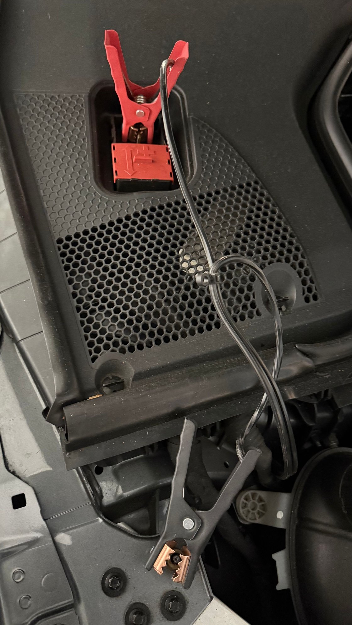

I am strongly considering the trickle charger. Would I have to pull the battery out of the car to charge it with the trickle charger or could I do it in its place, while keeping the hood open?
No need to remove the battery, just slide the positive battery terminal cover down to expose the charging terminal and attach the red cable, then attach the black to the ground location, see attached. Leave the hood open while connected. I live in NJ so similar weather, I’m also on an elevation so also 5+ degrees colder than a half mile down the hill.
Trickle charger connected

Originally Posted by kingscorpian27
Thank you for your explanation, can you please provide photos of your setup so others can see and benefit from it if they decide on going that route. Appreciated
I just edited my prior post to include link to a thread discussing this topic with several pictures and other discussion around how to do this and what chargers people have purchased.
I am using a Battery Tender branded charger that I have had for years and also use for other equipment - just make sure it’s compatible with AGM batteries.
