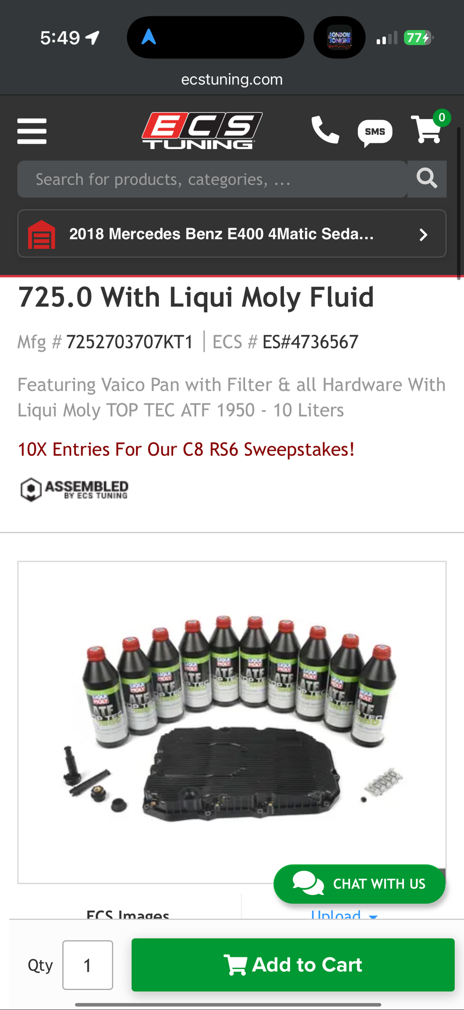

Planning to get my E400 serviced, recently purchased not sure what previous services were done and when so gonna do them all. If anymore can guide me through this in terms of what parts I’ll need. I have a trusted shop to do it for me but I’d like to purchase the parts myself. I see this kit here but the site is saying it does not fit my car and recommends parts for a 7 speed, that’s gotta be wrong right?

so the screenshot I sent is the right kit right? 9G is the 725 transmission?
Correct

That is correct and will work. The 725 is the 9Speed

This is the kit I was going to order but it does not include the special tools you need to refill the transmission

I have a 2018 E400 wagon and at 36k miles I had the automatic transmission serviced, using the transmission kit I bought from FCP Euro for $281 + tax and free shipping. That kit has the Liqui Molly fluid and not the MB fluid. The one with the MB fluid is about twice the price and the only thing that's different is the fluid. I also had the rear differential fluid changed at that time using MB gear oil (I wasn't sure what other oil was correct), which was quite pricey.
