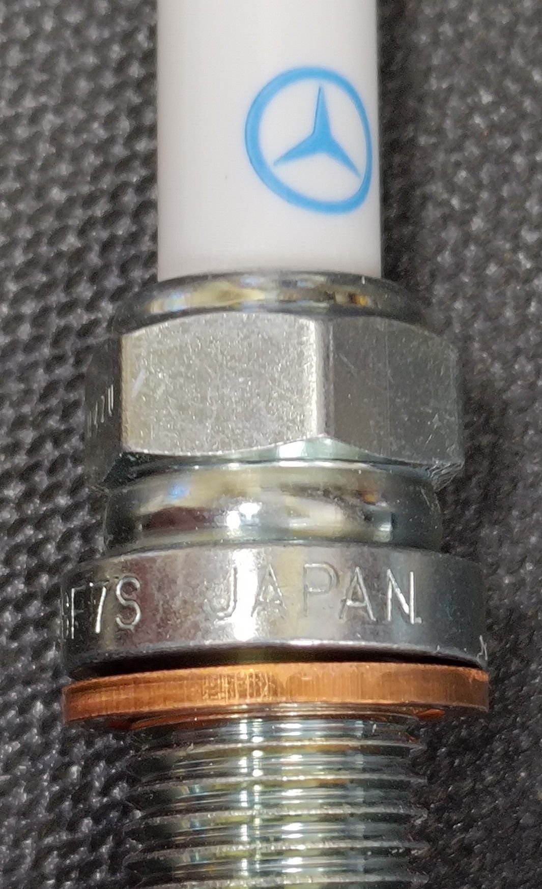

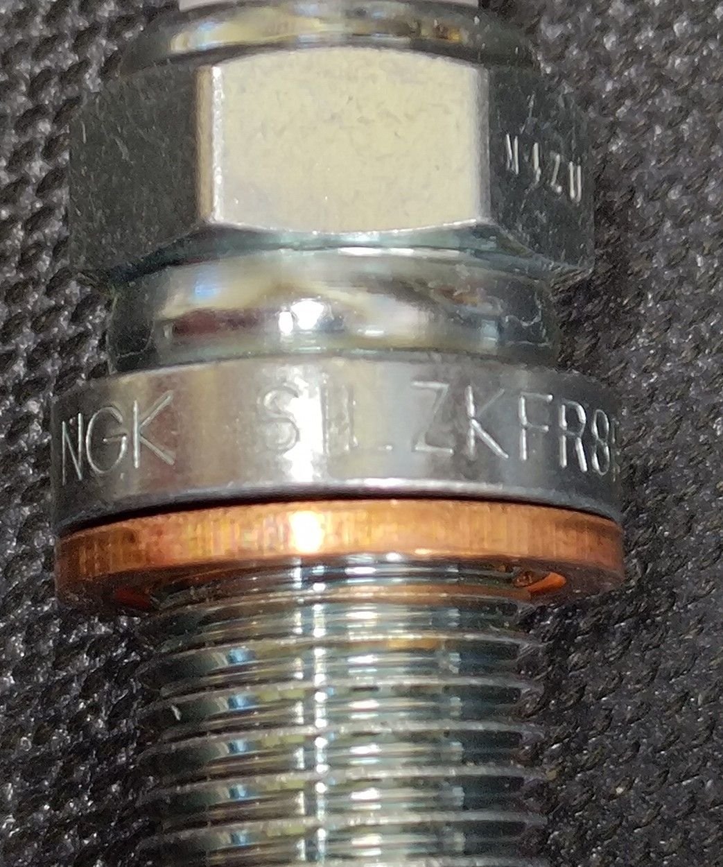

When I bought a set of MB OE plugs for my G550 (M176), they had NGK p/n's etched on them. The NGK plug was about $2 cheaper, and Bosch was about $8 less as I recall.

No question that NGK makes the best plug (which is why MB OEMs from NGK). My G550's plug is an MB A000 159 05 00, and has the NGK p/n SILZKFR8F7S etched on it. Bought them from AutohausAZ in September 2025 for $22/ea.
how does the firing end look ??
NGK is known for not compromising with quality... real copper crush-washers!

How can I successfully X-Ref genuine MB from Bosch into premium NGK ??
I think their firing tip is a bit more effective.... I want to test it.
Around 50k.Mi my engine was already running poorly compared to now at 80k.Mi.
So now I'll be able to tell right away what fires better/worse...
From experience I can almost bet "stubby iridium" electrode fires better than center "needle iridium".
NGK
NGK (MY'18 3.0TT) - Courtesy RockAuto dot com
Bosch
Bosch shows approximative firing geometry
Both the above sales pictures look like they feature similar stubbly iridium pelet.

At 50k.Mi mark I failed to source NGK's to upgrade my factory mounted plugs. So I had to use Bosch plugs I had to file metal burrs off the GND strap. Genuine NIB Bosch.
NGK
Bosch
