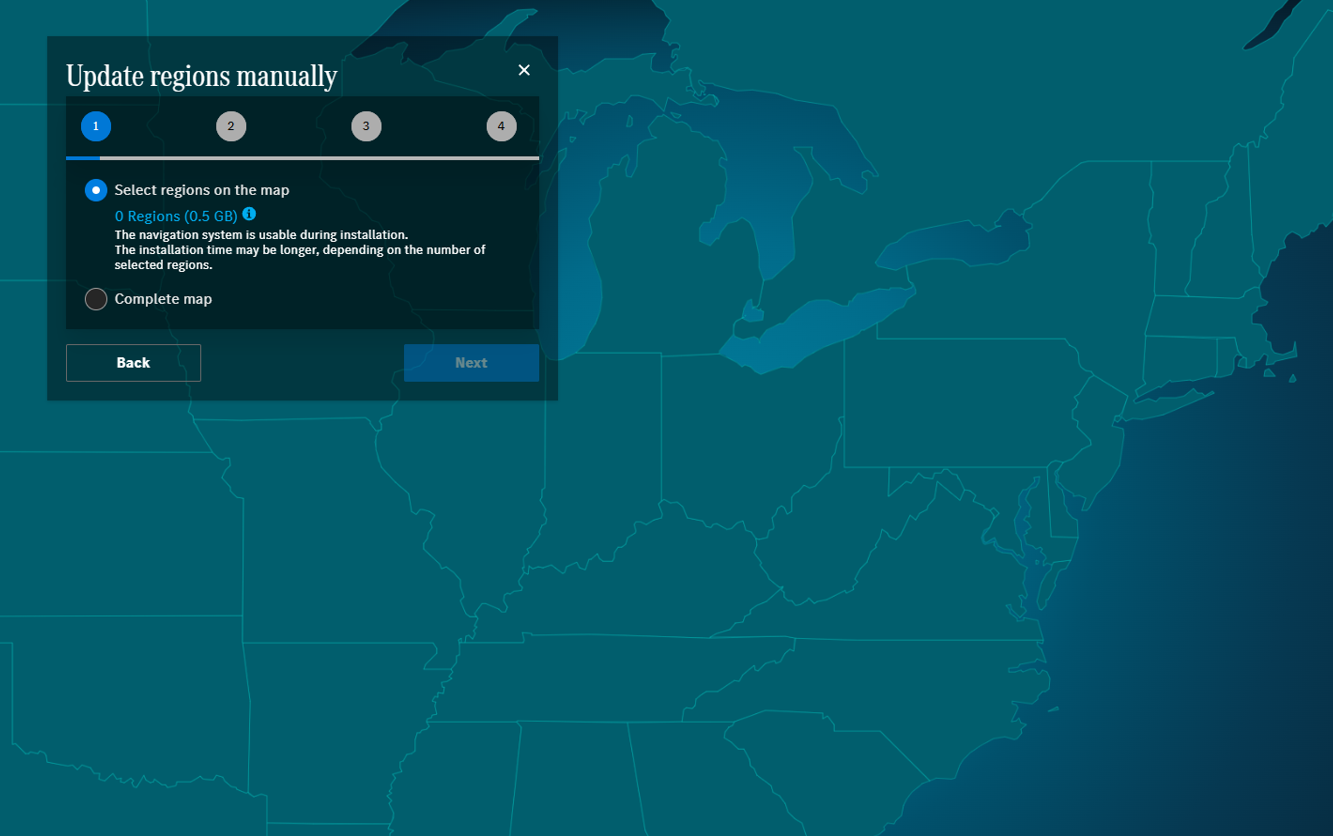

Can you select regions? Step 1 says select regions on the map, but a single click on a region on the map doesn't select it, and a double click just zooms in. So the only option for me is to download the complete map.
You can. I posted instructions a while back here.

I was on this page but neither mousehover or a single click on the map brought the pop up message of region selection. Maybe because mine is my2024 and the car has v9?

A single left click on a given region should toggle it on or off. There will not be a popup. If that is not working then I don't know what your issue would be. What kind of computer are you using?
Why don't you just do the full map?
I'm using Firefox/Chrome/Edge in Windows 10. Maybe full map is the way to go, and I should get a 64G flash disk for that.
