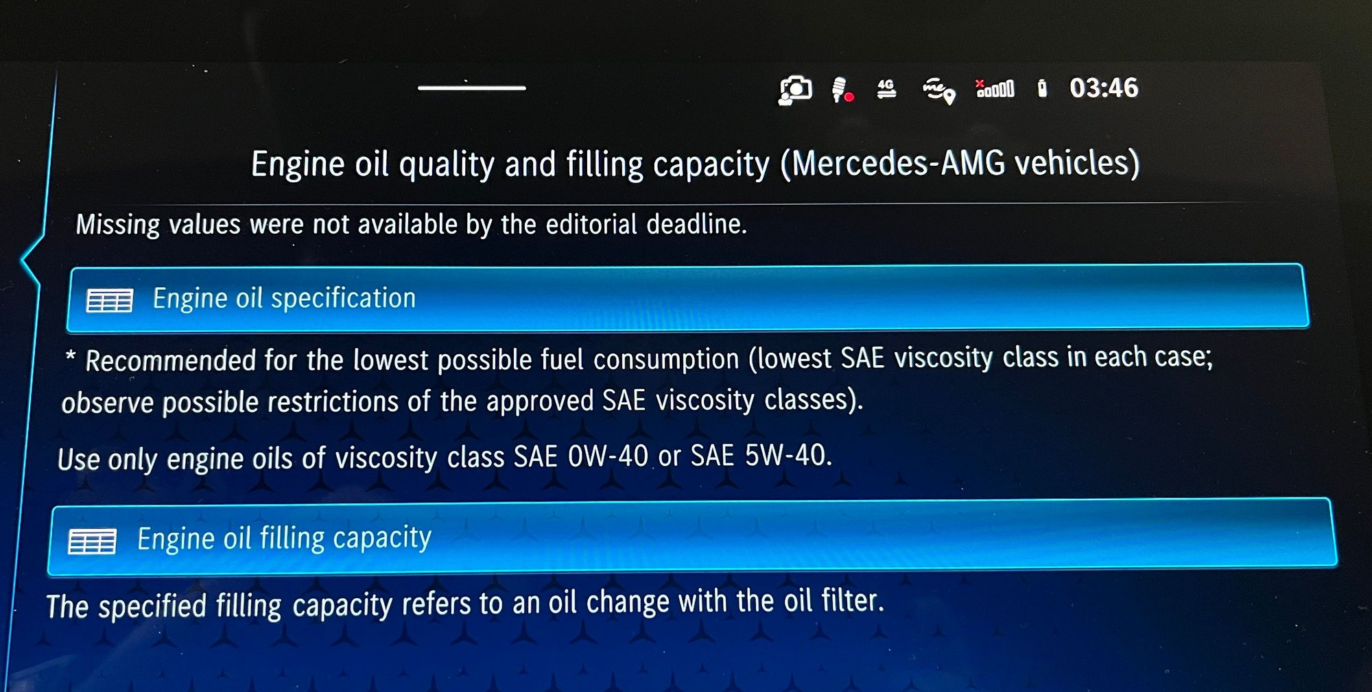

According to the online digital manual the E53 should use 0w-40 or 5w-40 oil but the actual oil quality is not specified.
https://www.mbusa.com/en/owners/manu...s-amg-vehicles
I plan to change the oil in another 3000 miles and I am hoping to get some clarification on the oil type for the E53 beforehand.

The 2025 E53 Hybrid digital owner's manual specifies the oil viscosity as 0W-40 or 5W-40 but does not specify the quantity or quality of the oil. I believe the oil capacity is 10.5 quarts.
The digital owner's manual for the CLE53 with the same 256.830 engine as the E53 specifies the viscosity as 0W-20 and the quality as 229.71 or 229.72. It also shows the capacity as 8.5 quarts. Why is viscosity, quality, and quantity different than the 2025 E53?
How do we know with certainty that the oil quality for the E53 is 229.51 or 229.52 and the capacity is 10.5 quarts? Is there any document other than the 223.2 Engine Oil table that provides a definitive oil specification for the E53 Hybrid?

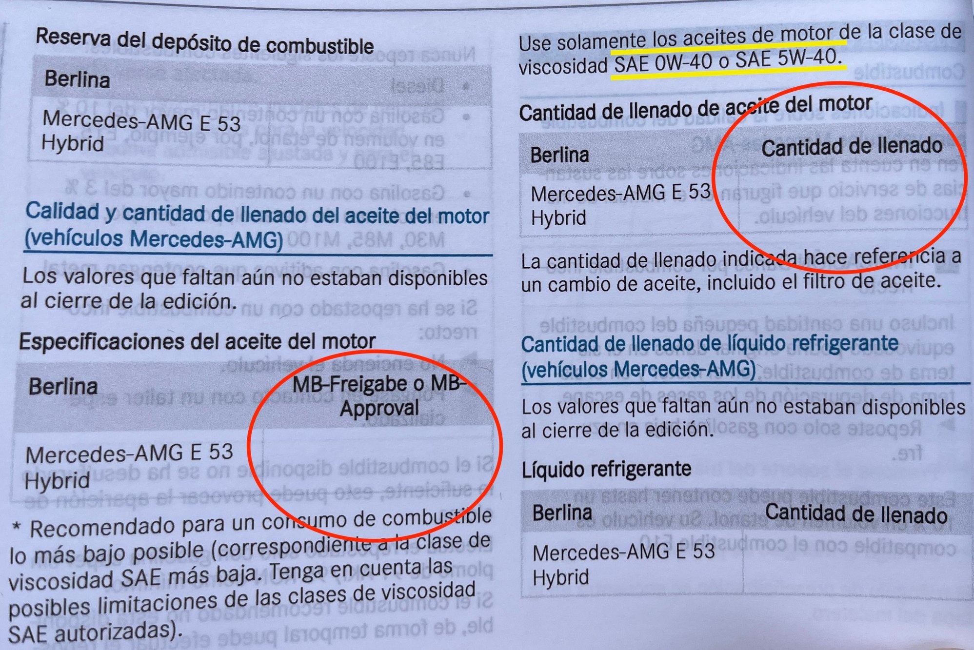

I did find a reference to the AMG E53 Hybrid oil viscosity 0W-40 or 5-W-40 on page 52 of the Spanish AMG supplemental manual (PN: 214-584-76-03). But the oil quality and capacity are not stated, even though there is a space for this information on the page. This incomplete information is the same as I found in the English version of the Digital Online W214 owner's manual. The hard copy of the W214 manual supplied with the E53 states that "All Models" of the car use 229.71 or 229.72 oil with a 0W-20 viscosity. To be fair, only the E350 and E450 models are listed in the paper manual. In my judgment, the chances of someone using the wrong oil in the E53 is possible due to the sloppy editing of the paper and online manuals.
Page 52 excerpt from supplemental E53 AMG owner's manual.
Page 52 excerpt from supplemental E53 AMG owners manual.
Clearly a screwup on Mercedes-Benz's part. Maybe they figure no E53 owner will be changing their own oil. Have you tried calling the service dept of yours or any dealership? You could also call parts and ask them for the proper oil and quantities.
