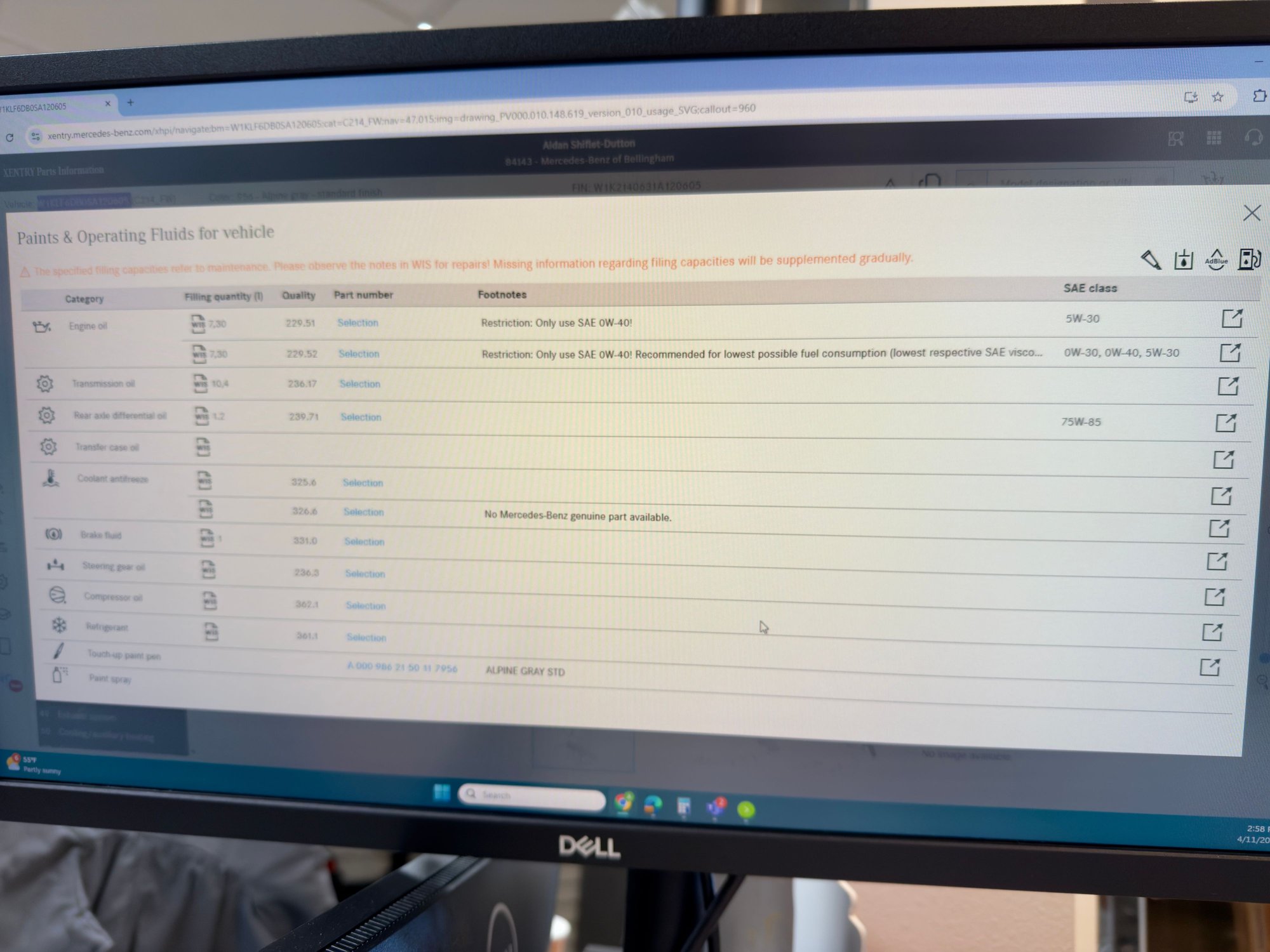

Had an alignment done today at the dealership, took this pic while picking up a filter and plug from the parts counter.
https://cimg6.ibsrv.net/gimg/www.mbw...bdbcb121a.jpeg
I wonder why the transfer case doesn't have a mb approval specification displayed.
Is that screen shot the results after entering the VIN from your E53? If so, this seems like a definitive description of the capacity, quality, and viscosity for the E53 oil.
Yes, you can see the vin in the url.
Worth noting, they are using Mobil1 Euro at spec 229.5 in their oil changes for this application....
Seems like a good reason to do our own oil change.
So the dealership actually used 0W40 grade oil rather than 0W20 that is specified in the recommended spec sheet.
0w20 is not specified for the E53, 0w40 or 5w40 per the in-car electronic manual, 0w40 specifically called out in the screenshot I took.
Can anyone explain the difference between the oil specification and capacity in the screen shot in post #34 and this excerpt from the Jan 2025 online E-Class manual? MB is really doing everything they can to get customers to inadvertently change oil with the wrong spec and capacity. Whoever is responsible for editing the owner's manual deserves to be fired. I don't believe 229.71/72 oil is even available with 0w40 viscosity.
https://www.mbusa.com/en/owners/manu...s-amg-vehicles
Excerpt from January 2025 online E-Class Owner's Manual
Honestly looks like poorly edited combined info from other parts of that same manual. In the non AMG section it calls out .71/.72 and the same lower capacity for “All other models”.
The picture I posted was live data from xentry.
