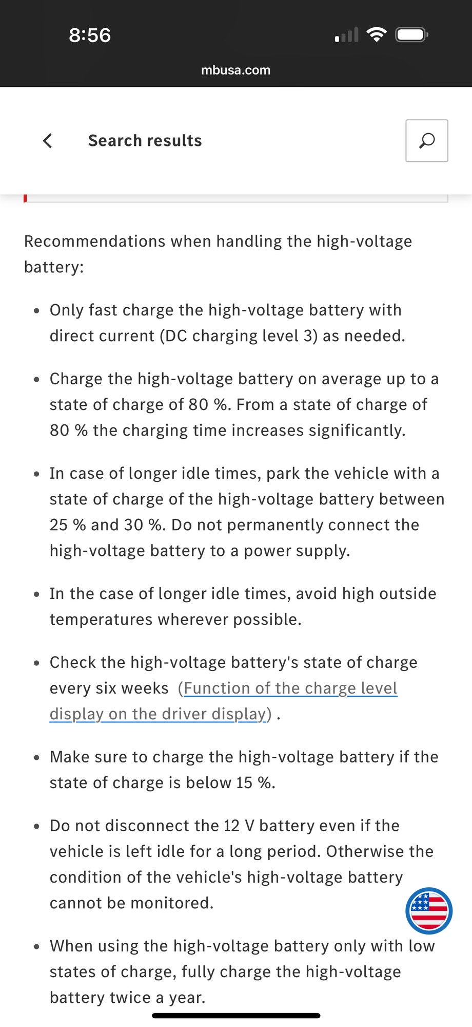

Per the online manual it’s 15%.
15% it is
