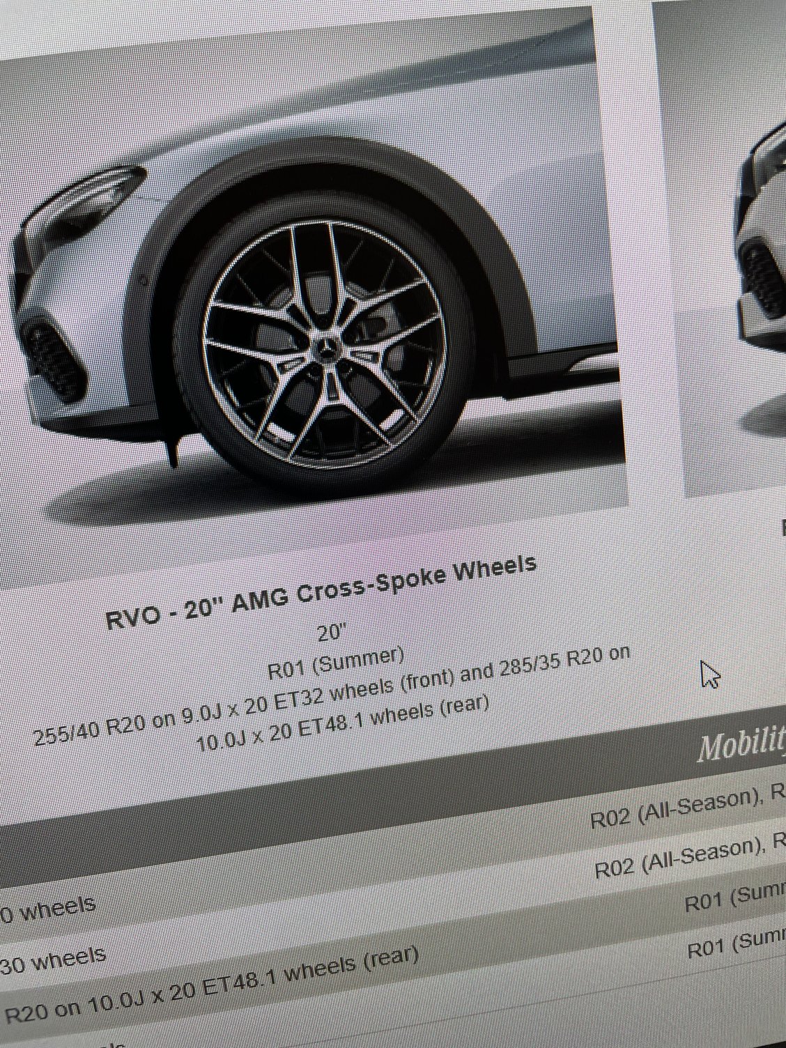

Just checked with Costco tire center and was told they couldn't do rotation since the front/rear tires are of different sizes. So do we just drive them to the end?

Assuming this is your fitment, you also need to be aware that these are summer tires and not adequate for consistent temperatures below 45 degrees. Look to Tire Rack or similar for the options but I’d offer that Michelin Pilot Sport All Season is a good option.

I have the Michelin Pilot Sport A/S 4 tires on all of my cars. Totally worth it.Originally Posted by dbrown167
Correct called STAGGERED tire size.
No rotation and do not let any shop try to sell you a tire rotation.
One thing it does it cut tire MILEAGE WARRANTY in half - Read Fine Print.
Does allow you to buy just the rears or fronts as needed though.
Kinda makes you wonder why all your life you heard YOU MUST ROTATE tires.... if they now sell cars where you cannot rotate

Please also note that in case of the 2024 GLE (possibly earlier years too) etc., even though the front/rear tires are the same size on 20” wheels, it has the same situation as the staggered tires. Originally Posted by pdeacon
The point of this thread is what to do when you have staggered tire dimensions. The answer is simply you are precluded from rotating tires. That was the OP's original question.
This is because the wheels in the front have a different offset from the rear wheels. So even though the tires are the same size (and might appear to be a square setup), we cannot rotate, unless one wants to pay for removing, remounting and rebalancing. So the situation exists even in the non-staggered tires, due to the decision made by Mercedes to have different offsets in the front vs the rear wheels.
Thanks for the emphasis on the differences in offset, true even if the tires were identical size, squared, MB likes to do different offsets so same idea, still can't rotate them. Originally Posted by Roweraay
Please also note that in case of the 2024 GLE (possibly earlier years too) etc., even though the front/rear tires are the same size on 20” wheels, it has the same situation as the staggered tires.This is because the wheels in the front have a different offset from the rear wheels. So even though the tires are the same size (and might appear to be a square setup), we cannot rotate, unless one wants to pay for removing, remounting and rebalancing. So the situation exists even in the non-staggered tires, due to the decision made by Mercedes to have different offsets in the front vs the rear wheels.

Yes, wheels have the same width, front to rear. Tires have the same width front to rear.Originally Posted by W205C43PFL
But the front wheels have a different offset from the rear wheels. So cannot rotate, unless the dismounting/mounting/re-balancing routine is done. Either way, crazy decision by MB to do it this way.
I see seems like that is how MB likes to do it. I don't think the other 2 German competitors do this or I am fully mistaken?Originally Posted by Roweraay
Yes, wheels have the same width, front to rear. Tires have the same width front to rear.But the front wheels have a different offset from the rear wheels. So cannot rotate, unless the dismounting/mounting/re-balancing routine is done. Either way, crazy decision by MB to do it this way.
I had no idea any manufacturer could or would do anything as boneheaded as this. These wheels and tires would be indistinguishable to most of us, and certainly to any tire shop tech asked to rotate them. Are the wheels clearly marked in some way?Originally Posted by Roweraay
