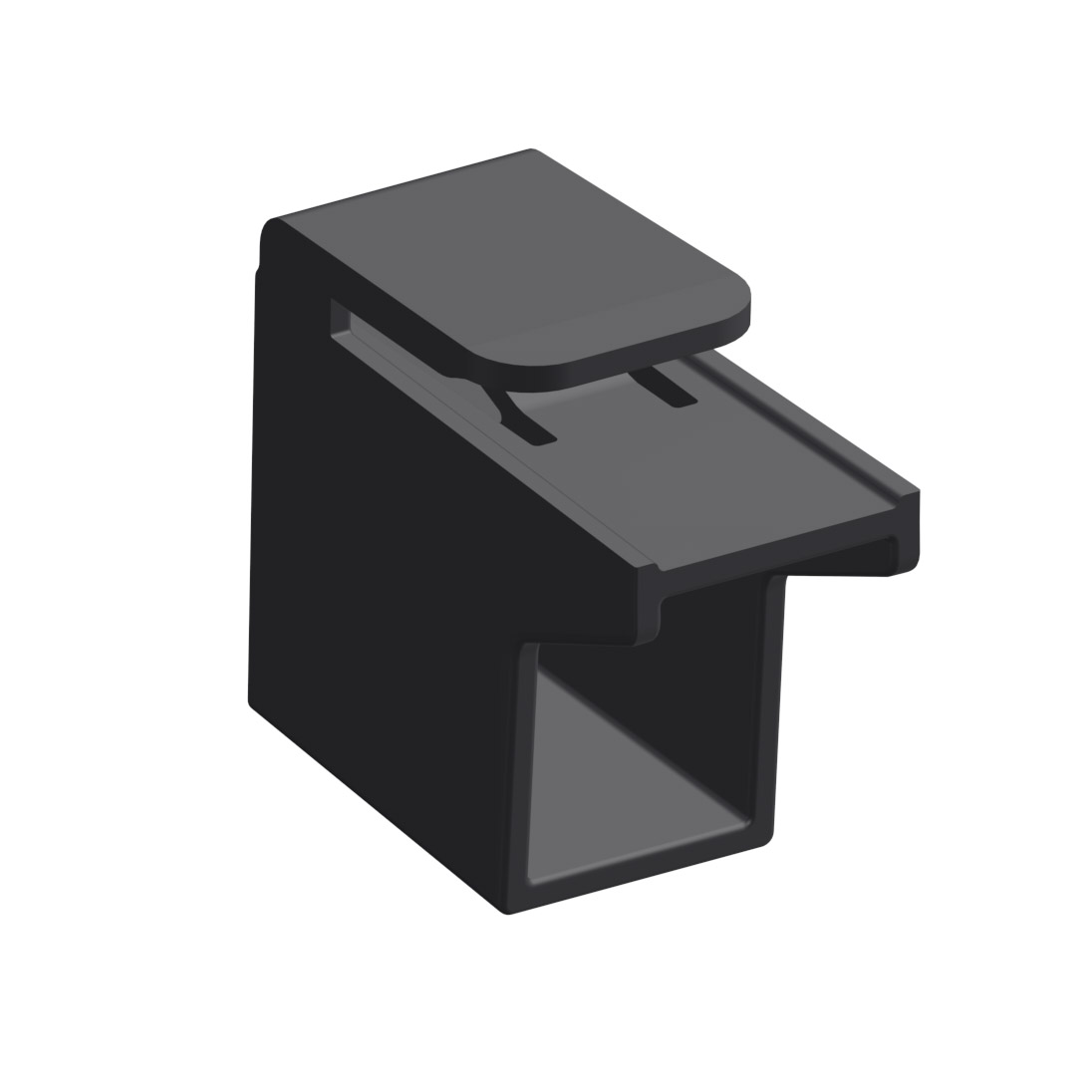

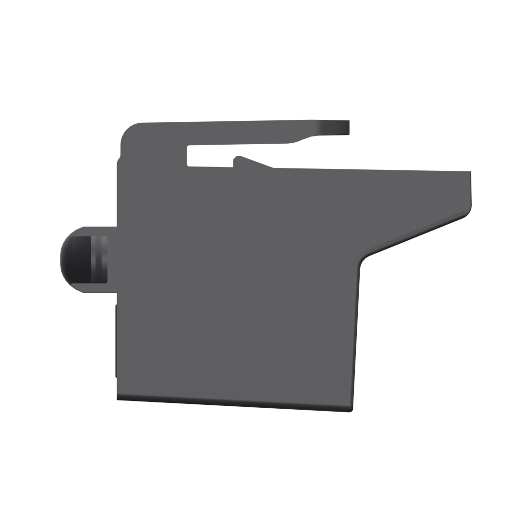

Found some pictures of 220 in the diagram below (Fastening Clip | A0009915902)... you might be able to find the others there also. Does the diagram below match reality (your car)?
A0009915902A0009915902
Old May 9, 2025 | 12:21 AM
chuck.norrisky's Avatar
Joined: May 2024
Posts: 66
Likes: 19
From: NorCal
S214
Zooming in on the photo, it looks like there are slots (a little blurry in the image) where the red arrows point. It looks like these slots are what is captured by the tabs in 200 and 220.

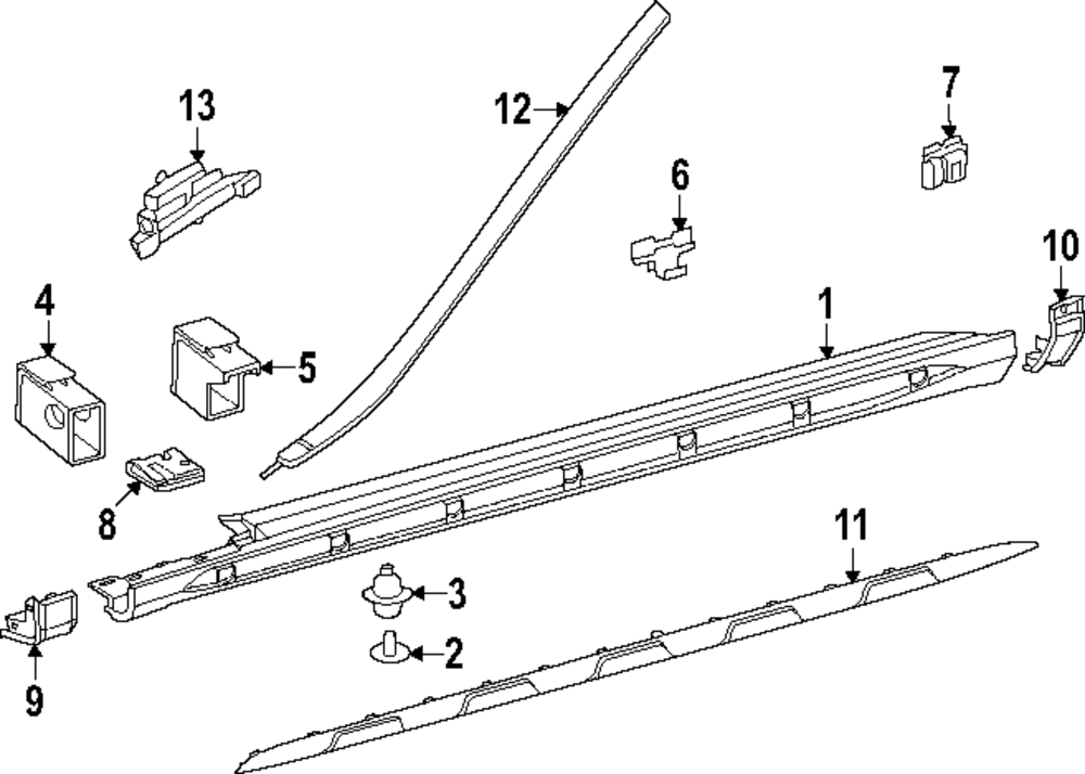

Here is a better part diagram (2024 Mercedes-Benz E 450 Molding 214-698-68-00-64 | Mercedes-Benz Parts of Miami):
Old May 10, 2025 | 02:00 AM
Joined: May 2024
Posts: 66
Likes: 19
From: NorCal
S214
If you want that chrome to be black, you could buy the night package version of part number 11 in the diagram... I think the part number for the black variant (left side) is 214-698-80-00.

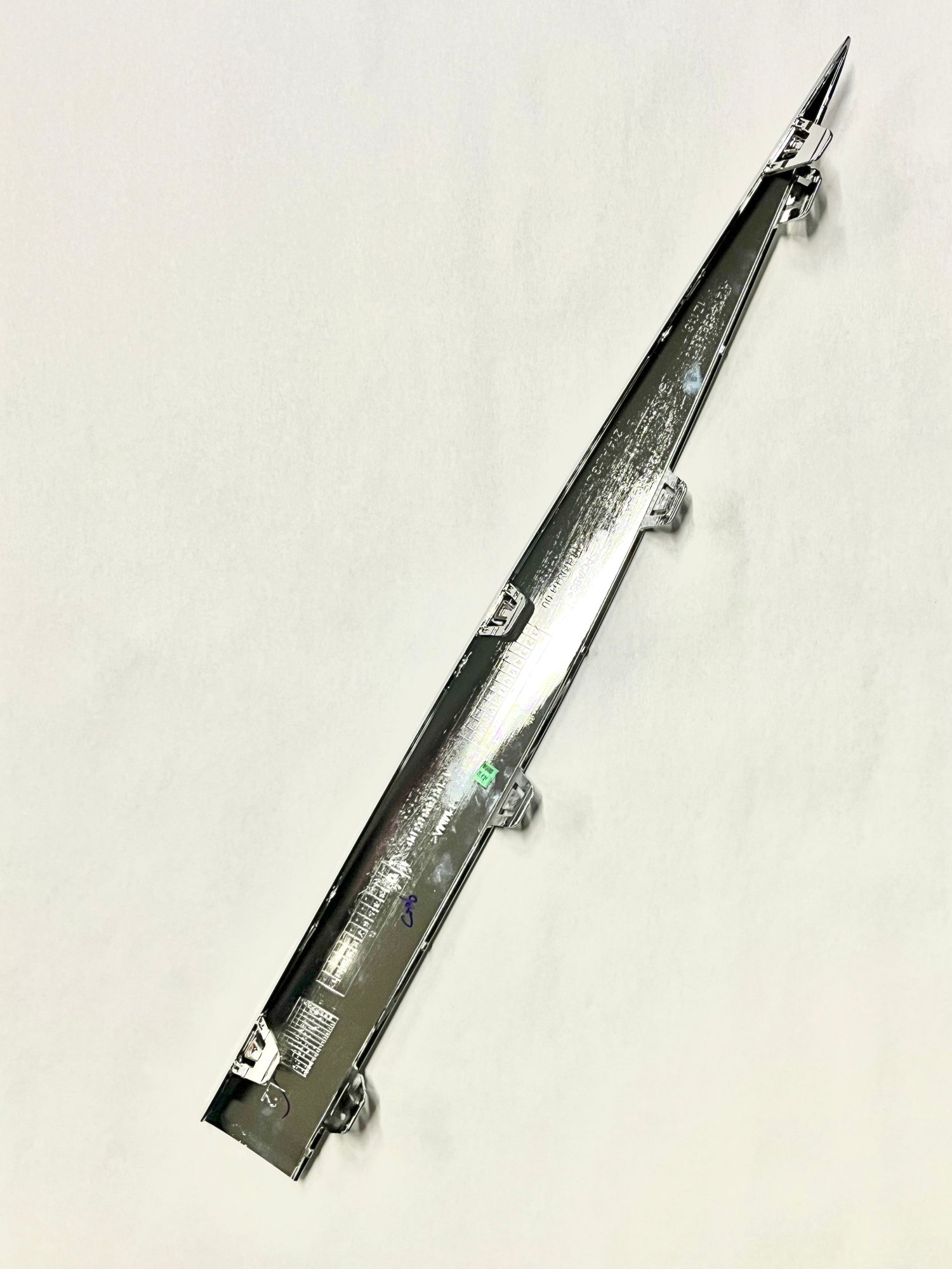

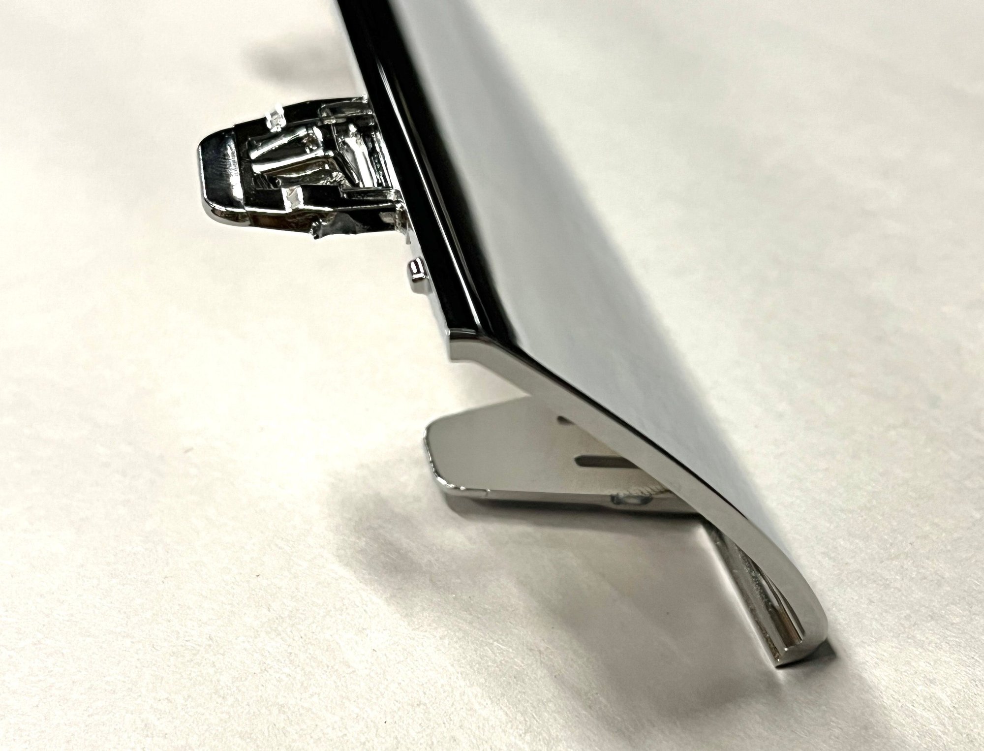

I purchased the left rear chrome trim piece for the W214 E53 in order to understand how the locking tabs secure it to side skirt. Here are a few photos that show the seven tabs, three along the lower edge and four on the top edge. The chrome strip is mounted at about a 45 degree angle, but the tabs are positioned to be inserted directly towards the center line of the car. Once I figure out how to release the tabs I will post more details.
W214 E53 side skirt trim 214-698-83-00 (left, rear)
End of trim that butts up against front left trim piece.

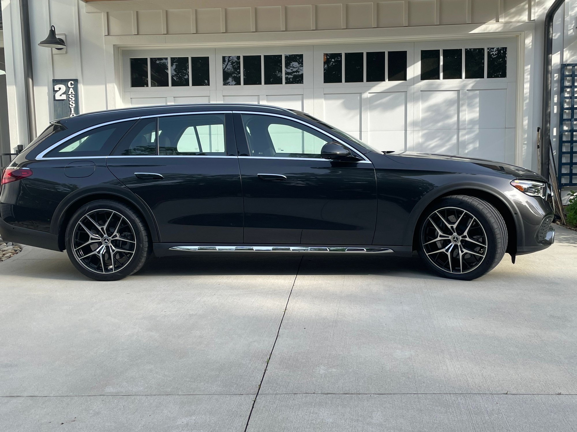

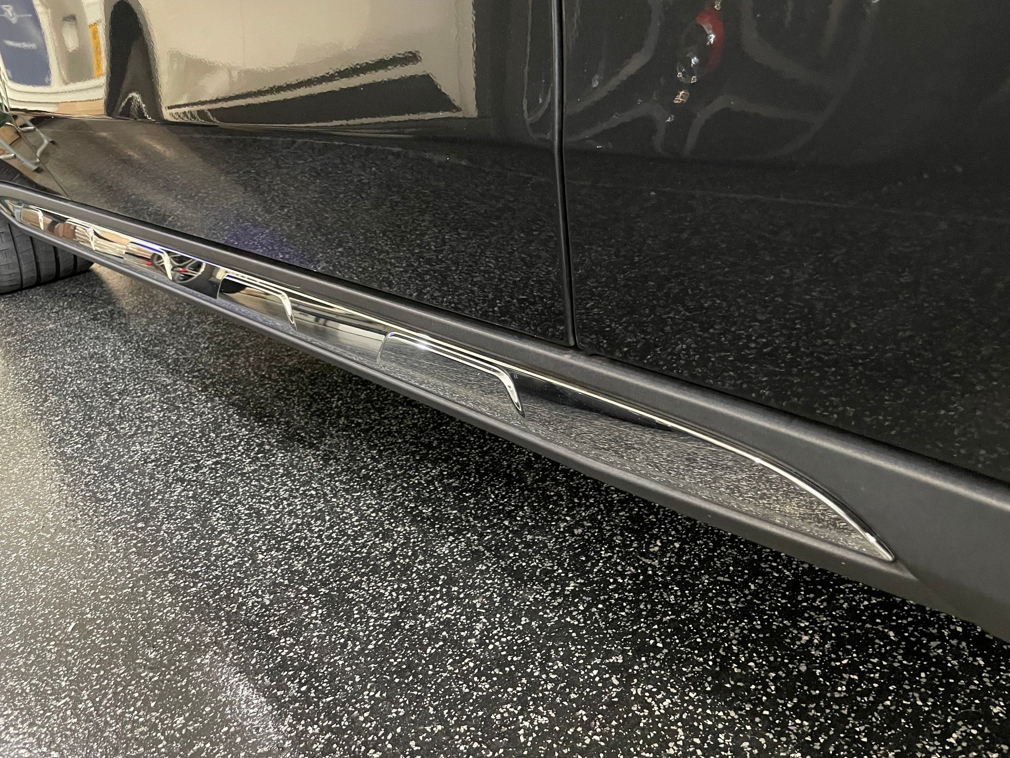

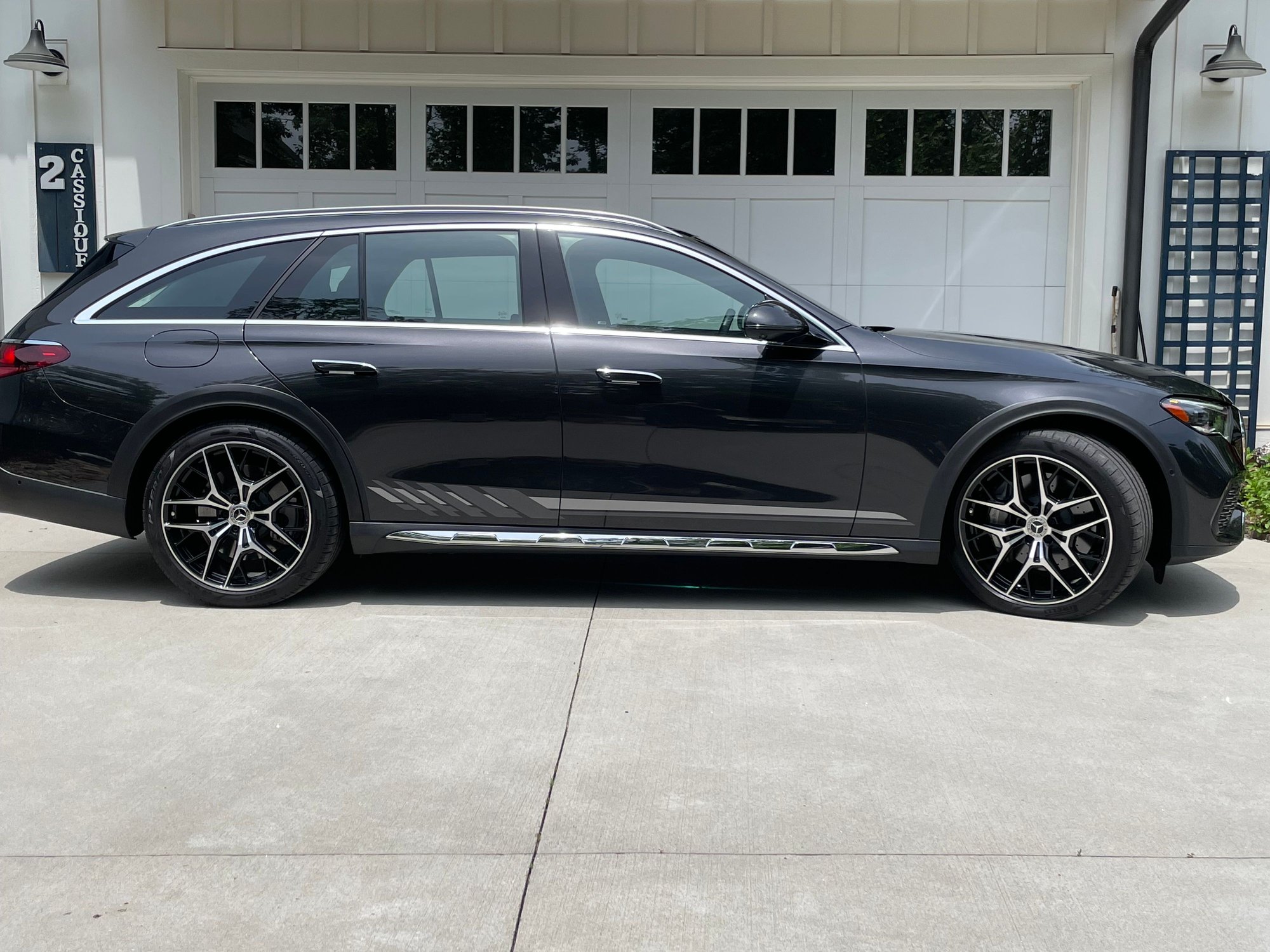

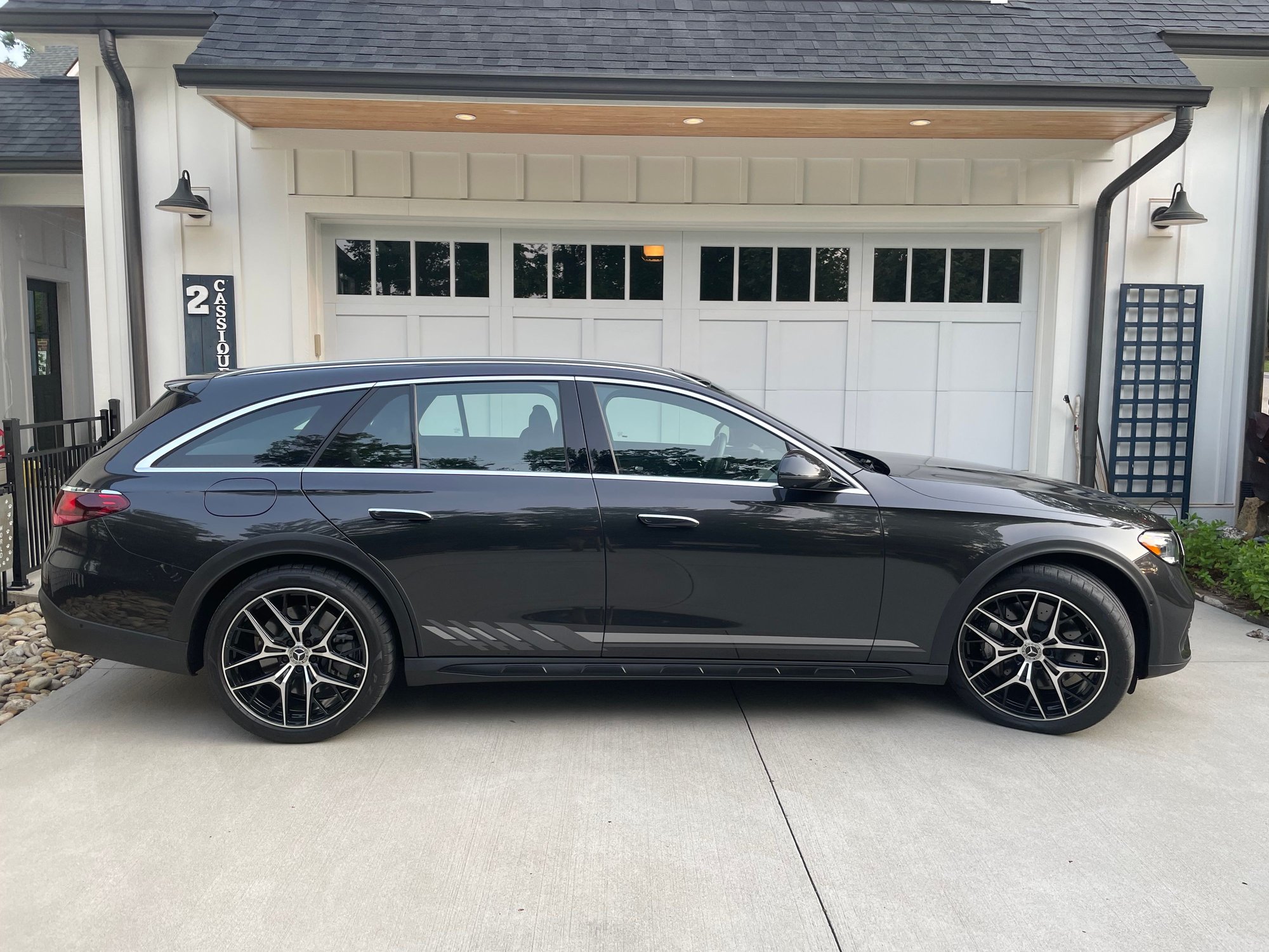

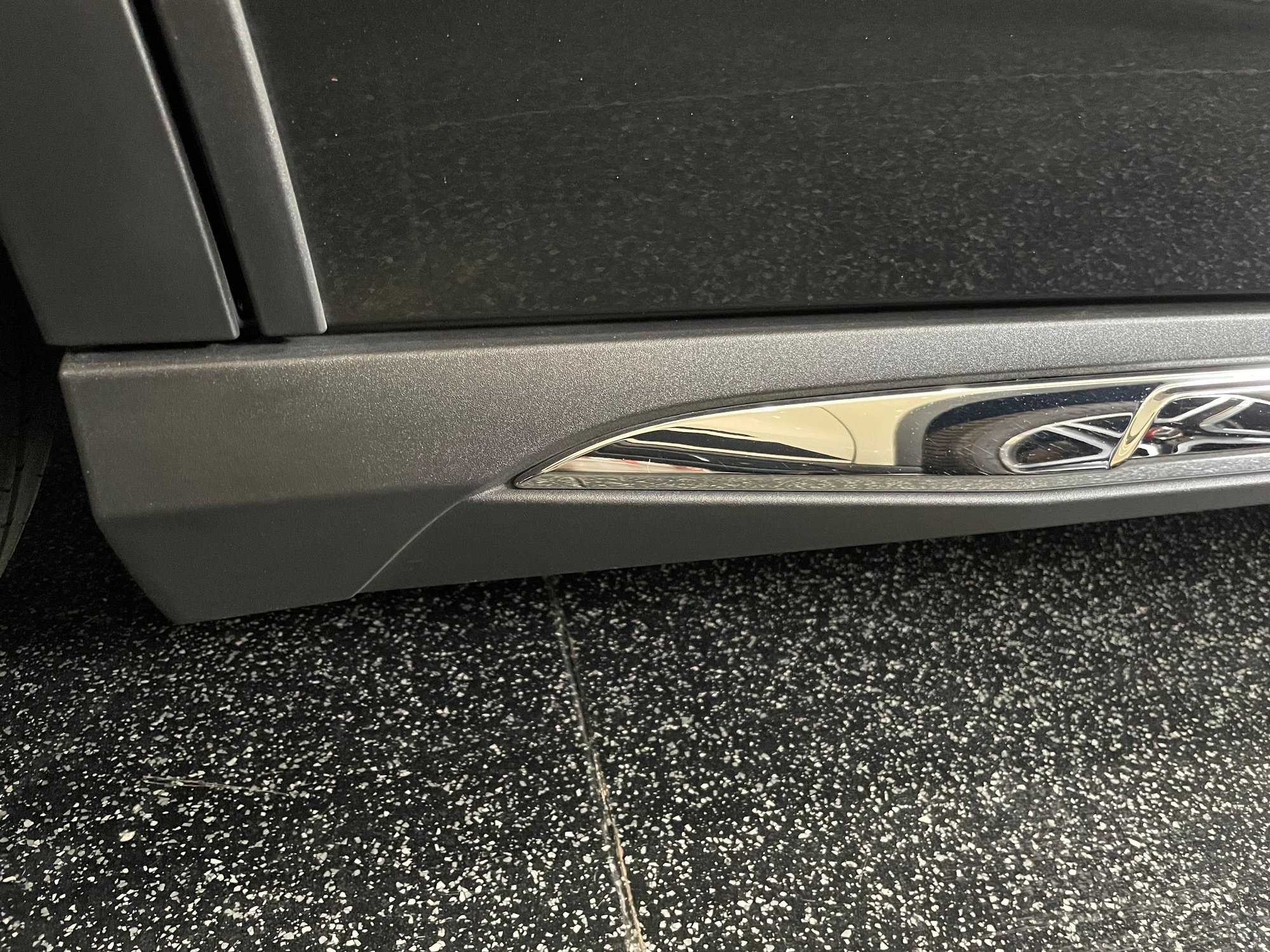

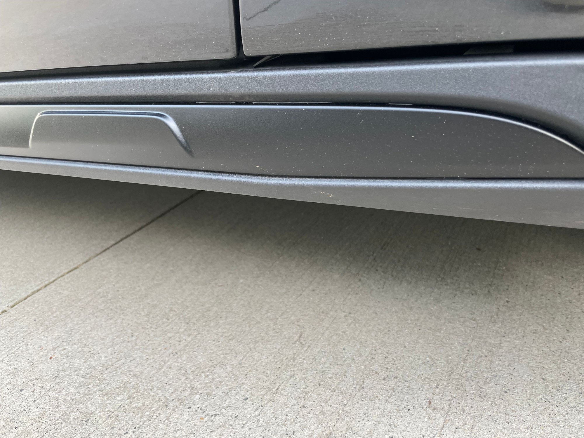

Old Jun 1, 2025 | 08:42 AM
dbrown167's Avatar
Joined: Mar 2021
Posts: 49
C117
Done. With the lower chrome trim wrapped your eye isn’t drawn to the lower portion of the car. But … now the lower chrome on the front and rear may need help too.
dB.
Finished(ish)
Finished(ish)
Matte vinyl
Matte vinyl
Original
Original
