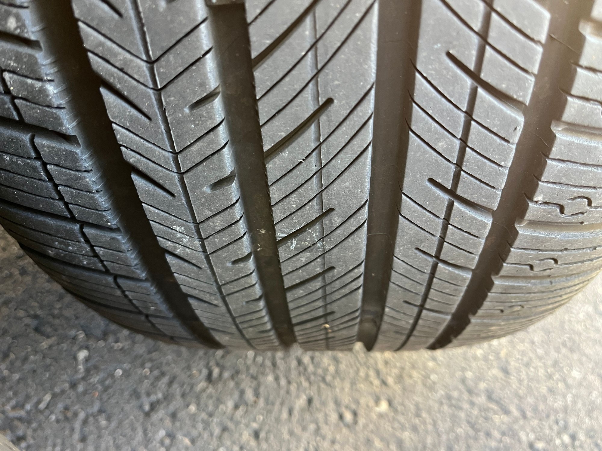

My W214 E53 is my ninth MB, but only the first AMG. I am not experiencing increased wear on the inside edge of the tires. After 13200 miles the front tires are wearing evenly across the tire with an 8/32 tread depth. The inside and outside outer treads of the rear tires measure 7/32. The inner tread on the tire that was on the passenger side for 7K miles measures 6/32. Originally the rear tires were inflated to 46 psi. I have reduced the cold pressure to 40 psi to improve ride quality and tread wear.
W214 E53 right front tire after 13.2K miles.

Thanks for the post. This is good news! I'm glad the E53 is not wearing the inside of the tire.
The tires should last longer with even wear. I also missed the worn inside tread multiple times, including once where I was close to the belts. I could see decent tread on the outside of the tire, not realizing that the inside was wearing quicker.
The E53 has decent tire options too.
