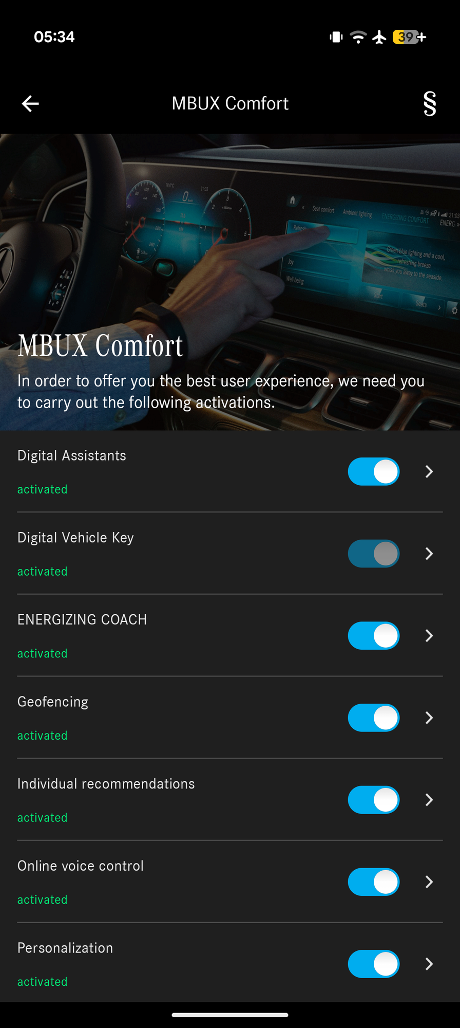

The issue I have is there is no Setup Digital Key option in the Mercedes app. I have all digital extras enabled, but in remote control all I have are three things which are lock status, remote start, and windows. My Mercedes app version is 3.64.0 and I'm on MBUX333.8-58. I assume the 3.3.3 version you mention is MBUX and therefore likely the same as mine. In any case, the process starts on the phone in the Mercedes app and my app does not have the option to setup a key.
I assume this is where you have an extra icon to setup a key?
I have the digital extra
And it describes it to where it's not the same as the remote lock/unlock which I can do.

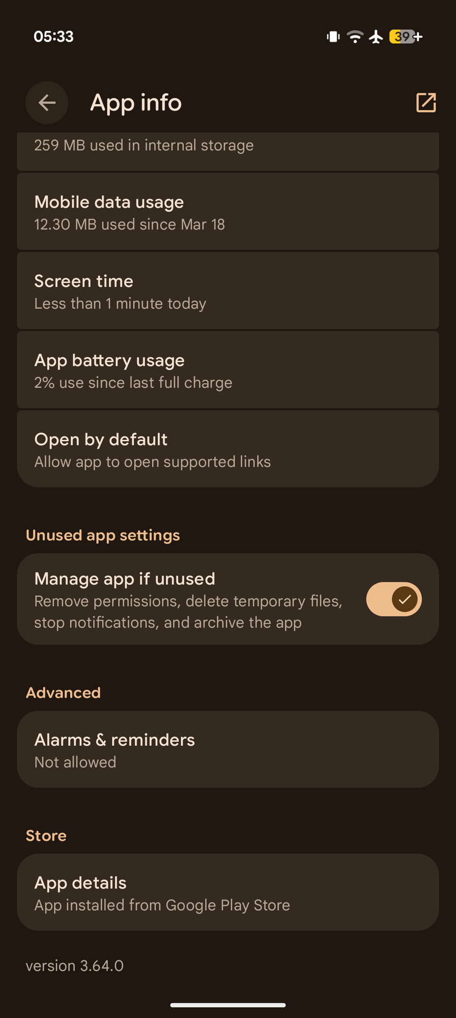

Yes same exact software version in car down to the digit, I also got the digital light system upgrade upon delivery and installed that. The Mercedes app is also the exact same version, although my phone is on Android 16 if that makes any difference. Try logging out and uninstalling the app then reinstalling in a fresh state. Not sure why, just like yours the digital key is blurred/dimmed out (compared to other mbux comfort features) but it is activated.

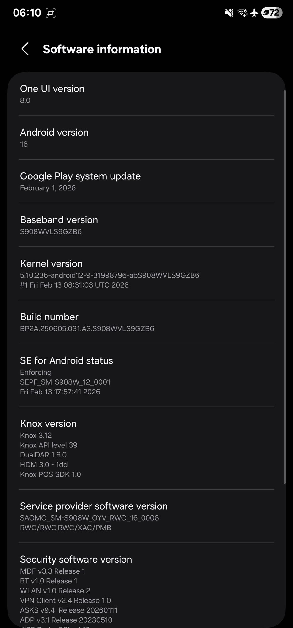

As mentioned earlier, it only talks about iPhone when you set it up but I am doing all this on an android now, I previously mentioned I switched from an older S22U to the pixel 9, just powered up my S22U same exact setup process but can't have both phones paired. Both Pixel and Samsung running Andriod 16. Both with UWB enabled. You can notice which screenshot is from which phone by the status bar icons.

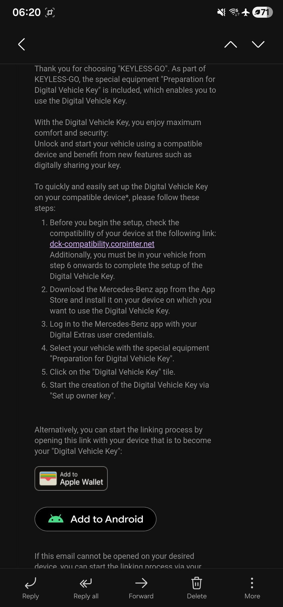

I also got this email.
Old Mar 19, 2026 | 06:24 AM
  #56
W205C43PFL's Avatar
Posts: 32,222
Likes: 6,281
Thank you for choosing "KEYLESS-GO". As part of KEYLESS-GO, the special equipment "Preparation for Digital Vehicle Key" is included, which enables you to use the Digital Vehicle Key.
With the Digital Vehicle Key, you enjoy maximum comfort and security:
Unlock and start your vehicle using a compatible device and benefit from new features such as digitally sharing your key.
To quickly and easily set up the Digital Vehicle Key on your compatible device*, please follow these steps:
Before you begin the setup, check the compatibility of your device at the following link:
dck-compatibility.corpinter.net
Additionally, you must be in your vehicle from step 6 onwards to complete the setup of the Digital Vehicle Key. Download the Mercedes-Benz app from the App Store and install it on your device on which you want to use the Digital Vehicle Key. Log in to the Mercedes-Benz app with your Digital Extras user credentials. Select your vehicle with the special equipment "Preparation for Digital Vehicle Key". Click on the "Digital Vehicle Key" tile. Start the creation of the Digital Vehicle Key via "Set up owner key".
If this email cannot be opened on your desired device, you can start the linking process via your vehicle. Start the linking process through the central control unit under
"Settings" > "Vehicle" > "Open/Close" > "Digital Vehicle Key" > "Set up owner key" and follow the instructions on the central control unit. If the device prompts you, enter the following code and place the device in the NFC charging cradle inside the vehicle.
Very strange. I'm on Android 16 on a Samsung S24 Ultra with UWB turned on. I got the same email you got about keyless go and digital key last August. I've logged out of the MB app, cleared cache, deleted data, and uninstalled/reinstalled the app. Still no option to setup the key in the app. I don't think it's a phone issue. More likely something messed up with my account. I may contact MBUSA to see if they can help, but I doubt they can.
