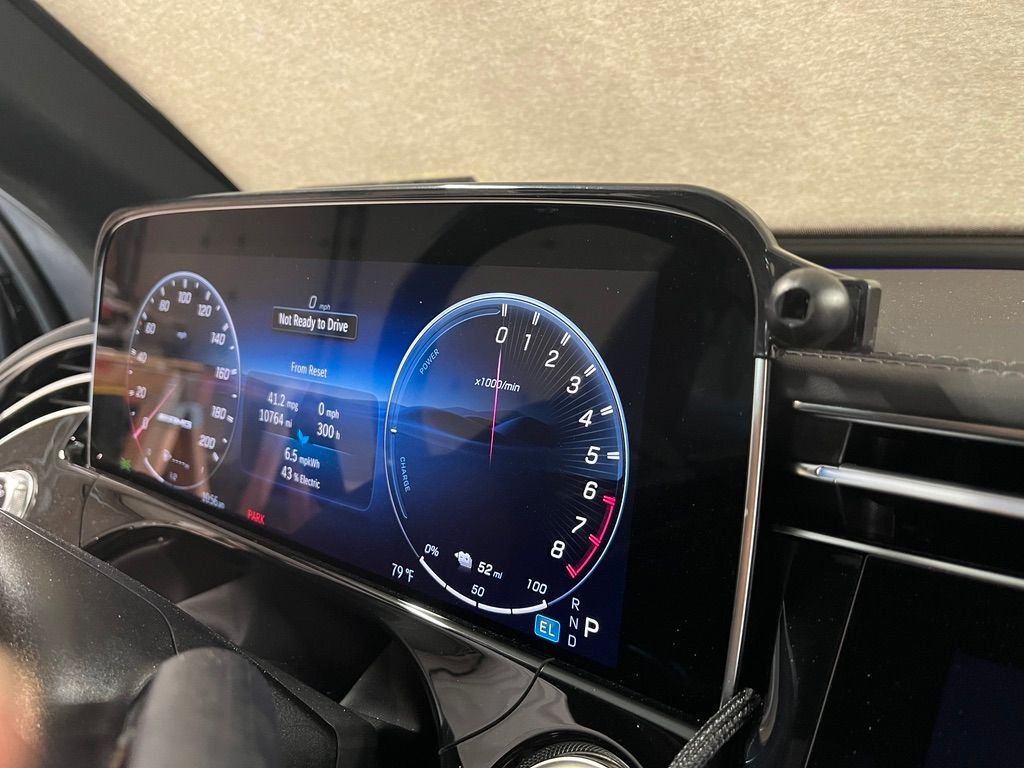

Several manufacturers supply model specific driver display phone mounts with prices ranging from $26 to $55. @L1Wolf referenced the FICS unit in the modified Proclip phone mount thread I started earlier this year.
Amazon Amazon
This particular driver display features a 17mm ball post on both the left and right side of the screen. I believe that the left ball post can be removed since it is not shown in one of the photos in the listing. This phone mount has one important feature that distinguishes it from competing products - it does not require double-sided adhesive tape to keep it in place. The videos in the Amazon listing show how the phone holder relies on a friction fit to install it allowing it to be easily removed. Unfortunately, the FICS mount for the W214 is not currently available.
The other available driver display phone mounts are usually secured in place with a strip of double-sided adhesive foam tape. This mounting method does not appeal to me since it complicates the removal of the driver display if necessary. I decided to try the Masergogo phone holder even though I don't really like the "wing" on the right side that allows the height of the ball post to be adjusted.
Amazon Amazon

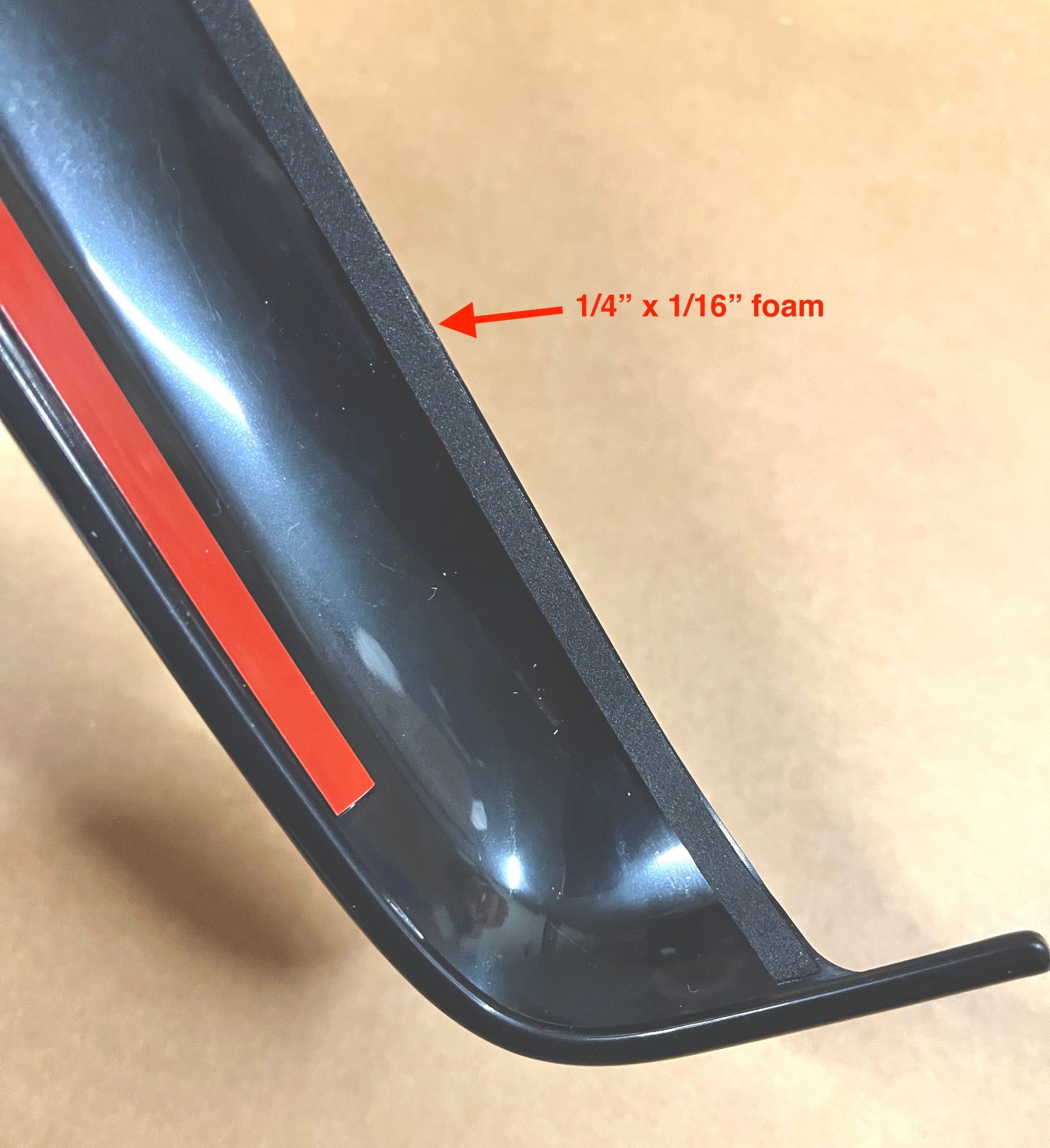

I added a strip of 1/4" wide by 1/16" thick foam (adhesive on one side) along the bottom inside edge of the mount to convert it to a friction fit unit. I did not remove the red plastic film from the double-sided adhesive tape supplied with the mount. I also discarded the adjustable phone holder and replaced it with the MagSafe holder. I plan to check out other driver display phone mounts with a fixed position ball post in hopes of finding one that looks better than the Masergogo one.
Massergogo driver display mount with MagSafe charger.
Masergogo driver display mount with MagSafe charger.
Added 1/4
Added 1/4" x 1/16" foam along lower edge.

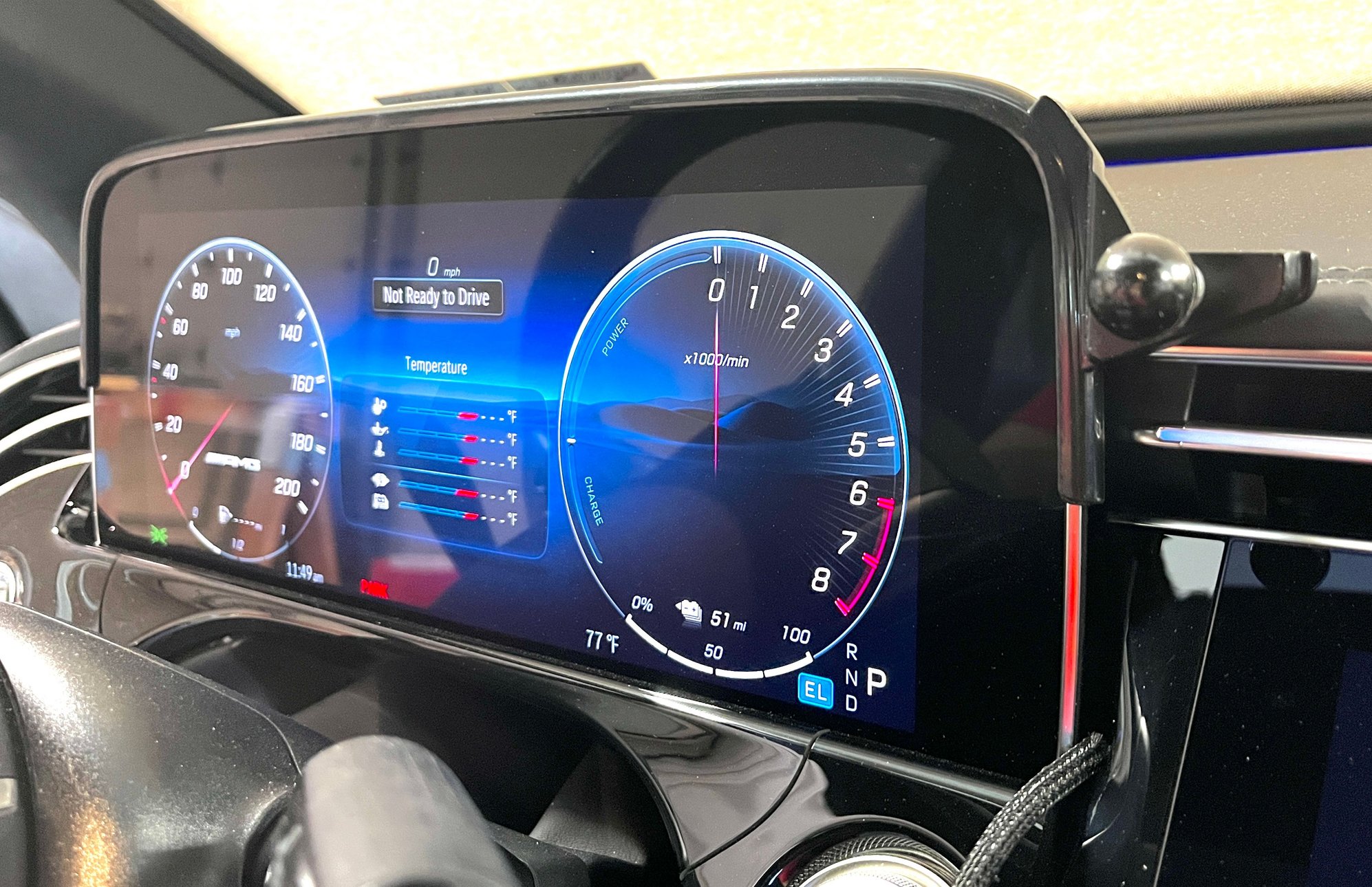

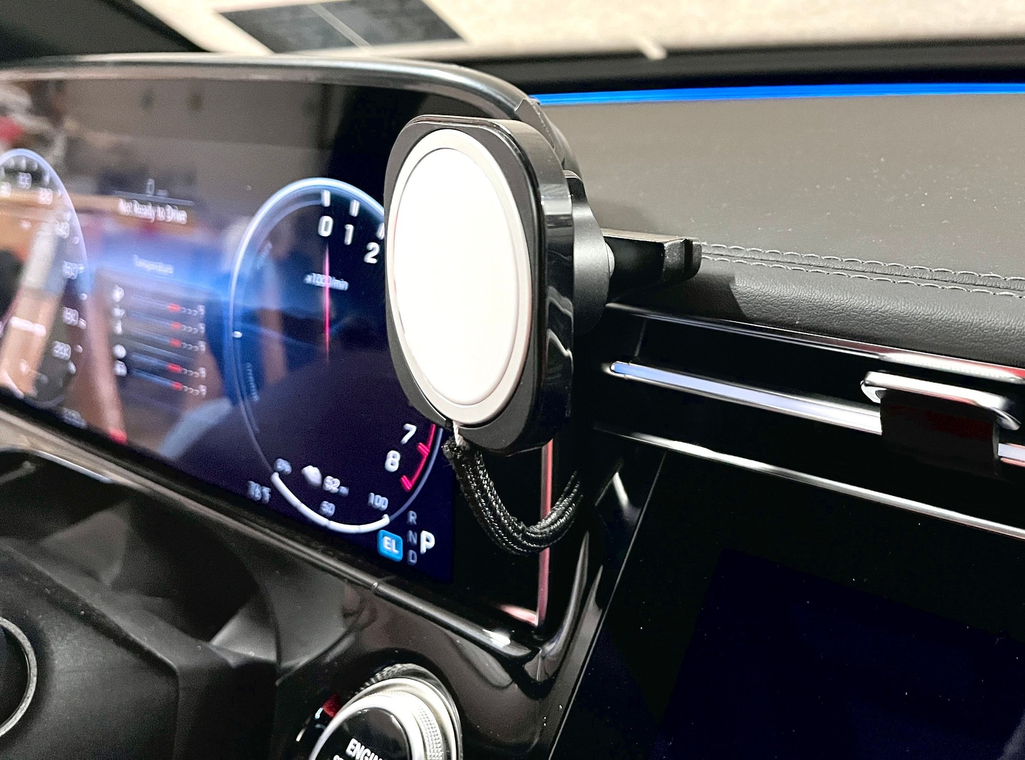

I modified the better fitting Masergogo phone holder to eliminate the oversized adjustable "ear" that I found objectionable. I used a Dremel tool, Xacto saw and mill file to remove the adjustable part of the phone holder.
17mm ball post mounted on modified phone holder.
MagSafe charger in place.
