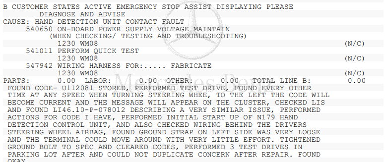

I had a similar issue. Initially I thought it was dead bugs messing up the sensors or the sun shining in the cameras, but it seemed to happen at random times even when the car was clean or night time. I finally brought it in for service. Turned out to be a bad connection under the steering wheel. Never had the problem since.

This was the service notes for my issue. When I looked up LI46.10-P-078012, I got the document attached to this post. Note, the dealership did not give this to me. I found it online.

To be clear, the image on my post was from the invoice the dealership provided for my service. The attached PDF was from an online search of the campaign number listed in my service information.
