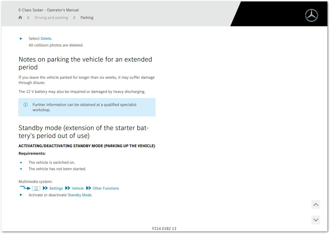

Originally Posted by L1Wolf
If your E-Class is a W214, there is no standby mode. I wouldn't worry about it sitting for a month, but you can put a battery tender on it. That's about all I would consider.
Not exactly. From the W214 Operator Manual
Go to Multimedia system:
Settings
Vehicle
Other Functions
Activate or deactivate Standby Mode.
Old Sep 4, 2025 | 01:13 PM
I'm not sure what W214 manual you are seeing this in, but I have PDF versions of the 2024 and 2025 W214 and the word "standby" is not found in either manual. It does show up in the online manual for the W214 here, but the function does not exist in my car or the 2024 lease I had. In fact, there is no "Other Functions" sub-menu in the Vehicle settings. What is interesting with the online manual is that it says the car must be on but not running to put it in standby mode. I thought, maybe it's only there if I turn it on but not start it. I just tried and it's not there no mater what combination of on I put the car in. I believe only some engine models (maybe the e versions such as the 300e) have this or it's only available in some markets. The vehicle menu has sub-menus for Driving, Comfort, Occupant Protection, Open/Close and DYNAMIC SELECT. There is nothing below DYNAMIC SELECT and standby mode is not shown in any of the sub-menus that are there. If the OP is in the US, my bet is he doesn't have standby mode in his W214 either. I'm happy to be wrong though. It's possible that the W214 does an automatic standby mode after being parked for so long.
Edit: I did find "Standby" in the 2025 manual. For some reason it took a while to complete the search. Below is a copy of the page which is exactly the same as what the online manual states however, it doesn't exist in my car. Again, perhaps it's only on some versions or markets. Or I'm doing it wrong, but I've tried with car off, with one press on start, two presses on start, and car running. I don't see the menu option.

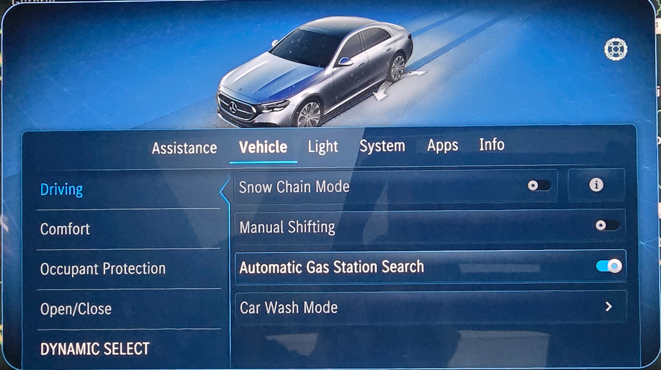

strange that my 2025 E450 doesn’t even have the car wash mode
Old Sep 6, 2025 | 09:51 AM
L1Wolf's Avatar
Veteran: Army
Joined: Aug 2014
Posts: 1,923
Likes: 672
From: Tennessee
W214 E450
Have you received the MBUX E333.8-58 software update? It comes with that update.

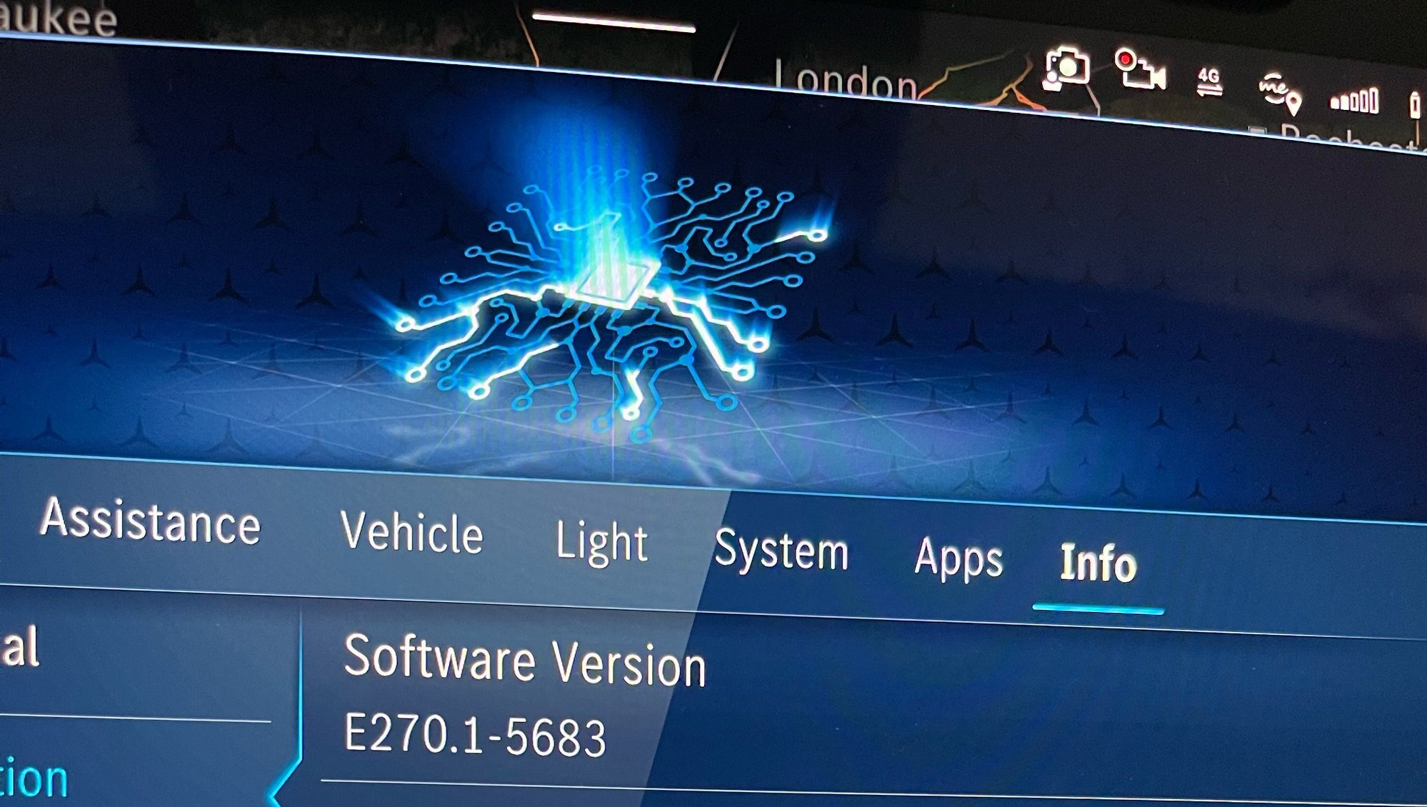

Old Sep 6, 2025 | 12:51 PM
cjc52315's Avatar
Joined: Dec 2023
Posts: 43
Likes: 19
2024 GLC300 2025 E450
I have an ancient version
Old Sep 6, 2025 | 03:53 PM
L1Wolf's Avatar
Veteran: Army
Joined: Aug 2014
Posts: 1,923
Likes: 672
From: Tennessee
W214 E450
It's not ancient, but it's not the latest. It can only be done at the dealership. See the following thread for details.
https://mbworld.org/forums/e-class-w...e-changes.html
Old Sep 6, 2025 | 09:57 PM
Roweraay's Avatar
Joined: Oct 2022
Posts: 949
Likes: 355
X214
That is exactly what I have on mine. And since nothing is broken, I don't want to do any more updates, unless there's something really compelling.
