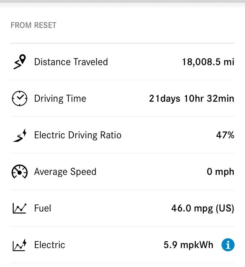

At 18000 miles over the past 10 months, I have one of the higher mileage W214 E53s on the road. The stats reported in the app Trip Data “From Reset” section are as follows:
- Distance Traveled: 18008 miles
- Electric Driving Ratio: 47%
- Fuel: 46.0 mpg
- Electric: 5.9 mpkWh
The actual mpg and mpkWh can be approximated by estimating the actual miles driven in each mode.
53% of 18008 equals 9544 gas powered miles. The remaining 47%, or 8464 miles, is the estimated amount driven on the HV battery.
18008 miles divided by 46.0 mpg equals 391.5 gallons of fuel. Dividing the 9544 miles by 391.5 gallons equals 24.4 mpg which is reasonable when compared to the combined EPA 23 mpg estimate shown on the window sticker.
18008 miles divided by 5.9 mpkWh equals 3052 kWh. Dividing the 8464 miles 3052 kWh indicates an average 2.77 mpkWh. This is somewhat surprising since driving locally in EL mode, mostly in 4th gear, usually reports an mpkWh between 1.6 and 2.5 driving depending upon the temperature. I think the higher than expected mpkWh for battery powered miles can be attributed to some kWh added by recuperation as well as a portion of the electrical miles being driven in 7th, 8th, and 9th gears.
Most of the HV battery charging occurred at home and at hotel destination chargers. Very little charging was done at DC chargers since the cost per kWh is more than the cost of gasoline per mile. The inability to charge the E53 at non-MagicDock Tesla Superchargers also factored into the minimal amount of DC charging while on road trips in lesser traveled areas not serviced by EA.

I think there is a valid reason why the EV miles seem worse and the gas miles seem better. The math does not account for all the idle time when in gas mode, ie. even during the gas driven miles the idle time at red lights and aux consumption while waiting in the car etc. will use electric power. So the EV usage has 18k miles worth of idling in it while the gas miles have none, it merely has the miles driven on fuel as if you never came to a complete stop and sat the car idle.
Regardless of this, I think the numbers are really decent. I just drove my Audi RS etron GT on a long distance trip and averaged 2.5 mile/kWh (I prefer to use the 40 kWh/100 mile representation) so yours is very much in line with that. I can get it much closer to 3.3 mile/kWh in the spring and when I only drive city streets at low speed and not highway at 85 mph.
My daughter's GLC 350e has 507 mpg and 2.5 mpkWh over 4,100 miles since reset at 95% EV ratio. BTW to get the proper values you don't need to do all that mileage math, just multiply the MPG values with the percentage ie. 46 mpg * 53% = 24.38 mpg in your case. In my daughter's case it comes out to 2.375 mpkWh and 25.35 mpg which makes sense, she sure loves to sit in her car and chat with her friends ;-).

I don't agree that idle time at stop lights adversely impacts mpkWh since it is a measure of distance per unit of power not time.

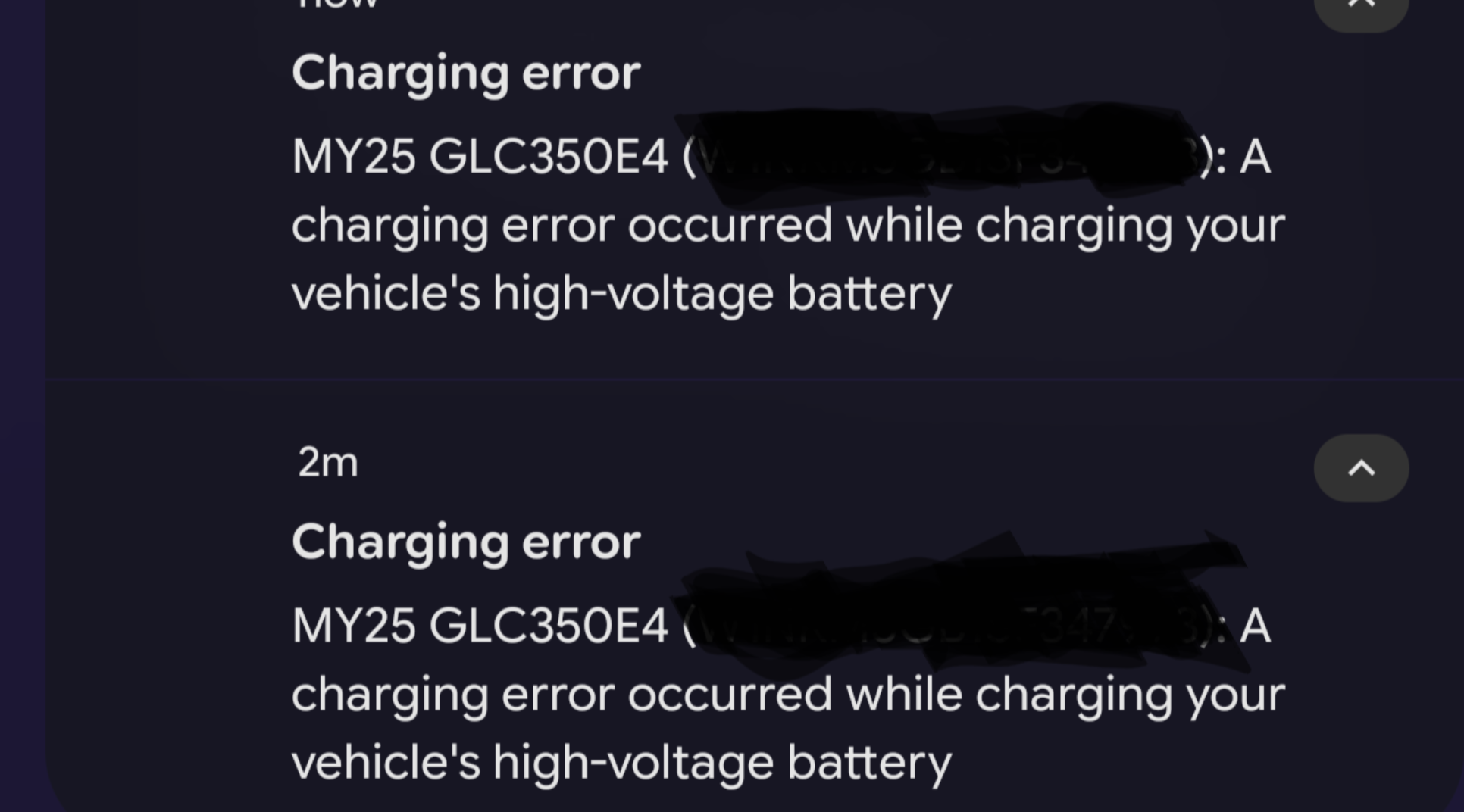

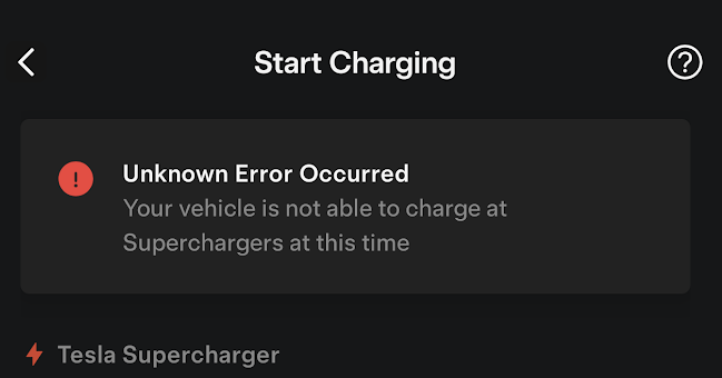

I tried this morning at a regular Supercharger with the Audi branded NACS to CCS on my daughter's car and I failed to charge. Looks like MB PHEVs are not ready to use the Tesla superchargers.
