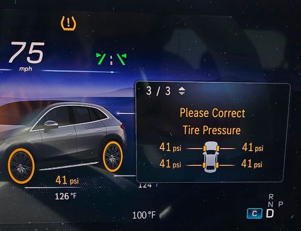

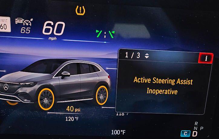

My Mercedes is requesting I correct tire pressures and it has informed me that active steering assist is inoperative and active emergency stop is currently unavailable. I just wanted to go on a little road trip this afternoon to test consumption when it's 100F outside (308 wh/mi at 55 MPH in comfort mode with a/c blasting, by the way):
Door sticker says 41 psi. Only way I can correct the algorithm that someone at Mercedes wrote that triggers a pressure warning when pressures are correct is by trading my EQE in at a Porsche dealer. I also can't correct a low 12V battery when opening the hood is not permitted. And if the car needs to be towed to a dealer the do not tow message is less than helpful.
Someone need to be fired. This is just plain fookin' stoopid to the point of being ridiculous.

In the assist menu, just hit enter to reset it. It should make all the warnings go away. Tire pressure should be around 41 and 42.

Your dealer or some other place probably reset the tire monitor to a pressure too high. Simply set the pressure to whatever you want and hit OK on that screen. All will be fine.

It was fine when I left home. It became not fine half way through my trip. Nobody reset anything.
EDIT: Just checked after letting it cool down and they're all at 38 psi. Anywho, I did like you said and reset the value and light went off. Feels like it's one thing after another tho...

I've noticed that if it's set originally at the wrong threshold, over time and with changing outdoor temps it'll eventually reach the TMPS-7 PSI pressure, triggering the warning. Once that comes on, the car shuts off all ADAS for safety reasons.

No big deal. Whoever did the PDI stored higher pressures in the system, or didn't reset it after adjusting the pressures. Cars typically ship with the tires overinflated and then during PDI the pressure gets adjusted. Whoever does the PDI is supposed to store the correct reference pressures at that point. Looks like that wasn't done. The ADAS systems disable if TPMS goes off. It's mentioned in the owner's manual, so that's also nothing to get worked up about.

Yes, software engineering has become very important. As important or maybe even more than the mechanical engineering part of the vehicle. So if Mercedes believes there's nothing wrong with triggering an alert at 41 psi when the setting is 41 psi and when it's always been 41 psi then it's time for me to move on. Tesla makes great software. The mechanical part, meh, not so great but they're improving and getting better rather than denying problems and maintaining the corporate status quo.
The last screen might have been my fault actually. It's fixed now, for the time being (I might have to uninstall Intel Unison).

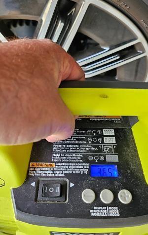

My poor little Ryobi air pump is recovering from inflating the first tire to 40 psi. It needs about 15 mines to cool down before I can do the second one. Anywho, I guess in about an hour or so I'll set the default pressure to that from the current 38. Still doesn't change the fact that the warning was trigger at the highest pressure (and temp, as shown in picture) not the lowest like every other TPMS on the planet. That just plain ain't right.

Here a picture before I inflated the last tire showing 36.5 psi... someone please explain to me how I could have accidentally reset the default while driving that would result in a warning. If it had been set to 41 as I claim then it should have triggered a low pressure warning when I left not an hour into my drive. And if I reset it while driving the pressure would have been lower than 41 but more than 37 so there's just no way it could have accidentally happened. It seems obvious to me that there's some bad programing here and the only thing I can think of is it stores the pressure and temp when you reset, not just pressure, and then tries to calculate what the pressure should be as the temp goes up or down.
Anywhosies, I'm done, as is my Ryobi which has served me well for five years. I think they quit making these too. :cry:
Yes, the tire pressure threshold is in relation to the temperature.
