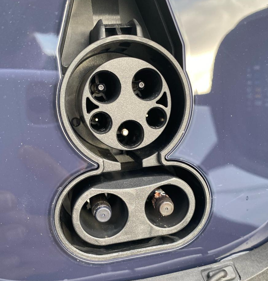

My wife was charging yesterday at EA (notorious for being inoperative) and received an error message in the car just after 3 minutes of charging. The EA charger also displayed that an error had occurred. She was unable to unplug the charger (after pressing the unlatch button). She called EA and they suggested using the remote unlock button 3 times, which was unsuccessful. The next suggestion was to press the unlatch button near the charger flap 3 times, which finally released the charger. After pulling out the charger my wife noticed damage to the charge port (burned/singed). The EA representative suggested that my wife plug in the charger again, which my wife refused. Fortunately, MB was just around the corner where she left the car overnight. They had not seen this type of damage before. My wife opened a case with EA as well. We still don't know how long it will take for the repair or who will cover the cost. Has anyone else experienced this?
The continued poor experience with EA charging has left a bad taste with my wife and she is nervous of driving the EQE again, to the point of potentially returning/selling the car.
Singed charge port

Very sorry to hear this happened to your wife. It looks like an arc fault at the charge port, likely some catastrophic defect or failure of the charger cable connector. Arc faults, though extremely rare with EV charging infrastructure, can be very damaging to a number of components. I'd say it is pretty rare, and though it's super unsettling, I think it would be pretty unlikely to happen again. EA has gone from quite unreliable to almost perfect where we are. Regardless, there are more providers coming, and fast. Things will be getting better overall soon, especially as NEVI money starts to bear out. My best wishes for the car's repair. Please keep us posted. If you or your wife would like any additional feedback from us, including technical perspectives, we're happy to help.

Also, were any warning indicators coming up on the instrument cluster? Was she able to drive it to the dealership? If no remnant warnings, and it was able to drive, then the car behaved exactly as it should have and you might have avoided damage. CCS connector will need replacement, but car may well be in perfect shape.
No indications on the car and she was able to drive the car normally. When the MB technician went to visit the EA charger the next day, it was relayed to me that there other patrons that commented on their uneasiness from past experience of using the specific charger that caused the damage. I was actually surprised that I haven't read anything on this forum about similar experiences and arcing must be rare.
Just curious, is arcing in this scenario always one way, where the charger thinks the car is ready accept the charge when it actually isn't? Or can the car cause the arcing, where the charging station is not providing any power, and the car itself (say from the battery) causes the arc at charging port?

Glad to hear there is no internal damage. The arc is from the charger to the car, most likely a physical defect in the EA connector that shifted during charge. If the car isn't ready for charge, the contactors are open and there'd be nothing to arc to, no potential difference. Once the contactors are closed, the battery is exposed, so if it happened during charge, it almost certainly was a faulty physical connector. Once MB replaces your CCS port, you should be good to go.

Wanted to provide an update. Mercedes replaced the charge port ($1124) and I was able to successfully charge at EA (different location). A rep from Electrify America called my wife regarding her case and will reimburse us for the repairs.

That's great news! And confirms that it was isolated to just the charge port, which we had hoped. Looks like most of the systems worked to prevent damage, also good news. Let's hope your future charging experiences are much better!
