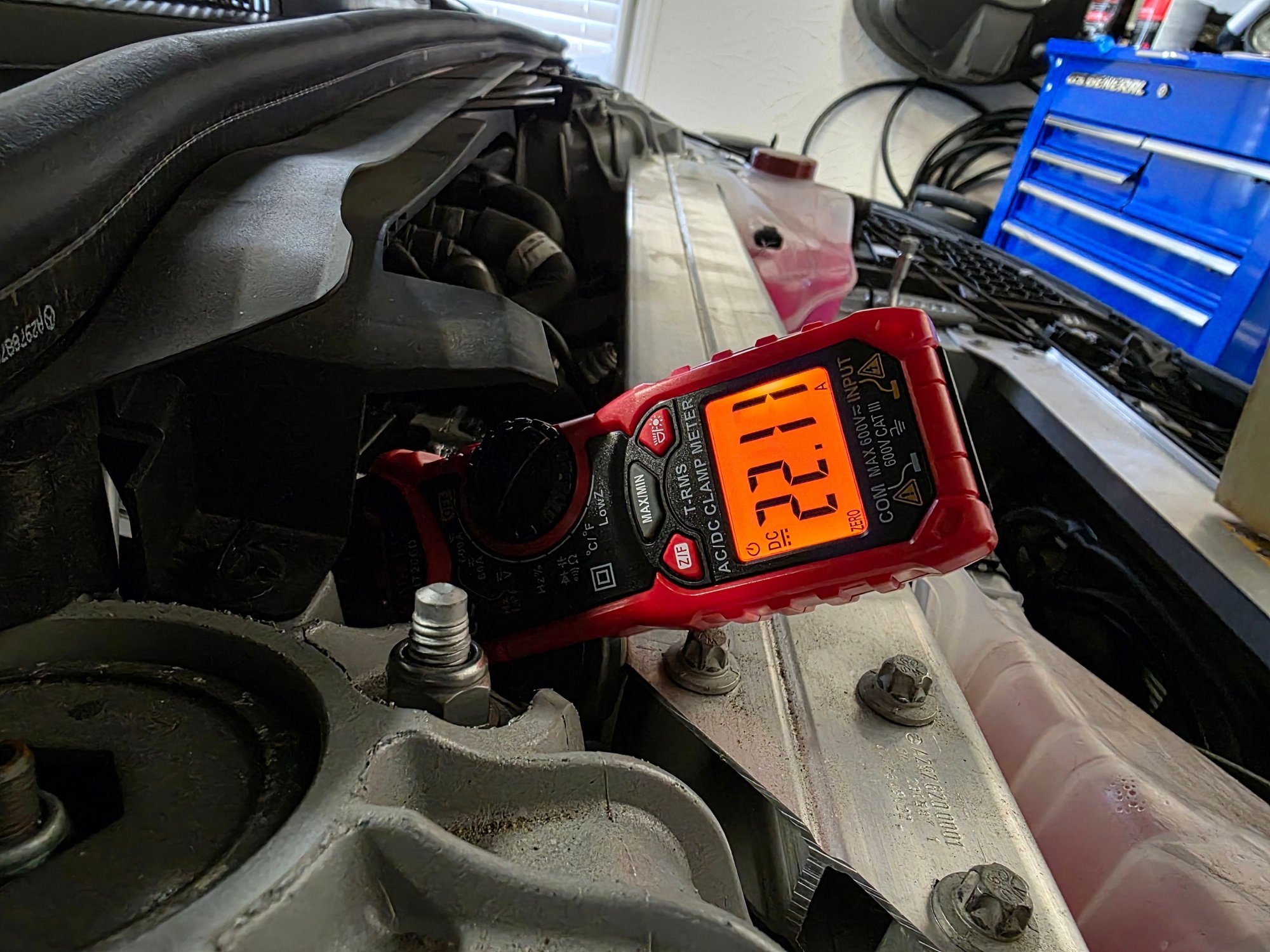

Opened the hood and locked the car. Immediately upon testing, I can see 22A headed to the 12V battery. It's charging at 300W. I'm documenting with photos. Once the charging stops, hopefully in an hour or so, I will check to see what the discharge rate is. If it's low, then I got a bad replacement 12V battery, or there's some mysterious huge drain happening at weird times of the car being locked. Will post back soon!

I made an error in post 53. The 22A is consumption, *not* DC/DC charging. I wasn't paying attention to the polarity of the clamp DC ammeter. This is battery discharge! 300W when the car is unlocked. It quickly drops down to 0.1A in about 2-3 minutes. When you approach the car and the handles retract, boom, 23A again. So the car consumes 300W from the 12V battery any time it "wakes up."
When it's just consuming 90-100mA, battery voltage was 12.6V. Perfect. However, when it's consuming 22A, the battery voltage drops to 11.9V. Even when it's just consuming 1A, the voltage is significantly lower. I haven't seen *any* charging of the 12V battery yet, only consumption. I'm going to build a voltage logger so I can clearly graph when the battery is being charged. I suspect that somehow voltage is dropping too low, and quickly. Maybe they did get me a bad 12V battery, I'm starting to think.

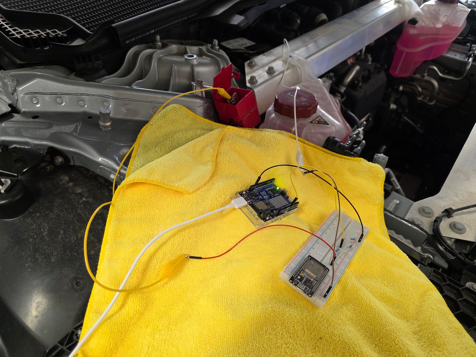

Okay. I built a voltage logger. Extremely simple, using an Arduino Uno R4 (the Renesas MCU has a nice ADC built in), a voltage divider, and a computer with a very basic Python script polling every 5 seconds. It'll save the data to a CSV that I'll share as a plot here later. I noticed that my 12V battery voltage was at 12.45 volts this morning - virtually unchanged from last night despite a continuous 100-130mA draw. The HV battery voltage was about one percent lower. I can't confirm that it charged the 12V last night, and it may in fact never do so unless the car is on or being charged. I took samples for a minute, then plugged in the car to charge. Voltage goes up to 14.83 or so, and current into the 12V battery (I double-checked polarity this time, lol), is 22.7A, so it's charging at about 335W into the battery while the charge cable is connected. I'll leave it for about 24 hours to see if the voltage ever increases again - that'd be a sign that the DC-DC converter is kicking in overnight to charge the battery. I'm guessing total DC/DC converter capacity is about 700W, as the car draws about 300W to operate and is charging the battery at 335W.
If I don't see a voltage increase in the plot during the 24-hour period, it means the HV battery is draining due to a different reason. If it doesn't charge the 12V battery overnight and I don't see a further drain, it may just be that the new 12V battery need a bit of a break-in period. We'll see. Pics below of the voltage logger and 12V charging current.
Please don't make fun of my ad-hoc setup, I'm just trying to avoid anything +12V from touching anything else, lol.
22.7A charging of the 12V battery while plugged in.
Output from the data logger, which will be stored to a CSV. You can see when I plugged the car in, as it went from 12.45V to 14.83V.
More details to follow!

Okay, some by-the-minute further intel. The moment the HV battery stops charging, the 12V battery voltage drops. This indicates that the DC-DC converter has turned off. And, I went to measure current, and this is the case. For about a minute, 1.75A was coming from the 12V battery, meaning it's now being used to power the car's systems. That current quickly dropped then to 380mA, and then will continue to drop to idle state of about 100-130mA continuous. The 12V battery voltage is now 12.91V, indicating a full charge. Which happened fast! I guess if you dump 300W into the 12V battery, it tops off pretty quickly. I'm starting to suspect that the DC-DC converter is not coming on at night, and not charging the 12V battery. I'll confirm with the logger in 24 hours, but if this is the case, then the HV battery drain comes from somewhere else. We'll see!
