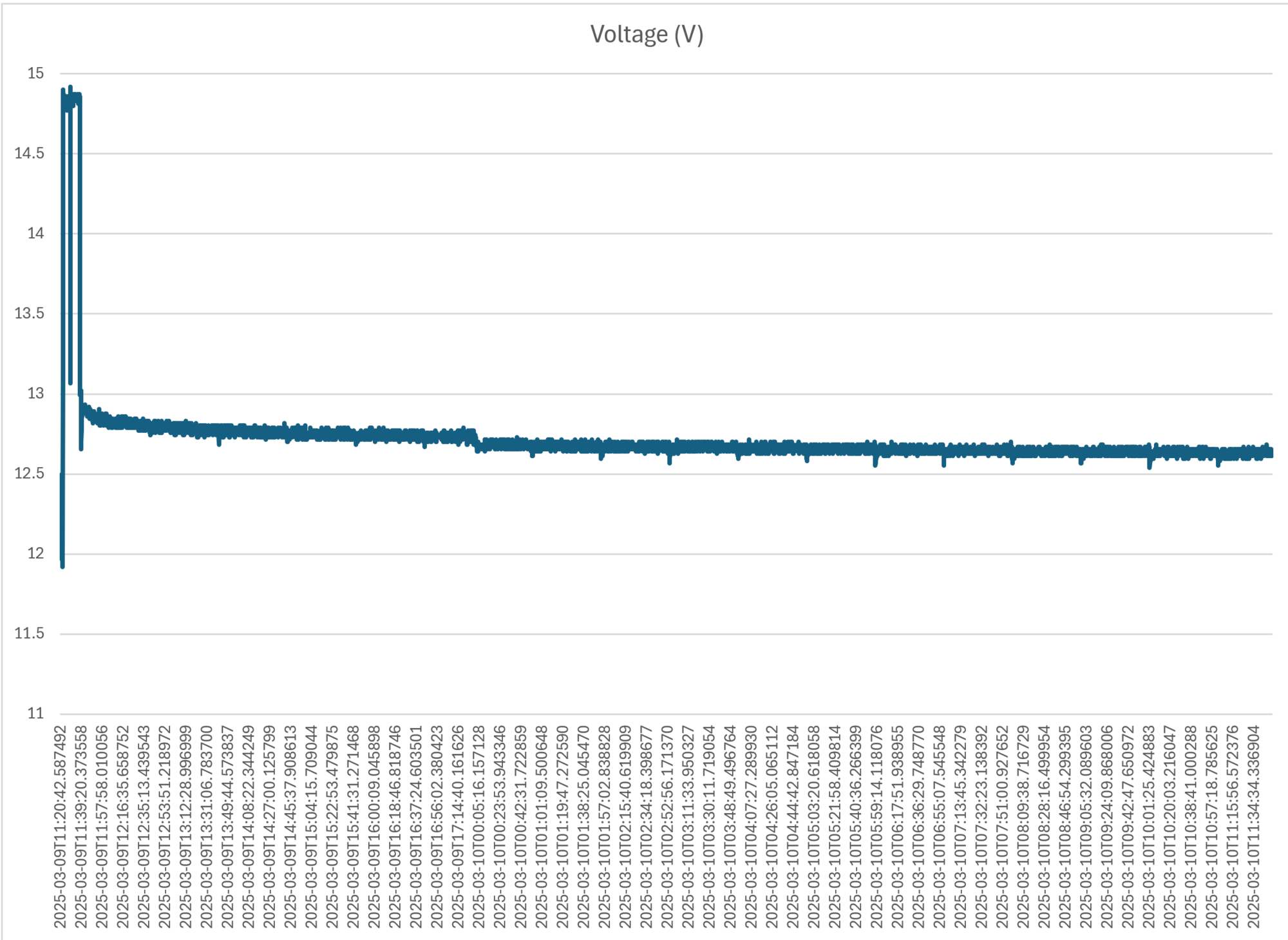

For those wanting the graph, here it is. You can see the initial charge a few minutes after the logging started. The charging took about 18 minutes or so. Note there is a strange dip about a third of the way in - that's where my logging computer decided it needed to turn off. No idea why. Missed about 30 minutes of logging. But it should be pretty close.

Okay. 24-hour update. The 12V battery is fine. It is at about 12.64 volts this morning, which is basically still fully-charged. However, the HV battery is down to 78% again after 24 hours. The graph shows that absolutely no DC-DC charging is going on during the 24-hour period. Just the one charge cycle when I plugged it in, and then a very flat discharge curve for 24 hours. The 12V is never charged on its own, and at this point given the discharge curve, I'm confident that the 12V battery is not the issue at all now.
This brings me to an uncomfortable thought, which @ScottC2 has already raised, that it could be an issue internal to the HV battery. Specifically, a cell that is failing or not staying up to pack voltage, that the BMS is trying to balance over and over. In addition to the annoyance of losing a lot of charge, it raises significant safety concerns. There were two EQE fires, after all, and it's entirely possible this is a reason for it. Perhaps the affected cell(s) aren't really that below spec, but losing 1.5 kWh in a balancing attempt every day is far too much. I'm going to escalate this now with my dealership, and will bring them the information showing them that the 12V battery is totally fine and not part of the equation. Hopefully it's just something silly that's not shutting off and is currently sapping power from the HV battery, but I am very concerned it's loss due to balancing, which isn't a good place to be in. I'll update once I've had a chance to talk to the shop foreman, who is 100% on the ball here in Louisville.
Sorry to hear that , I hope its something silly too, otherwise it shouldnt be overlooked and quite serious as you said, only another low possibility idea left for me is the tyre pressure being affected by the cold weather , I read somewhere system shutdown some services if tyre pressure out of window range, maybe it triggers some software bug car thinks its idle long time but I can not think anything where would drain go then. Today I lowered my tyre pressure to 41-43 (it was only 3-4 psi higher after trip), reset the range(s) on driver display, disconnected ssd, shutdown mbux manually and will monitor again. I check there was no wifi or bluetooth signal from mbux after lockdown.

One question that does come to mind is whether or not we have active or passive BMS. In other words, can the BMS actually balance the cells without being under charge? It seems that with just open circuit voltage, it may be tricky to bring a cell up to charge using the rest of the pack, though I could be wrong on that. I do wonder if I should do a 100% charge for a while at some point to see if it'll top-balance, and then drive it down to sub-20. The problem is, the drain just keeps going, so something has to be going on that is active. I don't think it's just a calibration issue.
