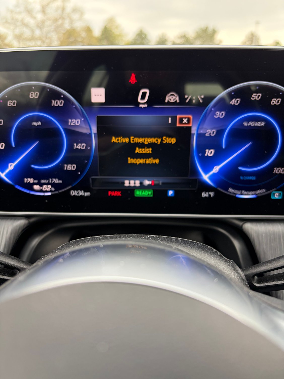

Getting auto stop is disengaged and then error saying it’s no longer available. Any help? Have service set for next week.

Any chance you have a photo of the error so we can assist?

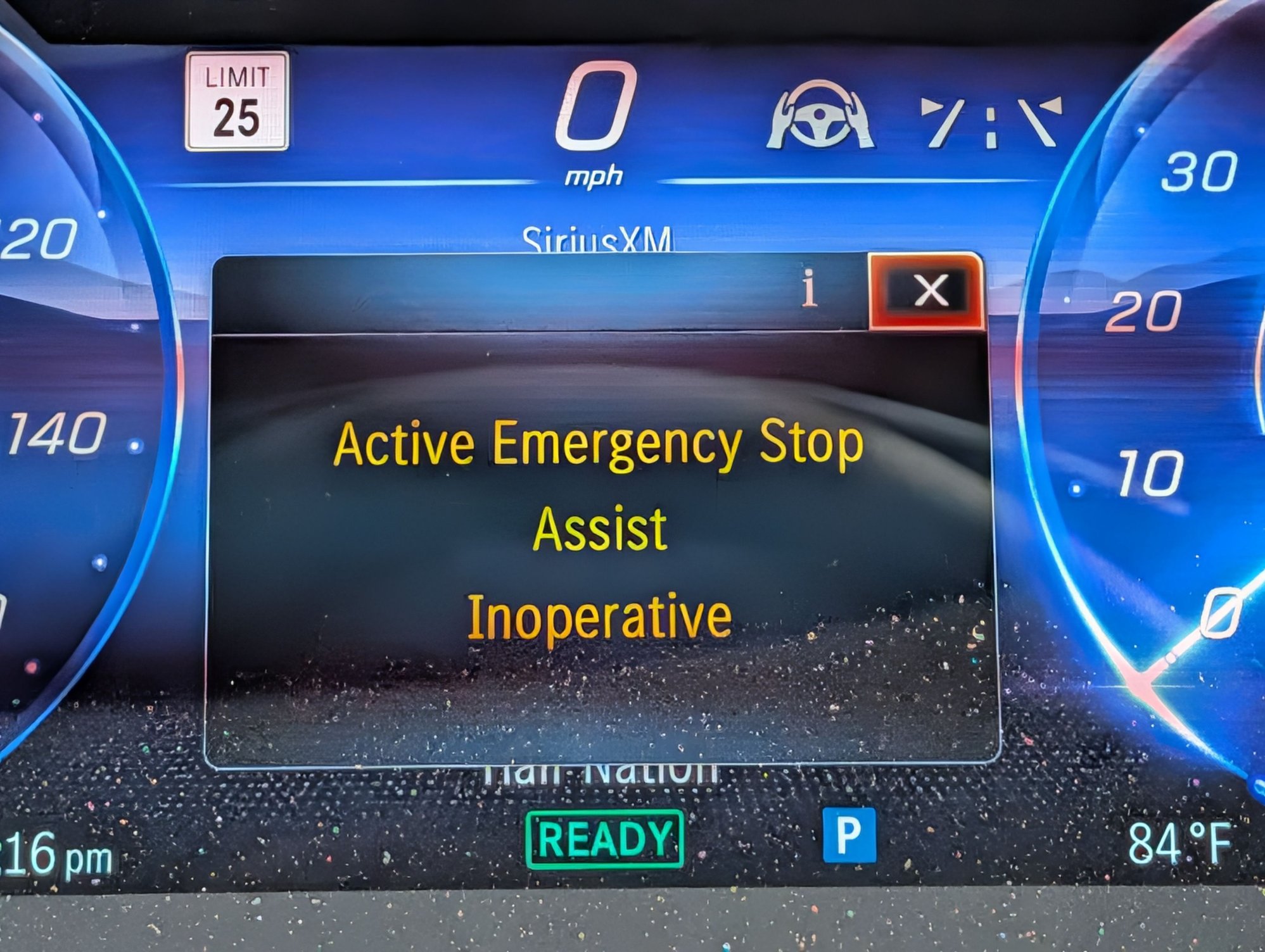

2024 EQE 500
I'm not sure if this is the same error, however I just had this resolved at my dealer. The resolution was replacing the steering wheel due to failed sensors.

The wheel itself has integral capacitance sensors to indicate if one is touching the wheel. There are integral thumb controls for various menu functions. If one of the sensors or controls stops working the wheel must be replaced.

Yes - but what I find amazing is that any of these sensors have anything to do with "Active emergency stop assist". Seems to me like that should be an entirely separate system!

I am wondering if it is because they communicate with the active emergency stop assist and engages it if it detects that the driver is not responding, paying attention.

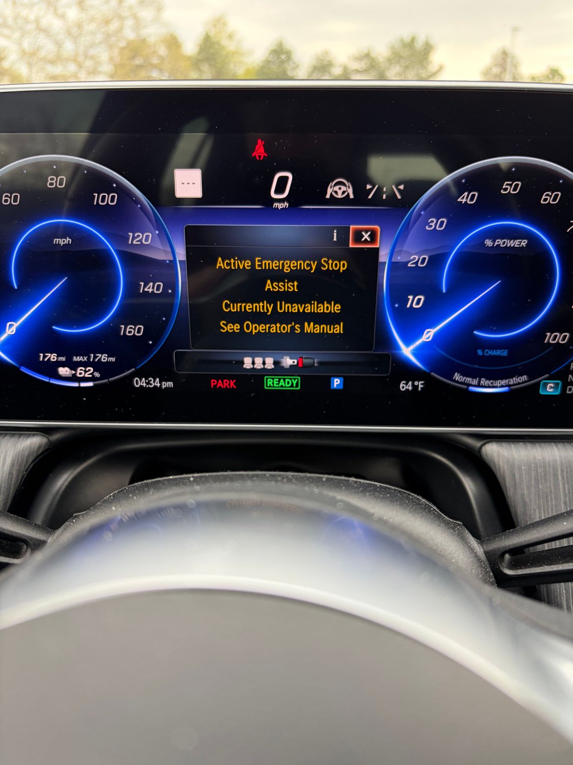

Originally Posted by stc1996
Rhese
The 2 I am getting as I turn on.
Thanks for sharing. Definitely needs to be checked with the dealer's SDS. Likely radar, camera, or other malfunction. We had an issue on my wife's EQE SUV where the ABS tone ring was rubbing against the hall effect sensor. Eventually, it produced an implausible reading, and all sorts of things disabled, including rear steering. It was a quick fix. Without more information from the car directly, it'll be impossible to diagnose, but should be easy to remedy.
