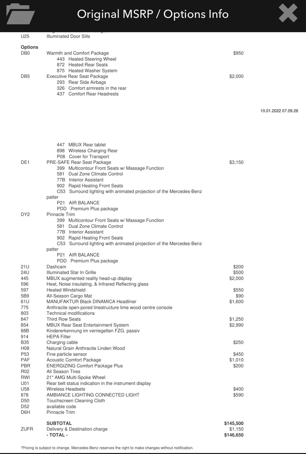

You can get the EQS 580 with just option 444. See attached for an example. Not sure if you were making a point that 445 is not available on the other models other than the 580?
Ah, I'm sorry if I was not clear. The 580 and other hyperscreen/3D guage cluster MBs generally have the option between 444 and 445. There are exeptions, as in the US the W223 S Class is not available with 444 like it is in other countries, and so far 3D guage but no hyperscreen EQE SUVs do not appear to be available with 445, but the three main US models, EQS580 Sedan, AMG EQS Sedan, and EQS580 SUV are all available with either. However, US models (and worldwide) with no 451 or Hyperscreen cannot be had with 445, only 444 is the maximum option. Hope that is a little more clear.
