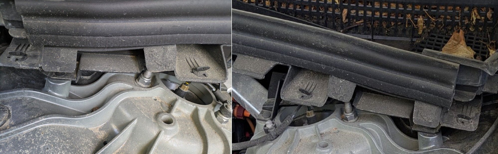

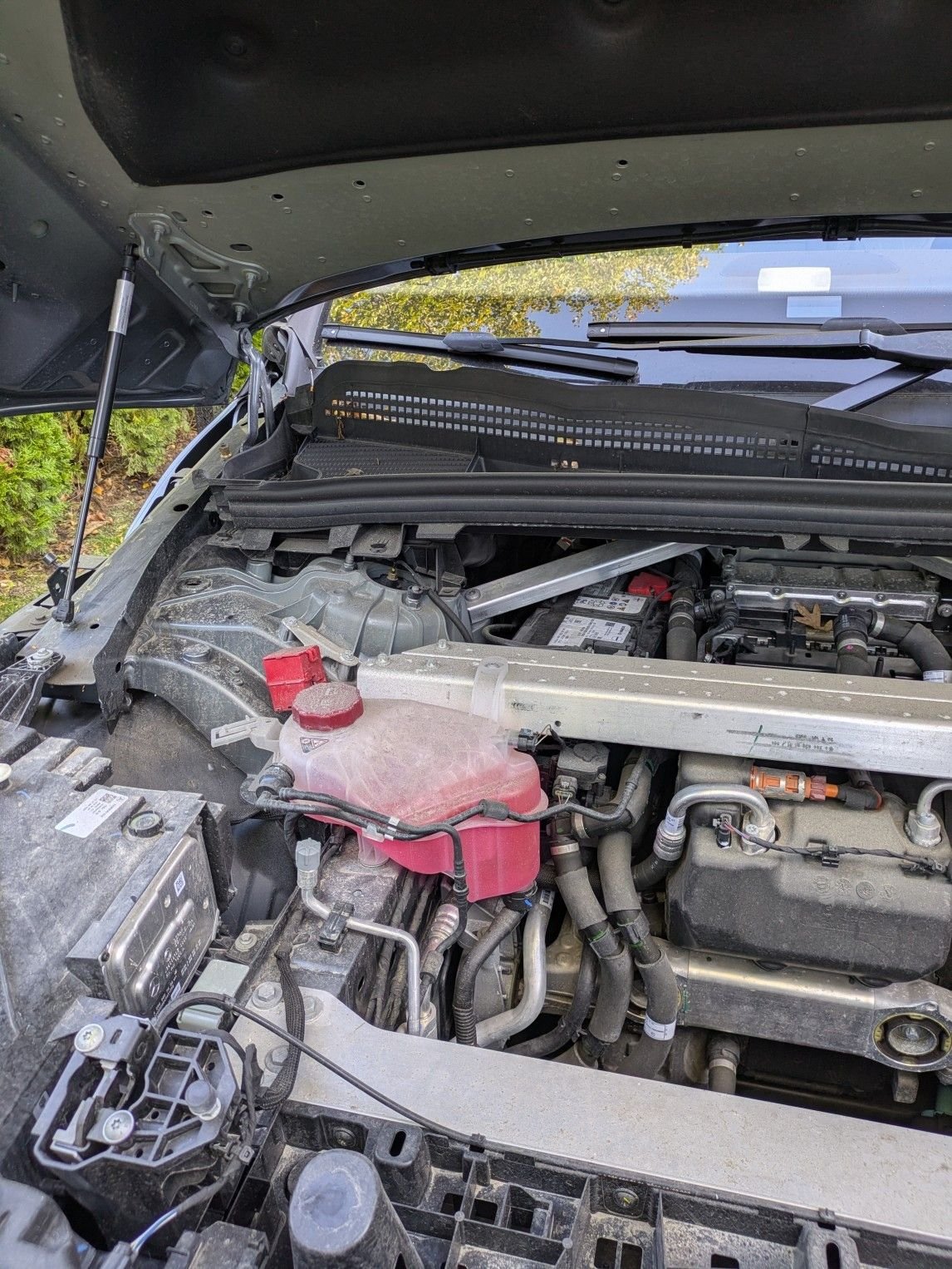

For those of us without the HEPA upgrade, access to the under-hood filter is a bit more complicated. Lazaru5's hood-strut mod is basically required to do this safely
Part numbers can be either 166-830-02-18 or 166-830-00-18 (Probably some others as well).
The filter is located under the hood near the passenger side:
First you have to unlock the cowl by turning these retainers 90-degrees; there's two on each side:
Then, you can gently lift the cowl and see the airbox:

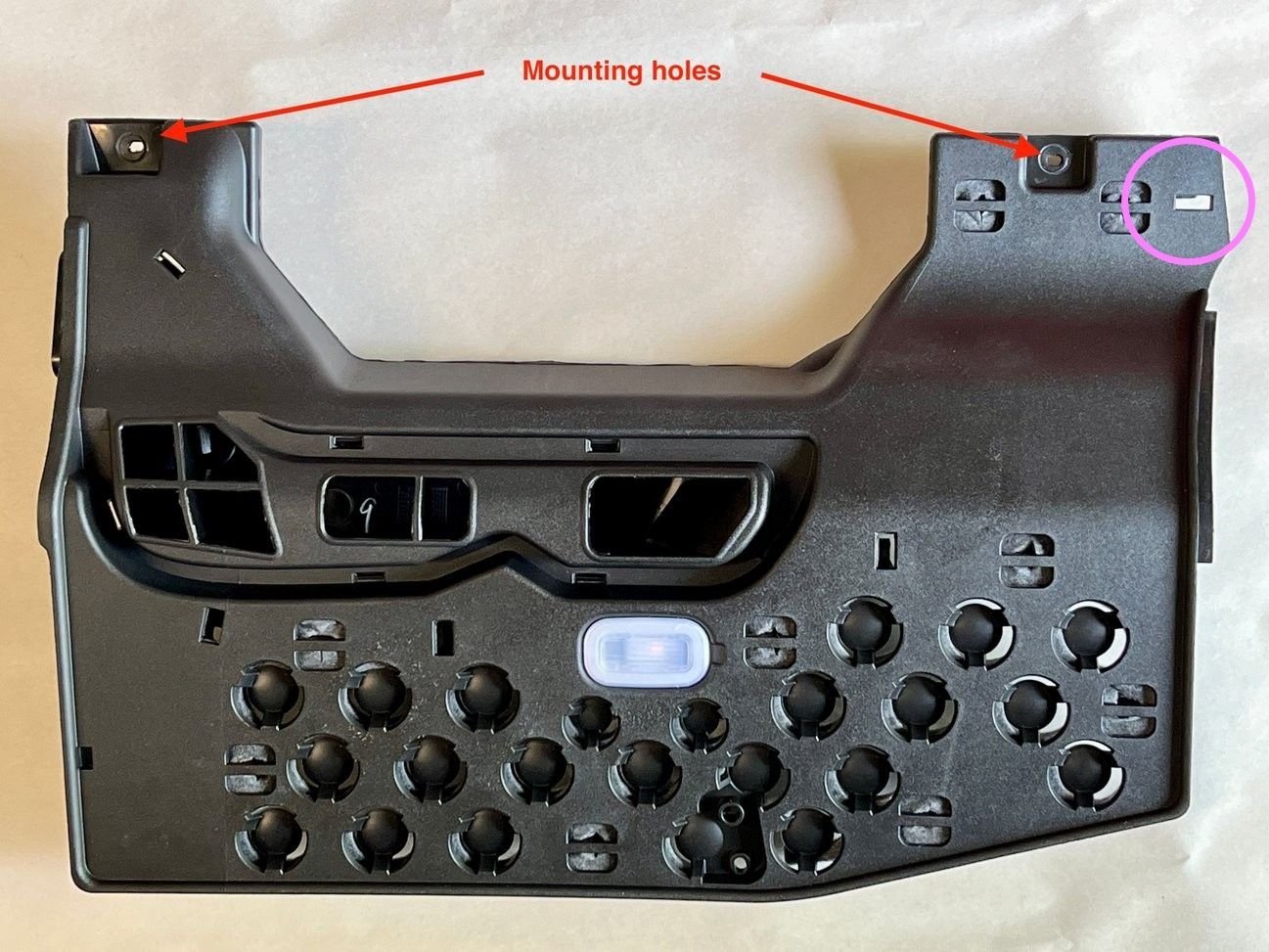

The in-cabin filter change is just as Lazaru5's instructions describe, but I'll add 1 detail:
For the access panel under the glove box, there is a slot next to the screw closest to the door. Inserting a larger flat-head screwdriver to disengage the retaining clip there makes removal a lot easier.
Pink circle
Pink circle
Tab to be released
Tab to be released
