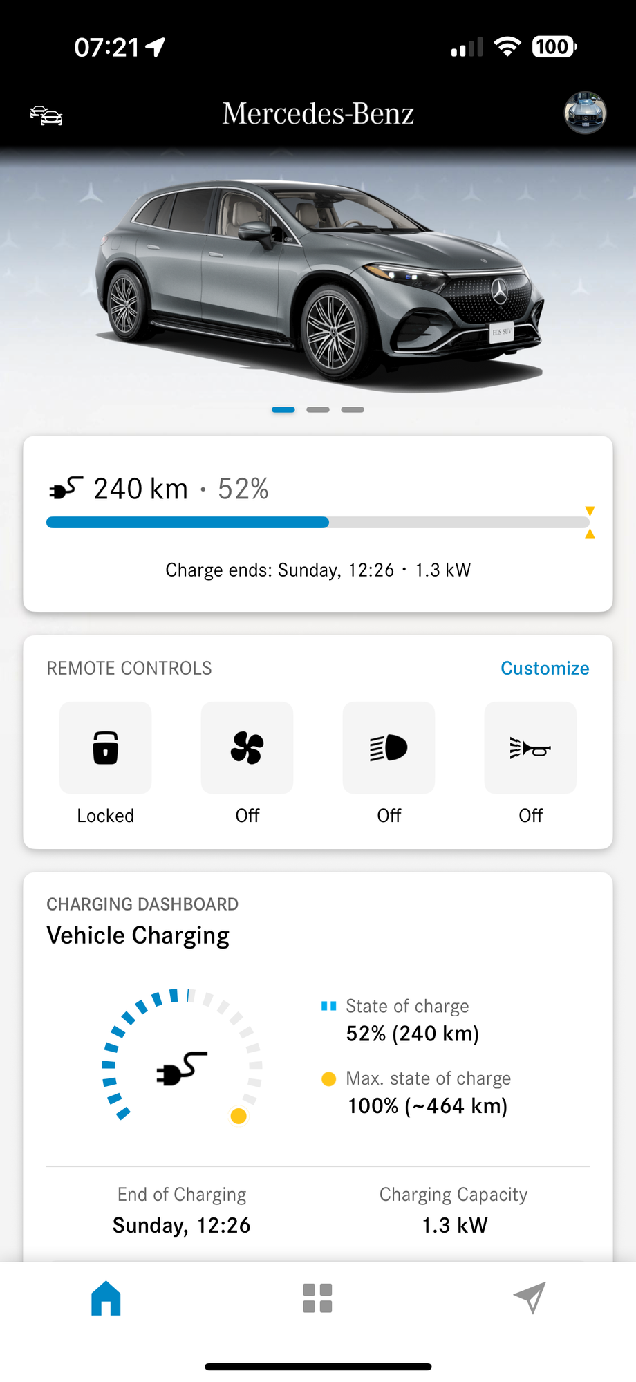

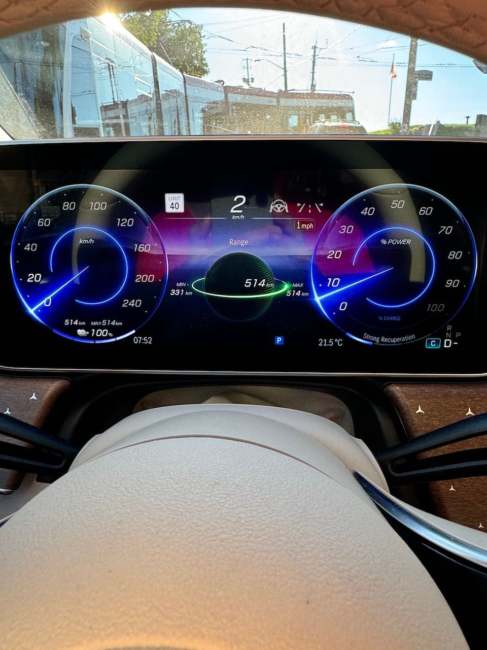

Disappointing to see a 10% range reduction after 10 months of ownership.
I have charged to 100% on fewer than 5 locations and most of the time it is slow charged on L1, which is better for the batteries.
514km was in summer with the stock tires, so maybe that’s it; but my driving style has not changed.
464km now / 514km 10 months ago, when 1 month old

The range is getting better. It’s really just the “guess-o-meter” range indicator which looks only backward. It does not take into account where you are driving, nor what drive mode you are in, which is disappointing. Is it different on a Tesla, for example?
If you enter a destination that requires a long highway drive, it should adjust range accordingly. It does not.
If you switch to Sport drive mode from Comfort or Eco, it does not adjust range.
The range is really only calculated by your past consumption.

No, it’s due to the historical consumption during winter, which is about 2X what it is in summer.
And due to the fact that the range estimator does not take the future into account. It does not take the navigation route into account at all, nor the drive mode, nor the climate or other settings. It simply looks backward at the historical consumption!
