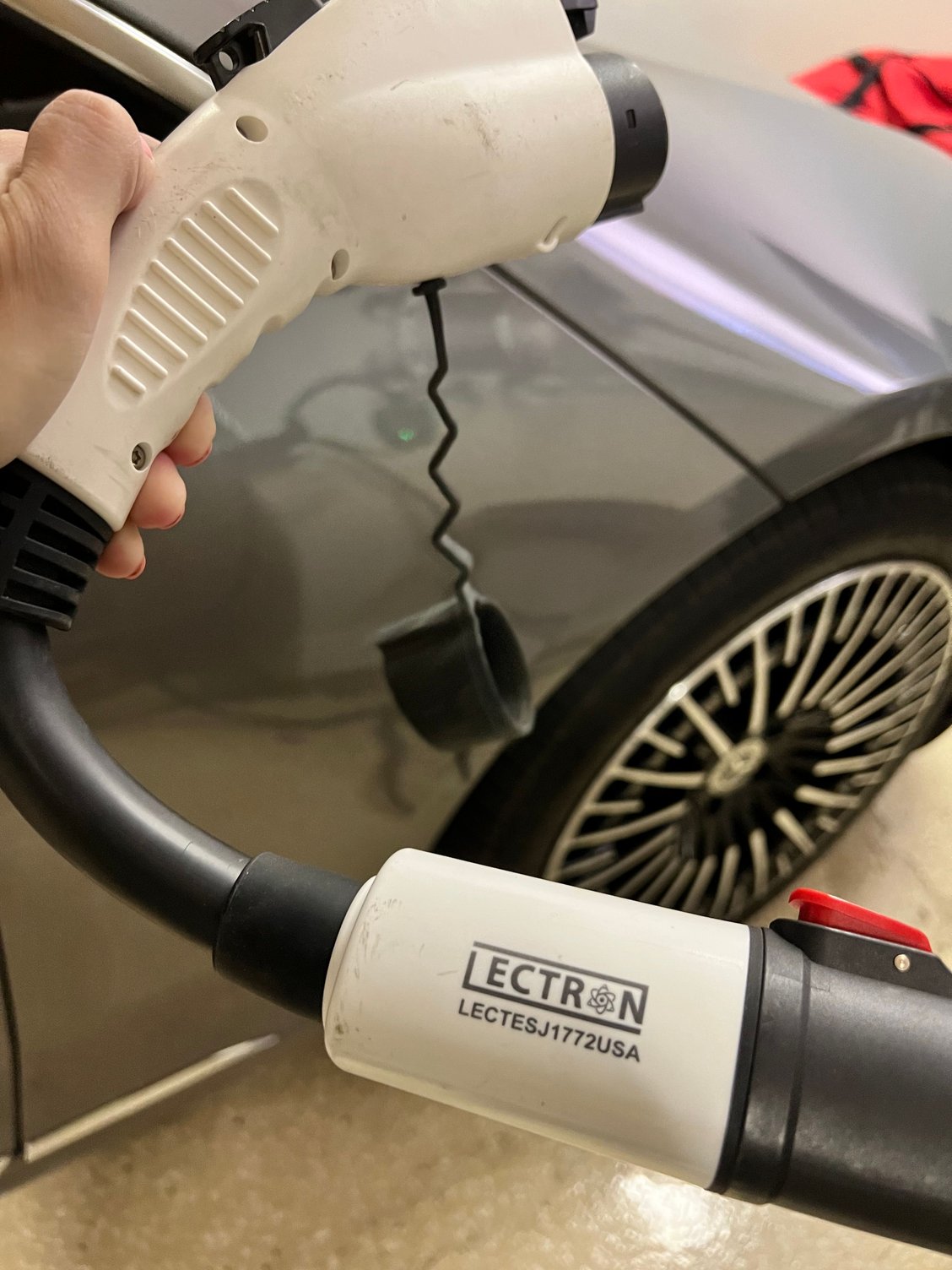

However, there is no reason it shouldnt it works with any J1772. Follow the simple instructions. If not done correctly it will not work with any car..

17 E43; 21 GLS580
Old Apr 29, 2022 | 06:59 PM
Elecfour's Avatar
Joined: Mar 2022
Posts: 31
Likes: 32
Eqs580
Yep. Looks like the same ! It’s the only way I charge my car is with this adapter. Again I only use it at home.
