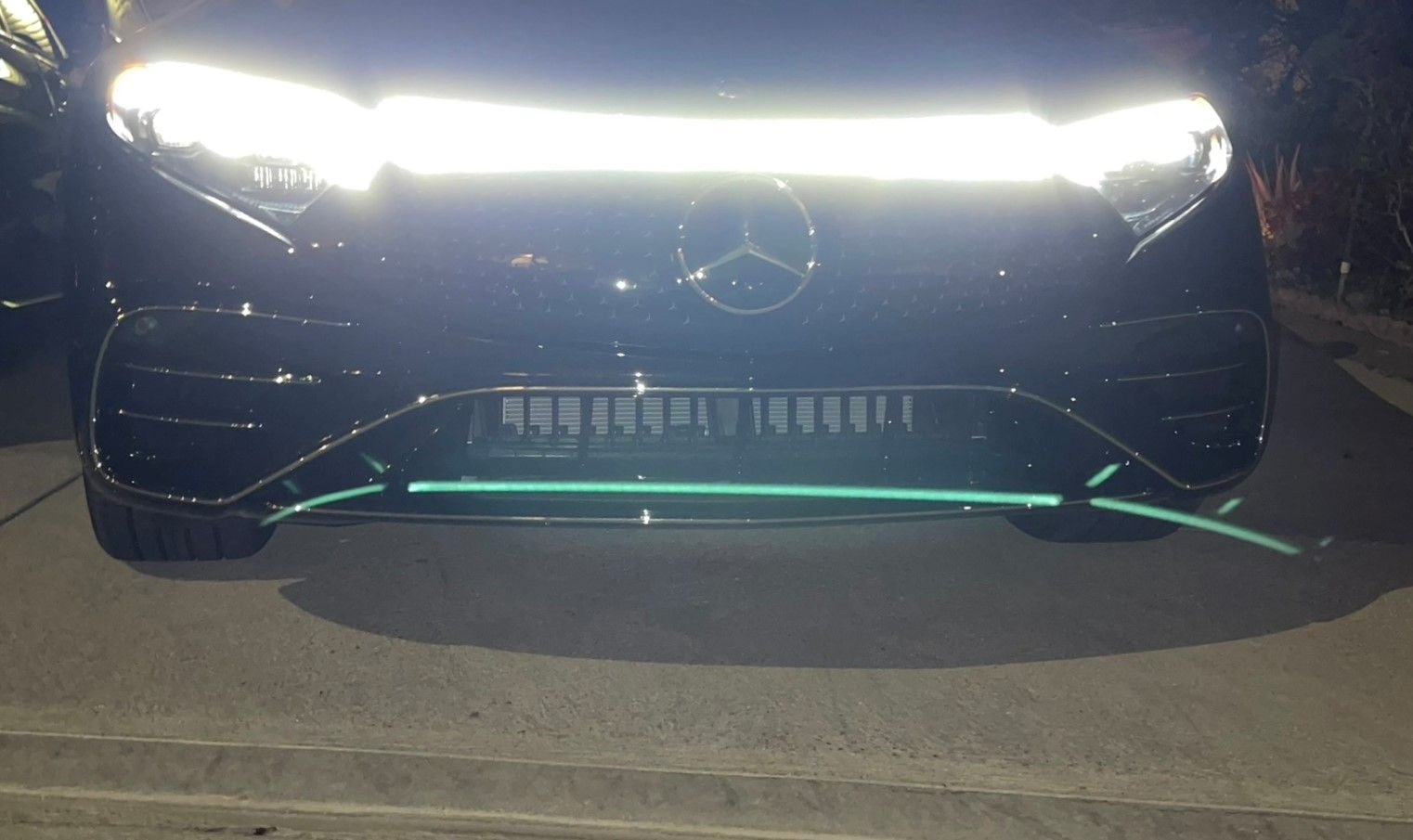

My EQS 580 sedan’s front scrapes the driveway when entering from the street or entering the street. It should automatically raise it but it is either not working or it is not enough. I put it in the comfort mode which is the highest. The sport and Eco is even lower. It will be also handy in snow.
the manual raising is available in other countries but not in US, like in the picture.

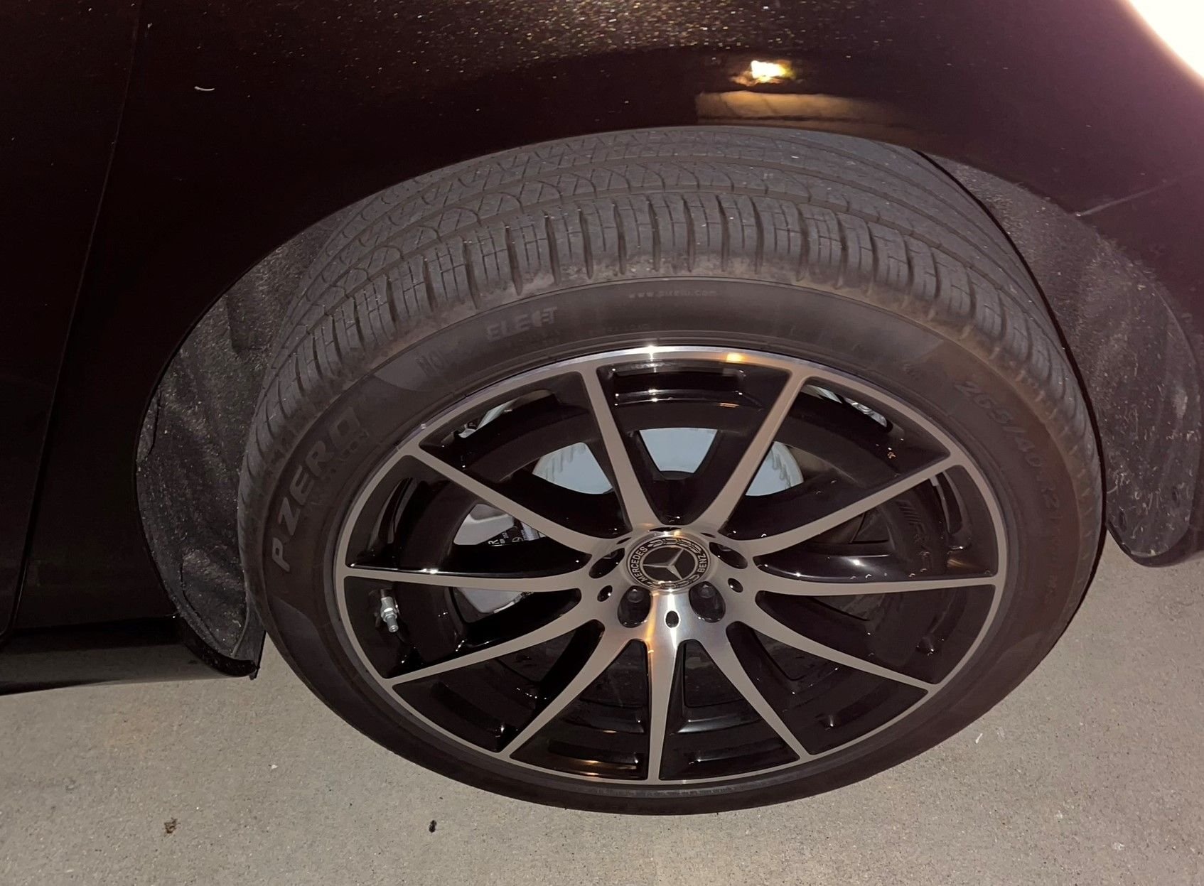

Transport mode worked as advertised. It took almost a minute to complete. It significantly raised the car and it will be very useful for me driving in frozen snow just in case.
It almost looks like SUV height right?

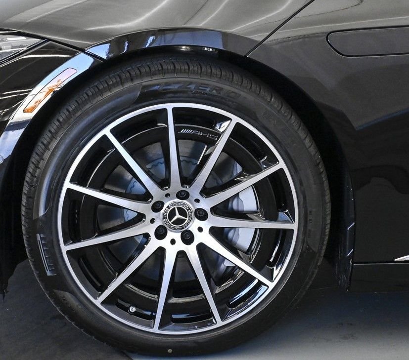

I am adding a before picture for comparison. It is taken in comfort mode which already is raised 15mm(0.6 inches) from economy and sport mode.
In Europe and other countries you can raise the body only 25 mm (1 inch). Transport mode looks a lot higher.
