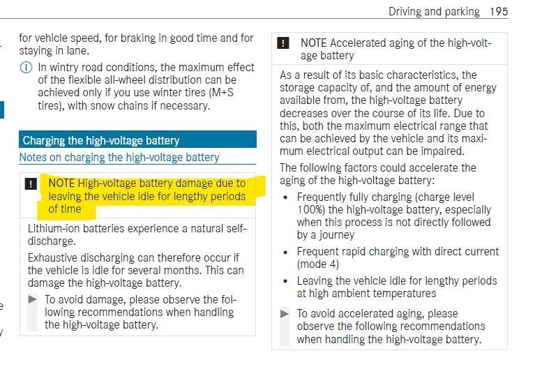

would you consider a EV that sitting on dealer about half year or almost a year
so early this mo I was shopping around. I saw many EQS AMGs that are 06 - 08/22
1st I was thinking oh I can push them for lots of discount.
but when I arrived to dealership, many of the EQS AMGs on their show room are dead with no power. not just AMG, many 580 sedan have date that is 08/22 09/22. basically that is about 9 mo sitting on the lot.
a question just popped up. EV are different than a gas car. gas car can sit there for 1-2 years without any issue but EV is different
HV battery can be low on 10% and overtime it will just drain. I dont believe dealer will check and charge it.
they might just charge it a day before someone come to check out the car.
the one AMG I really want, it is fully dead on their showroom. I been asking myself this, even if they sell it the price I ask, should I take it? maybe there will be a lot of problems I need to deal with later.

The dealer should be able to assess what the 100% capacity is. I would ask for that. On a Tesla you can pretty much do it sitting in the car. Don't know about an EQS.

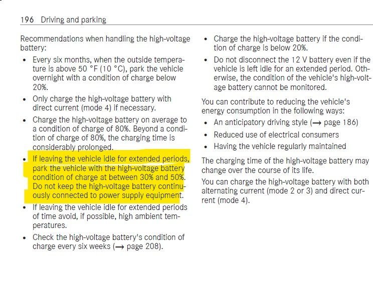

Just for grins and giggles tonight I was reading the legal terms of our 10 year / 155,000 mile high-voltage battery warranty. Look what's #1 on the list of things that will void it:
0% for 14 days voids the warranty
Unless you’re totally negligent it would be pretty tough to do that.
Define being negligent because a car sitting unattended for more that 2 weeks would not be considered negligent. At what point would a car that was properly charged for storage ie ~50% SOC reach 0%? I am assuming that you would say that the dealership in the OP is being totally negligent and it would appear that based on the post 17 they are likely violating the warranty.
You are right on the dealership being negligent.
What I meant is that it is not easy to run the battery down low enough and then have it be at 0% for 2 weeks. Even leaving a 50% charged EV for a couple months untouched is not enough to get it to 0%. It would have to be really a long extended period of time and the battery would have to be pretty low to start with.

Then this leads to whether the dealership(s) can even sell the cars if in fact they have violated the warranty.
Joke's on them, the warranty starts when the vehicle is placed into service. If they left it dead as new inventory, there is no warranty to void!
