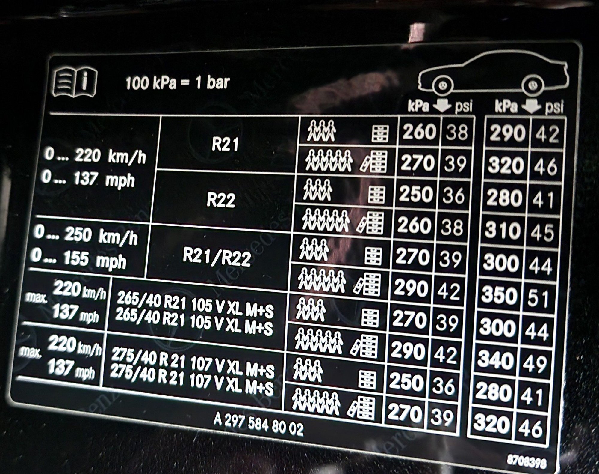

Old Sep 26, 2023 | 07:20 PM
woppenhe's Avatar
Joined: Oct 2016
Posts: 25
S 550 (2016)
Door placard does not show my tires, AMG EQS 275/35 R 22
Here is the tire chart on the door, but the tires on the car are 275/35R 22. So what pressures should I use for rear and front?
The size tires that came on my 2023 AMG EQS are not shown on the door placard as it says in the manual. What pressures are recommended for normal driving on this vehicle. All 4 tires are the same size on 22 inch rims.
Check the inside of your charging door. There should be a detailed sticker with all the pressures for various tires, load and speed scenarios. There's not a single proper tire pressure as the North American door placard makes you believe. The ideal tire pressure depends on the above factors.
Old Sep 26, 2023 | 07:52 PM
woppenhe's Avatar
Joined: Oct 2016
Posts: 25
S 550 (2016)
Nothing on the charging door, but I copied the information from the drivers' door pillar in my original post. The issue is that the tires that came with the car are not really iisted on the door A second placard on the door does list the tires, but for the fronts
Here is placard #2
suggests 42 PSI and then 51 for the rear. That sound pretty high; I htought I saw on the tire that the max psi was 50, but I will recheck. The dealer had the tirese delivered at 39 F and 47 R.
Old Sep 26, 2023 | 08:03 PM
superswiss's Avatar
Joined: Nov 2018
Posts: 11,472
Likes: 5,357
From: San Francisco Bay Area
2019 C63CS
Here is placard #2
The door placard only lists what's known as the max load recommended tire pressure. This pressure is technically only suitable with the vehicle loaded up to its gross weight and driven above a certain speed (100mph or 155mph). You want to find what's known as the normal load recommended tire pressure. To be honest, I'm not sure where they are sticking the tire pressure sticker on the EVs. Used to be inside of the fuel door, so I was assuming the logical place would be inside of the charging door. It looks something like below. This is from my C63S coupe, which as you can see has lots of different pressures for the various tire options, loads and speeds. Yours should have fewer pressures if you can find it.
Old Sep 26, 2023 | 08:39 PM
woppenhe's Avatar
Joined: Oct 2016
Posts: 25
S 550 (2016)
Thank you for looking. I hope that some other owners of the AMGEQS might respond with their experiences.
