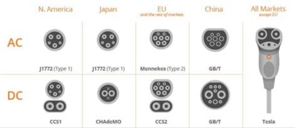

Is the current Tesla plug and NACS essentially the same?
To clarify, home chargers use J1772 (which is just the top portion of the full CCS connector). And you can already buy J1772 to Tesla and also Tesla to J1772 adapters which work with Tesla destination chargers to MBZ vehicles and for Tesla's to charge at non-Tesla L2 chargers. So for existing home chargers, if NACS and current Tesla is the same you can just get one of those existing adapter, but chances are MBZ will offer one also.

The current L2 adapter from the EQS to the Tesla destination chargers is AC. To adapt from our EQS to the Level 3 Tesla chargers is a different physical set up and DC. Someone correct me if I am wrong….

You are correct. I think the above discussion was about whether home chargers would have to be replaced when you buy a new MB EV in a couple of years.
