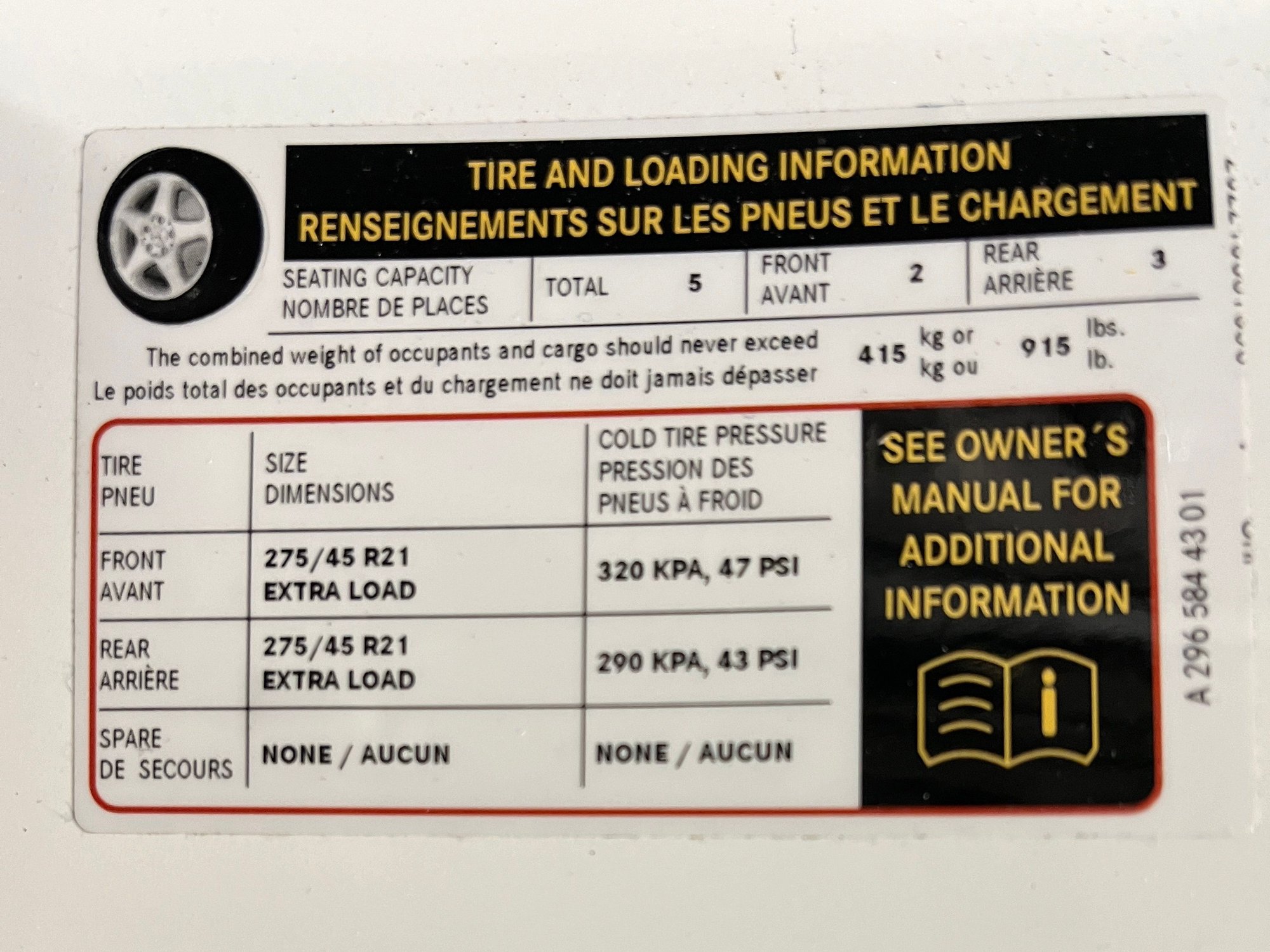

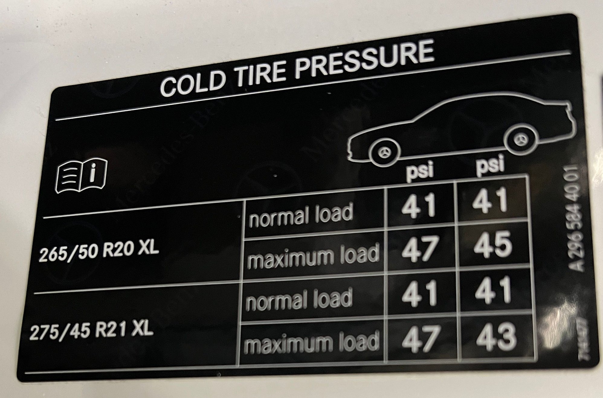

My EQS SUV has two tire pressure labels. One only shows the size for the factory equipped tire size, 275/45-R21. The second label also includes the optional 265/50-R20 tire size. Neither label includes the tire sizes for the SUVs with staggered wheels.
