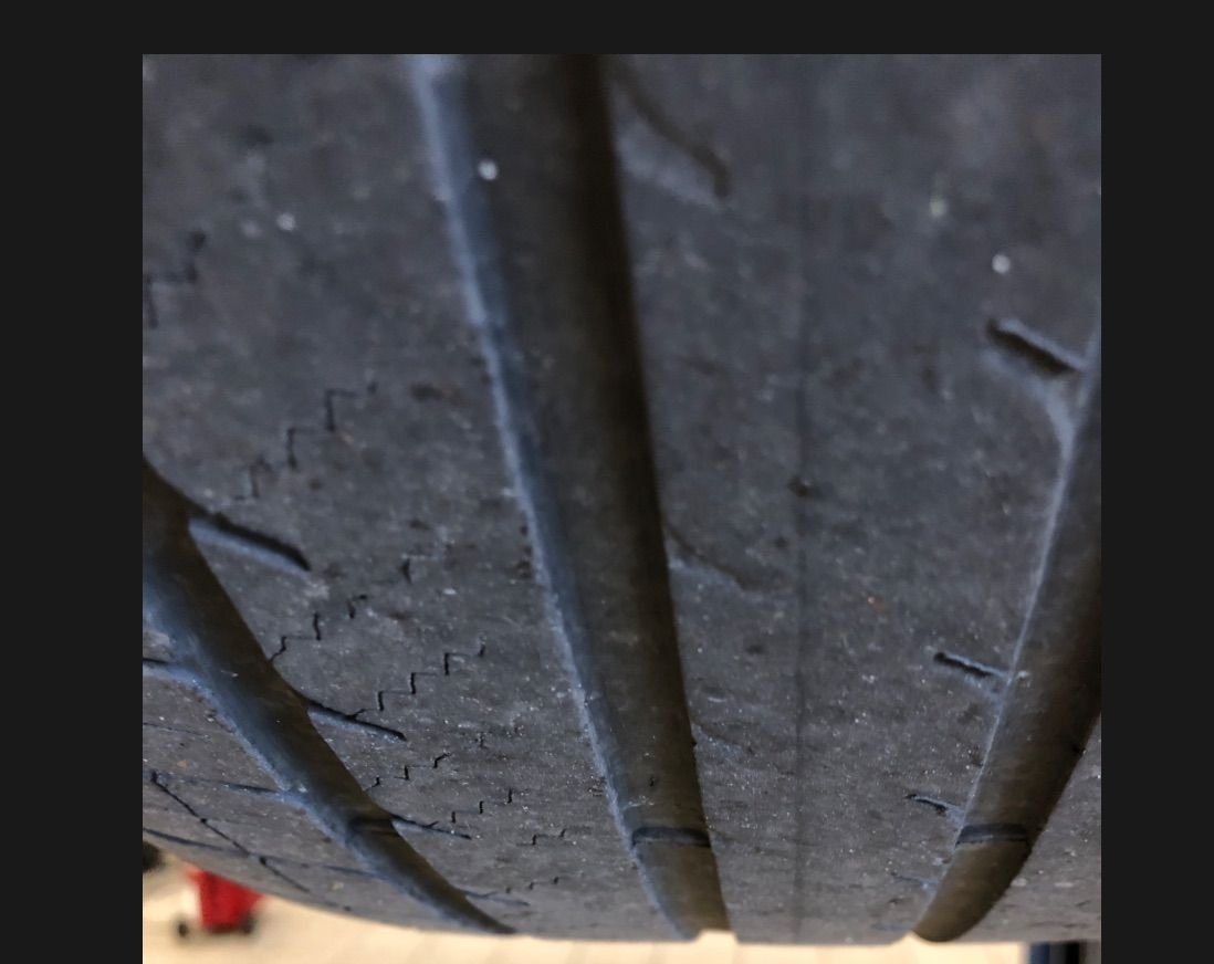

Tire Dealer recommends be replaced.
Originally Posted by ihatemyeqs450
I have a 2023 EQS 450. I had to replace all 4 tires at 7,000 miles. That’s a $2,000 on a brand new super low mileage car. MB never acknowledged my complaint. Has this happened to others? Mercedes is selling these very heavy cars with the bottom of the line goodyear tires. Tire Threads gone after 10 months of use!
I had a similar experience but got a few more miles out of my first set of 4 - around 9000 miles in 2 years. The second set are more problematic.
I replaced all four tires at ~9000 miles and 2 years with the same “Run Flat” factory tires that came with the vehicle - Bridgestone RFT Turanzas. I bought the tires in Nov. 2024 from the local Reno, NV dealership. We took the car in for a check up 8 months later in June, 2025 with ~13300 (4300 miles later) and by text were told we “needed new tires”. I checked them. We need 1 new tire. The right rear tire was nearly bald. The left rear still has tread yet nowhere near bald. It also has more wear that the 2 front tires.
This morning, July 17, 2025, I stopped by the dealership to speak with “Quannie” the service manager.
First - the recommendation to buy new tires was a little misleading. Quannie checked the service records which clearly showed 2 of the four tires are fine, 1 is “yellow” or in the cautionary area and 1 is in the “red” meaning it needs replacement. Maybe I misunderstood and the tech meant to write, “you should change 2 of the tires and not all.” I’ll give him the benefit of the doubt.
Second - Regarding the early wear on 2 of my new tires -
Quannie told me all electric cars are heavy and go through tires. That didn’t explain the difference between my first set and second, new set. I asked him about it and he told me it could be a result of a tire manufacturing issue which is not warranteed. That seems a little to convenient and, if correct, a bummer..
He said it could be a difference in driving habits - fast starts and stops. That doesn’t make sense to me because I am 64 years old and haven’t changed my driving habits. They are habits.
Quannie suggested it might be due to more city driving. That also doesn’t make sense because the first set of tires only went on one trip which was well within 1 battery charge. In other words - mostly city driving. On the second set and possibly faulty tires, 1000 of the 4300 miles were a round trip to Southern California which means MORE highway driving and presumably LESS wear.
Another possible factor might be misalignment. Upon checking the service records from last November, the wheels had been aligned. Couldn’t be that unless the job was performed poorly - we don’t take this car 4 wheeling.
At $500-$600 a tire I thought it would be worth investigating. So far, I haven’t come up with anything to explain the difference between my first and second sets of tires. Whatever the reason, tire wear is a common issue with electric cars. I didn’t buy the car to save the environment but all those extra worn out tires can’t help it.
Dealer recommends replacement.
Last edited by 2023 EQS450; Jul 17, 2025 at 04:13 PM. Reason: Adding a picture provided by dealer of “tire requiring replacement”

Invest in an easy to use and read tire tread depth gauge like this one --
Amazon Amazon
(less than $20). Avoid surprises and keep your dealer honest.

Based on the trend (and tread), it seems i should rotate every 1000 miles to keep them even. I would think at 4300, there should be no bald tires.
