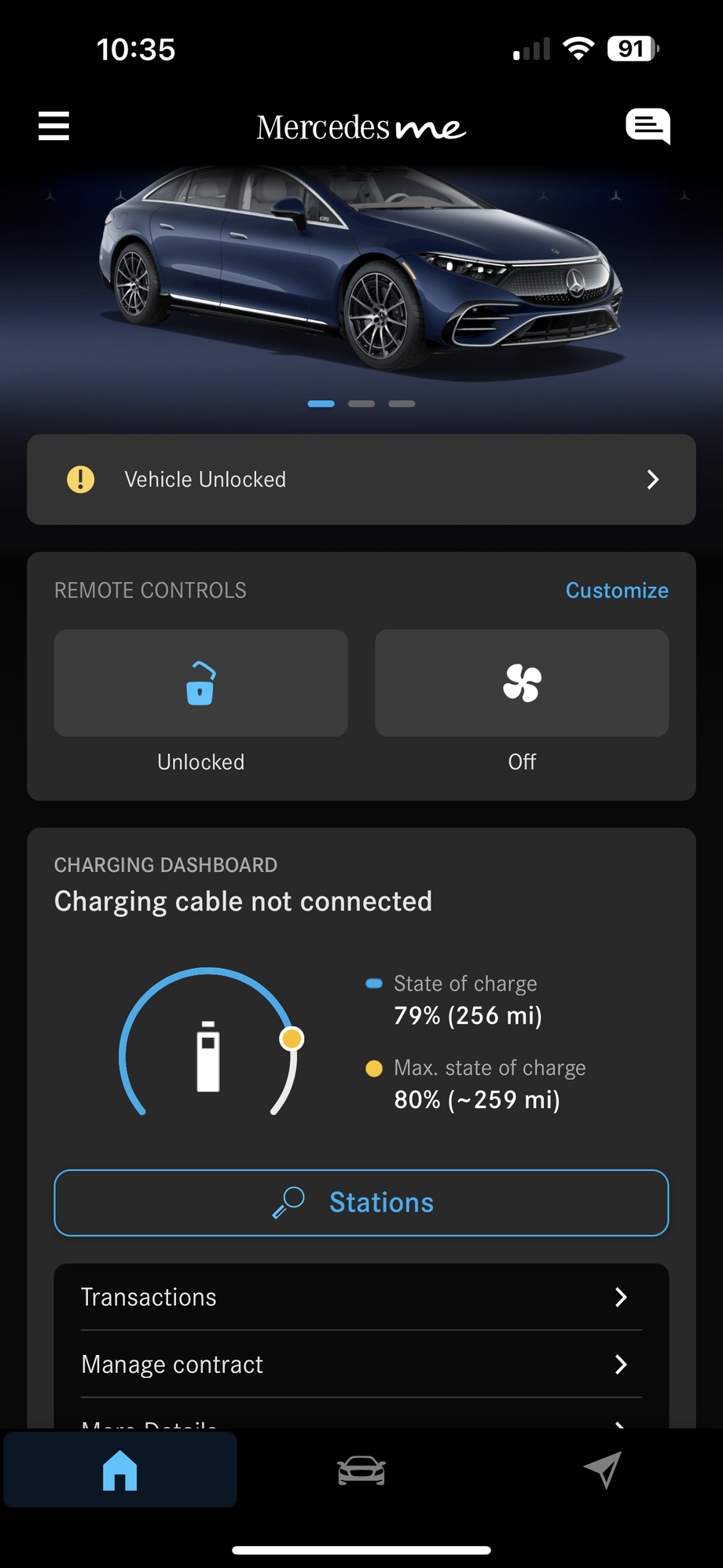

Hello all and hope everyone is well. This question is primarily for EQS owners of 2+ years. As the title says, I went for from a 80% charge = 330-340 miles to now 253-255 miles. I have been noticing this for the last month that the range has declined precipitously. I have had the car for 2 years and driving habits haven't changed. This time of year in NJ, temperature is also not a factor and the only change is a new set of tires (Bridgestone instead of Michelins) about a month back. What gives?

TIre pressure is what's recommended (I check and adjust every 2-3 mos). Below is a picture of the tires I put on and seem like that might be the culprit as that's the only thing that changed in the last 3 months. Tires are Bridgeston Alenza AS Ultra (35lb each), though I will say that the ride has been very smooth.
Thanks all who took the time and answered.
