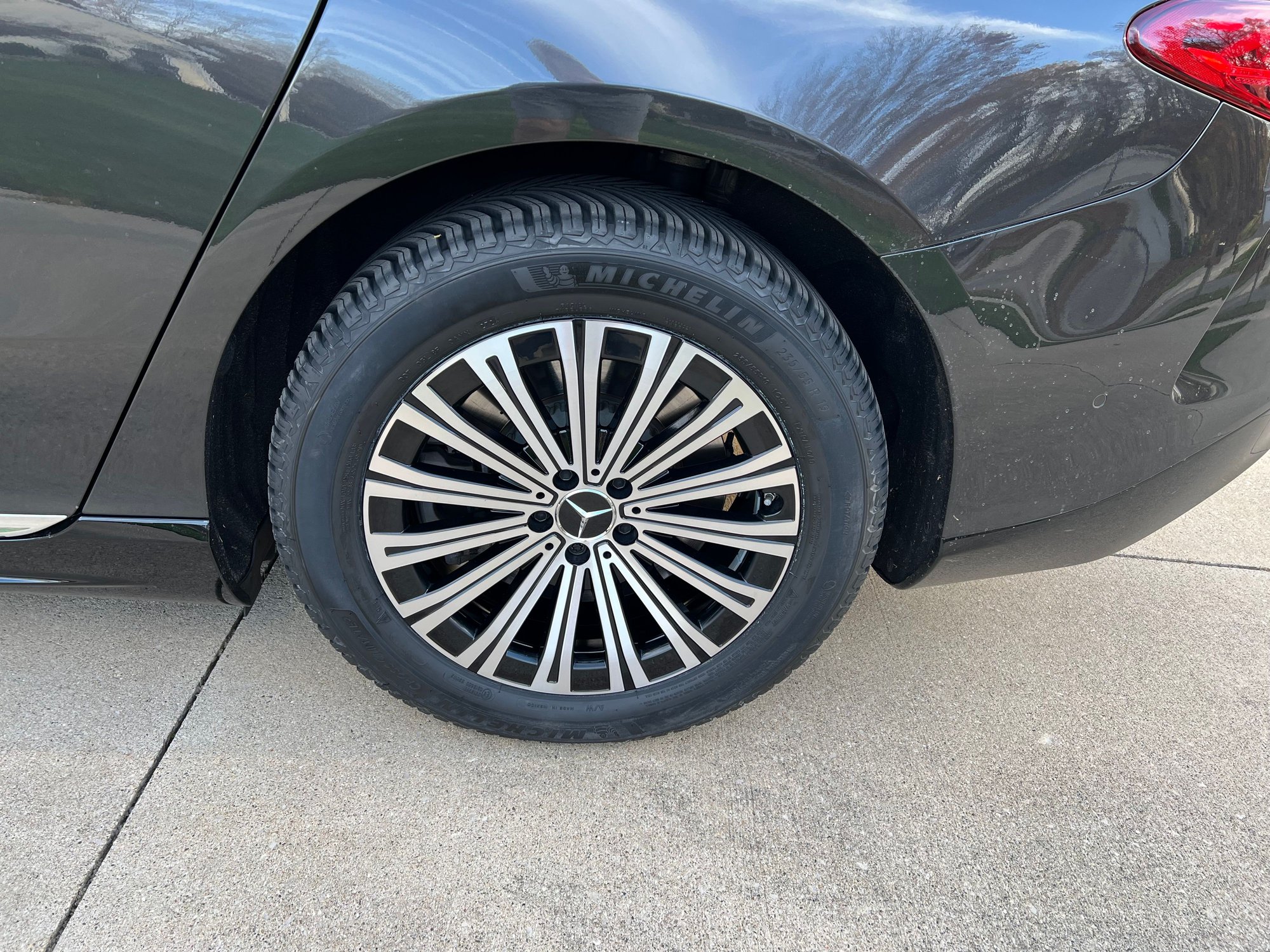

Old Oct 21, 2024 | 10:28 AM
c4004matic's Avatar
Joined: Oct 2014
Posts: 4,524
Likes: 1,181
From: WI
17 E43; 21 GLS580
Pics...

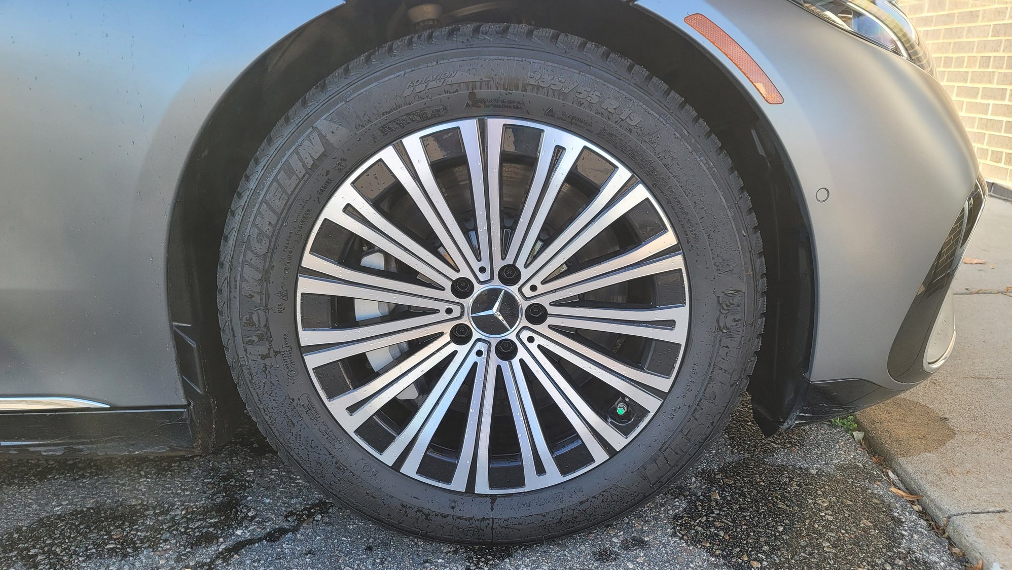

Old Nov 7, 2024 | 09:09 PM
dmstl's Avatar
Joined: Nov 2018
Posts: 63
Likes: 26
2023 EQS 580 Sedan
Originally Posted by c4004matic
Pics...
Inexpensive OEM takeoff rims are hard to find here but believe these 19” may be standard equipment in Europe. GM threw them in for “free” to encourage me to buy his last EQS580 with summer tires. Added 235/55/19 105V Michelin CrossClimate2 since our winters aren’t that bad anymore. So far so good, and much softer ride quality than AMG 21” Goodyear summer tires. Mileage dropped a good bit (50-60 miles @ 80% vs July/August) but it’s now in the 50s here and probably due more to colder temps than increased rolling resistance.

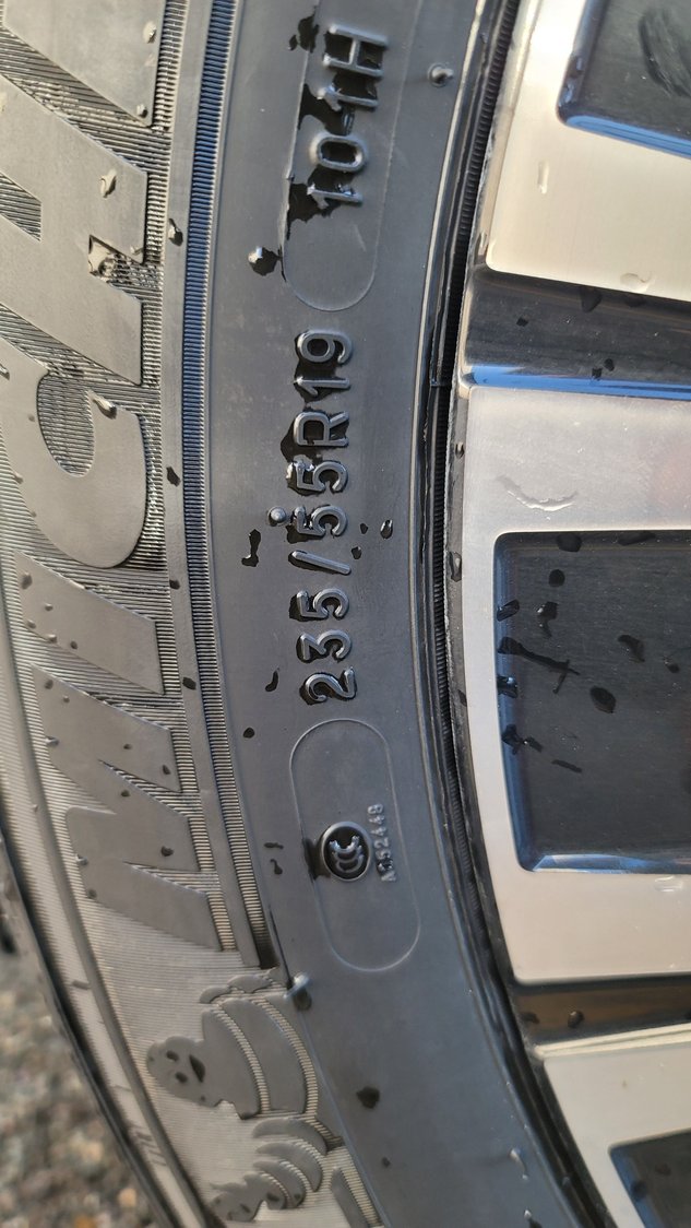

Old Nov 8, 2024 | 09:52 PM
ILoveNY's Avatar
Joined: Aug 2022
Posts: 792
Likes: 86
GLC EQB GLS C300 convertible
Pics...
My GLC has 235 55 R19, so EQS and GLC they use the same tires?
