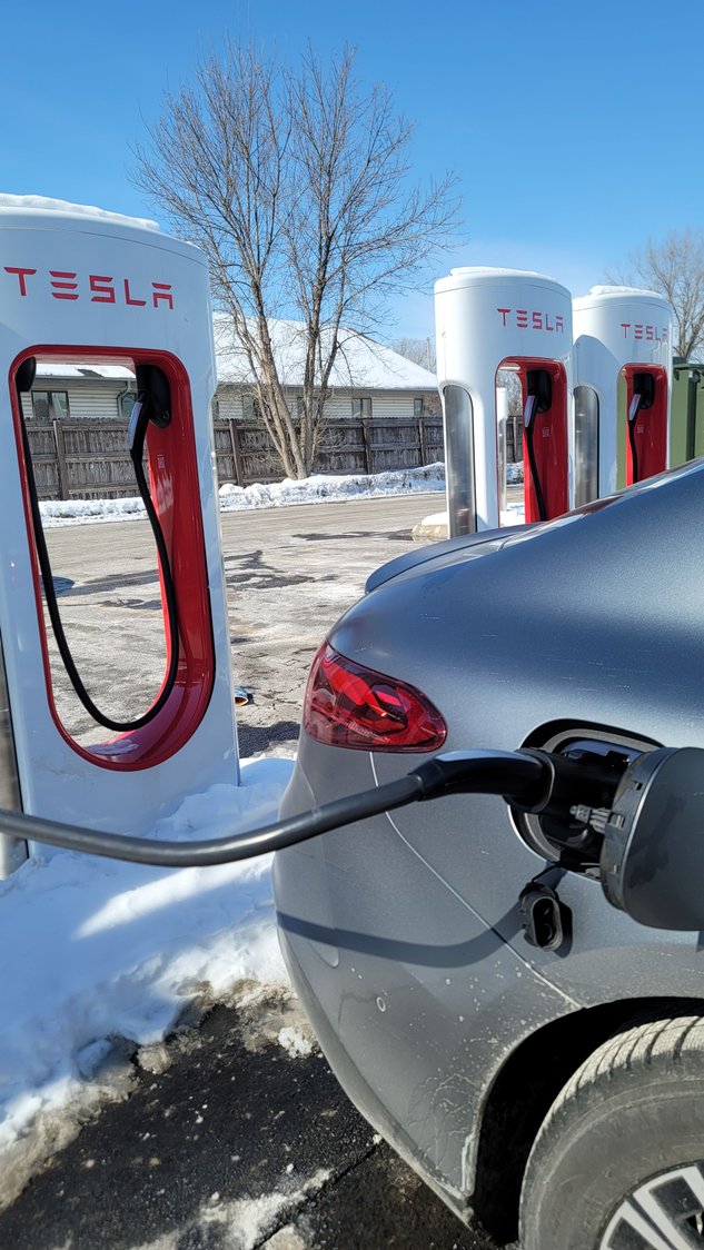

Finally! Used my previously purchased lectron adapter. Works like a charm through the Tesla app.

It also shows up on the MB App. I donxt know if the MBUX system will now guide to them though....I activated the routing function after I was alreay charging...

It shows on the car's MBUX andvwill navigate to them too! Woohoo after 3 years no more range anxiety or complicated route planning EVER AGAIN. 🥳🥳🥳🥳

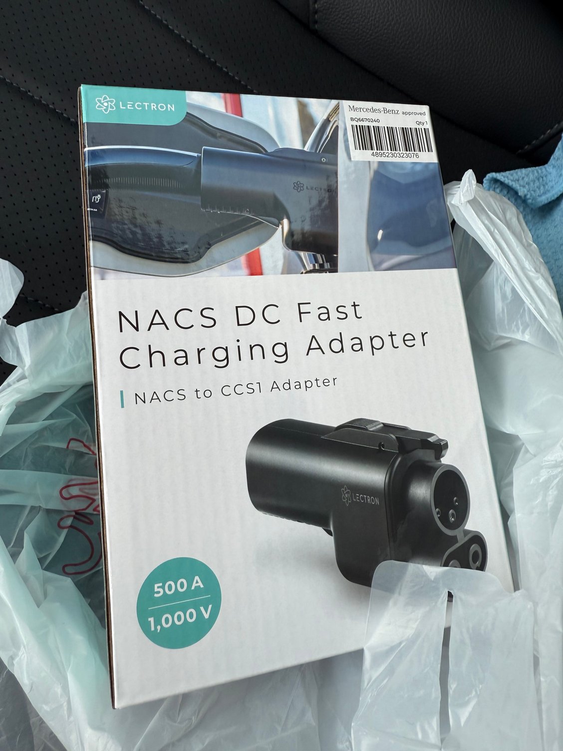

grabbed it at my local dealership in the LA metro area. It felt like the two parts folks thought about tacking on some markup but they went with $185.
