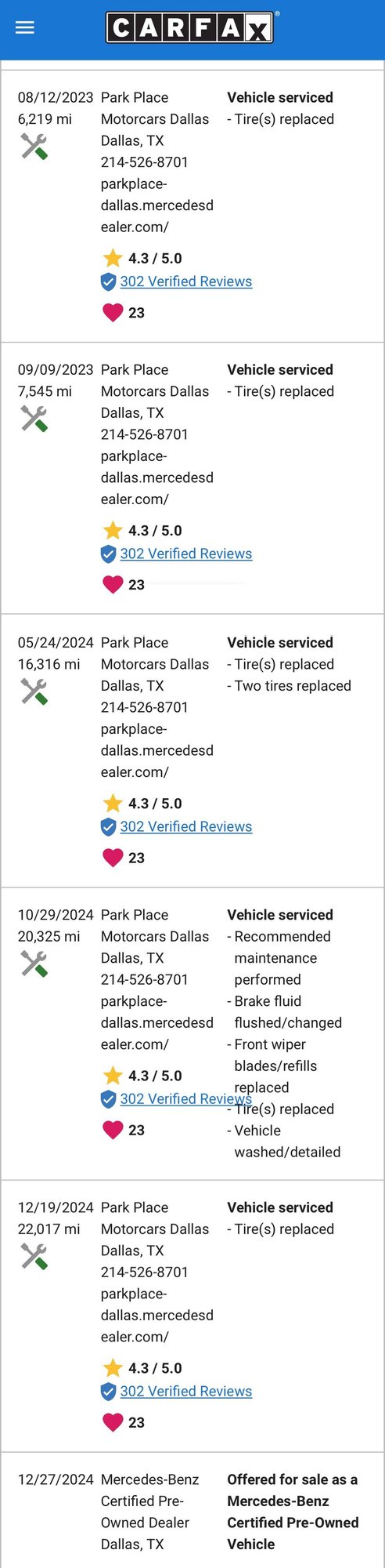

Very curious CarFax - TIRES!
Does anyone have any idea what this could be about? That’s a lot of tires being replaced!
Another one that did not make it into my scrollshot:

Maybe the service manager thought tire rotation is the same as replacing the tires (?).

In my experience these tires are wide and they catch alot of punctures and these tires are often not repairable.
For OEM Goodyear F1's the tires seems to last about 15K to 20K miles max.
You can opt for Hankook tires that are cheaper but equally performing. I heard they last about 25 to 30K miles.

You're luck to get 13K on the Michelin EV on the AMG EQS. The negative camber balded all 4 tires on mine.
Is that what MB ships on the car?
Why is there a negative camber and is that something that can be fixed?

I had Goodyear F1 Asymmetric (model 5) tires on my EQS for the three years I drove it, for a total of just over 33,000 miles. They were fantastic, and had plenty of tread life left when Carvana picked it up. I had 21 inch wheels. I found the car to be very easy on tires. That aritcle found on the internet, in my opinion, is troll bait.

The AMG I have comes with 21". The negative camber is from factory preset to allow the car to corner with more stability. Most sport car and sports sedan have aggressive negative camber. You can set it to whatever you want for alignment. On my BMWs (2 sport sedans), Continental tires fair better than Michelin or Goodyear. That's just my experience, though.
